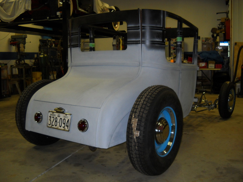

    Thanx, progress is a little slow with a sick wife but I took the body off the frame today and tilted it up on the firewall so I can paint underneath and finish welding the frame while the body is at my buddy's place getting the metal work straightened out where we chopped the top. I think he'll paint it for me too while it's there.

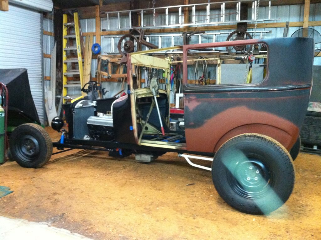

    ImageUploadedByTJJ1357780405.233875.jpg ImageUploadedByTJJ1357780446.943379.jpg ImageUploadedByTJJ1357780477.061792.jpg ImageUploadedByTJJ1357780532.163033.jpg

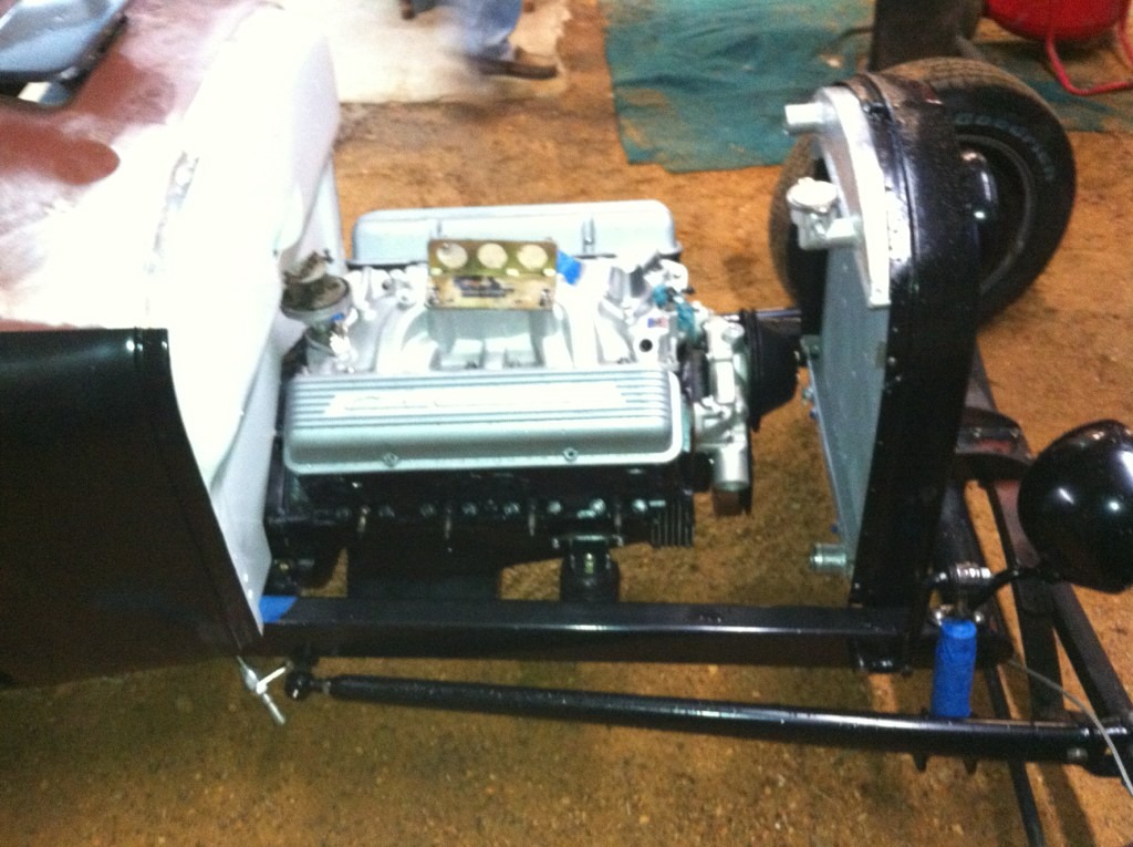

    Thats one cool Sedan,any info on it ?Story and more pics, LOTS of pics !!!!! JW :)

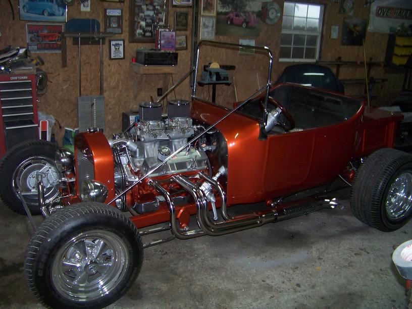

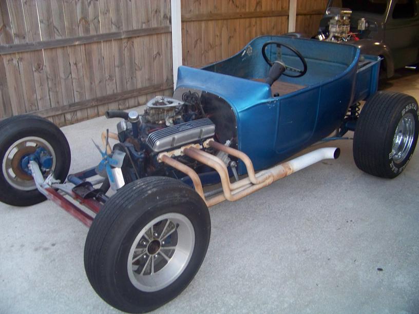

    I'm in the middle of building this one..
  17. Man I wish we were in the middle like that. That's one slick little ride man. Have you used an air cooled power glide behind a 2X4 equipped small block before? I'm not criticizing, just wondering about longevity. Logic tells me in such a light car it might just live. I know PG's have been used in T's since the dawn of automatic transmissions. I'm just wondering if it'll throw off enough heat.
    And to Mikes27T above; you may get some flack here but, trad rod or not I like where you're headed with it. Looks like you're building a nice clean little driver there.

    Thanks..
    It's not air cooled.. I think someone cut them holes a long time before my friend bought it.. I'm building it for him.. It doesn't have a air cool converter,, I will be putting a cooler on it..

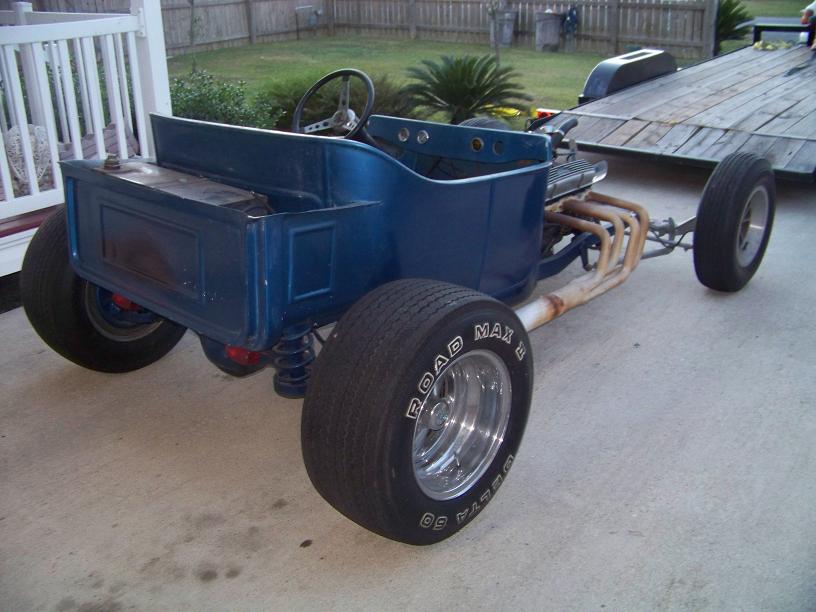

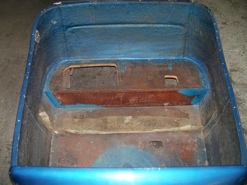

    Here's a few shot's of it before I started on it..:eek:

    no limits, you are doing a top job ,reminds me of those old show Ts.VERY cool!!JW :)

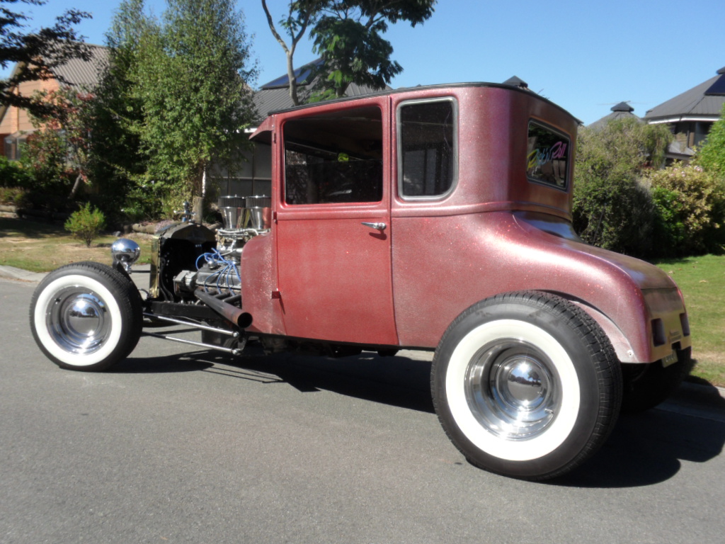

    Heres our much unloved T coupe.Its now gone to a new home where it can be appreciated.
    We got it as a 70s refugee - tyres 5 inches out past the rear guards, huge rake, real cartoon stuff, but outasight man. I loved the cartoon look.
    To get it legal down here we had to lose the guards as our guard exemptions are for no guards, and not tyres sticking out from them. So we lowered the back & fitted the chromies and whitewalls from another project thats struggling to make any progress.
    Then I didnt much like it anymore and I spent hours looking at the Condor T Coupe (seriously awesome) trying to decide if I would have to chop my one up and start again.
    Fortunately, somebody saw potential, and bought it recently, leaving behind the 289 and the rims & tyres for me to use again.
    Hes enjoying it now with his 351w and some other rims.

    Todd, i dont remember that one from back then,who had/built it then???I love the stance and overall balance and with out having a chop !!!!! Nice !!!!!! JW :) PS; is an import?

    No, it was built back in the mid 70s by a dude named Trevor Candler, who was a member of North Shore R&CC.
    The car is tupperware and was the third one out of the mold, and the first one completed as a coupe as Im told the fibregl*** guy took a while to do the doors so the first two cars became roadsters.
    The cars moment of fame was a show in Auckland (possibly the Aotea one) where Trevor had it in the unfinished cl*** and to get more attention, he hired a local lady of the night to stand beside the car in some lingerie.
    Trevor went to the States in the 90s and never shifted home. I think he restores Corvettes in California now. I will try to find a pikky of the car with guards on it. Rear end was a "Corvette-ised Ford Dark 4 Zed car rear end.

    I know it now, it was at shows in an unfinished form,it was built around '83.It had 221 and c4 (NZ Street Rodder,July 83,The old Lloyd Wilson mag) .Always wondered what happened to it. Cheers, JW :)

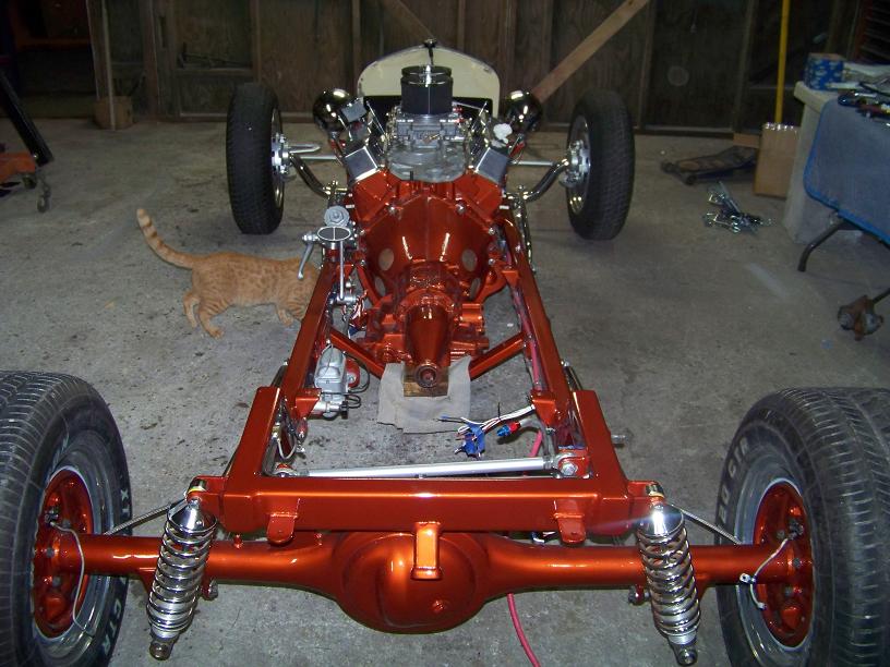

    Thanks.. It is coming out nice..;)
    Here's a shot outside today..

    Its fantastic,perfect balance etc.JW :)

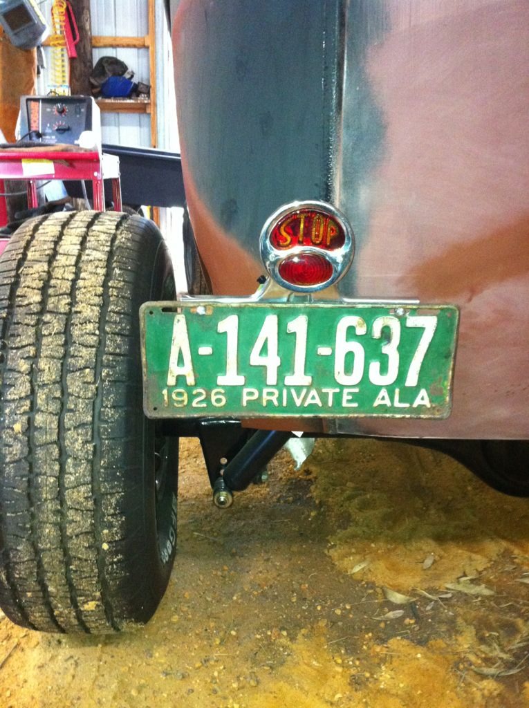

    Hey thanks J.W.!its a new build mostly just a 67 /283 power pack and a junk yard 9" with a 2x4 frame I built myself.i plan on running the 26' tag.the top has been chopped 3 1/2".those are all the pics I have right now.-Brice.

    Thanks Brice,i have a thing for 283s and IMO you have a perfect chop amount as now the body has good balance.I think it already has the look,very cool. JW :)
