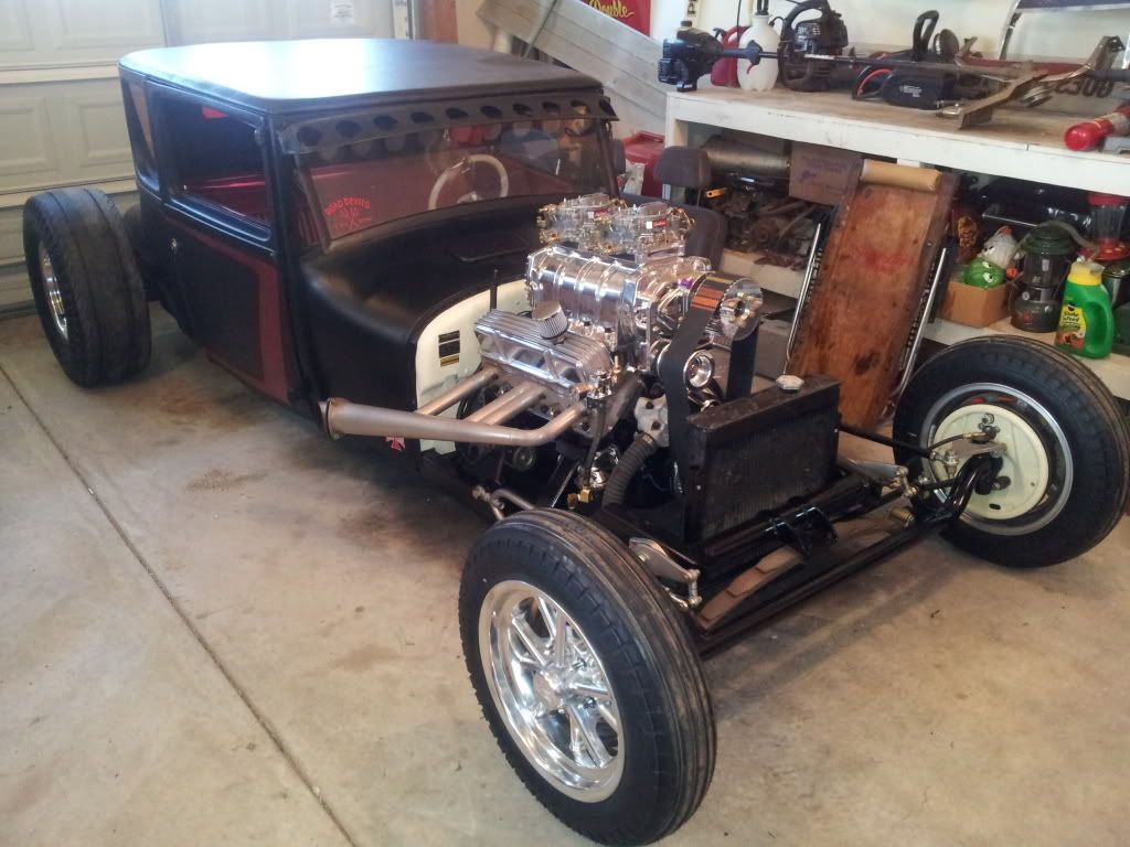

    Inching ever closer to getting it back on the road

    DaddyO do you have any problrm cooling that motor with that small of a radiator?

    It's a 65 mustang V8 radiator, I just have it mounted pretty low. No problems with my other blown small block, but have yet to try it out with the new engine set up. Has never even got to 200° with the other engine. I have the biggest electric fan I could fit on it, pulls around 3600 cfm's.

    Daddyo-that new induction setup and wheels put the car over the top!i dig it.

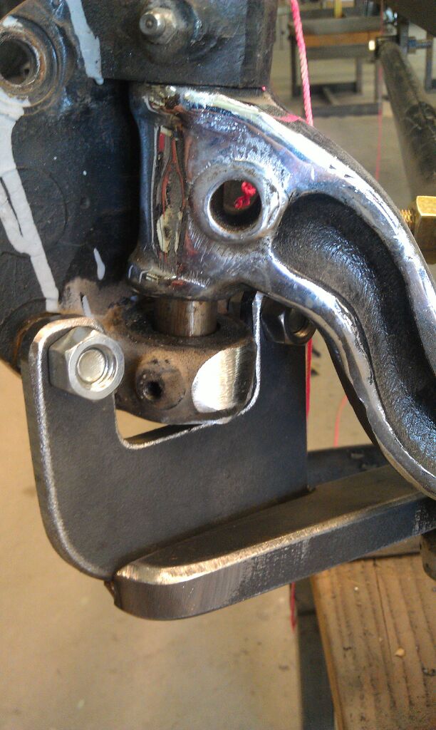

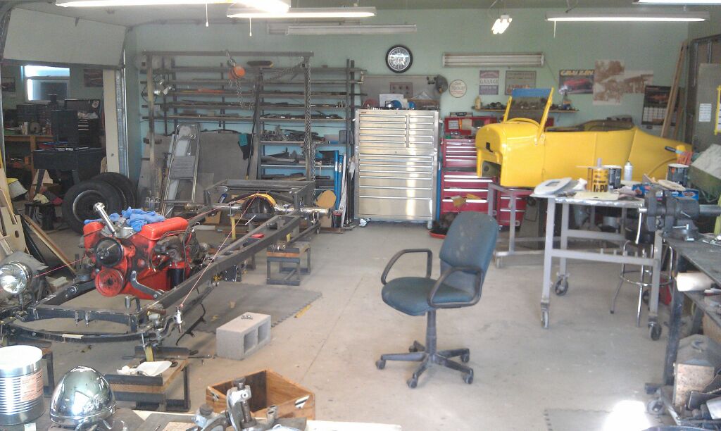

    Body is back off of the wife's T ch***is. Time to blast the ch***is, final weld, then prime and paint.
    Bob has been busy, including but certainly not limited to building steering arms to clear my axle. The drop between the king pin and batwing areas didn't leave any room for steering arms.

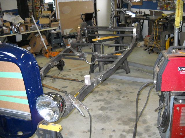

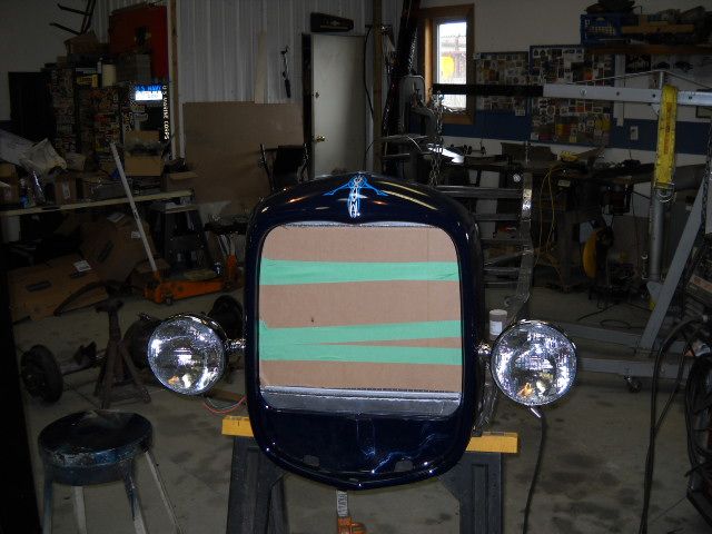

    Finally back to work on my coupe. The body is at the paint shop and I have the doors, deck lid, and grill shell back and striped. I want to thank a couple of good buddies of mine in Chatham Ontario for help with the chop, paint and stripes. Cool guys - Lionel and Al.
    The ch***is goes off to be blasted and epoxy primed next week then a little filler in a couple of spots and some more prime and paint. Then I can start ***embling this beast for the last time, I hope. Got a high school reunion in October and it needs to take me there!

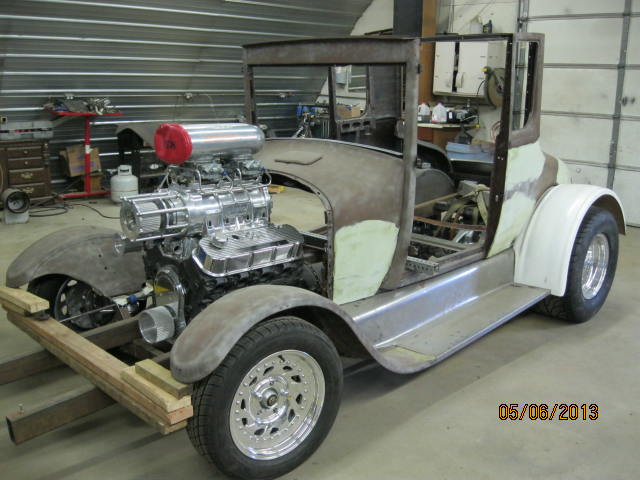

    This is my T. 454 BBC, TH400 ******, Jaguar rear end shortened 5 3/4" and a Heidts pinched front end. Plan on leaving it a tall T.

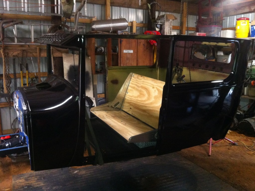

    Getting the dash ****oned up

    Way way too much motor, there will be no possibility of having a rad anywhere near where it should be and the car may end up looking rediculous.
    But you may just prove that to be wrong :)
