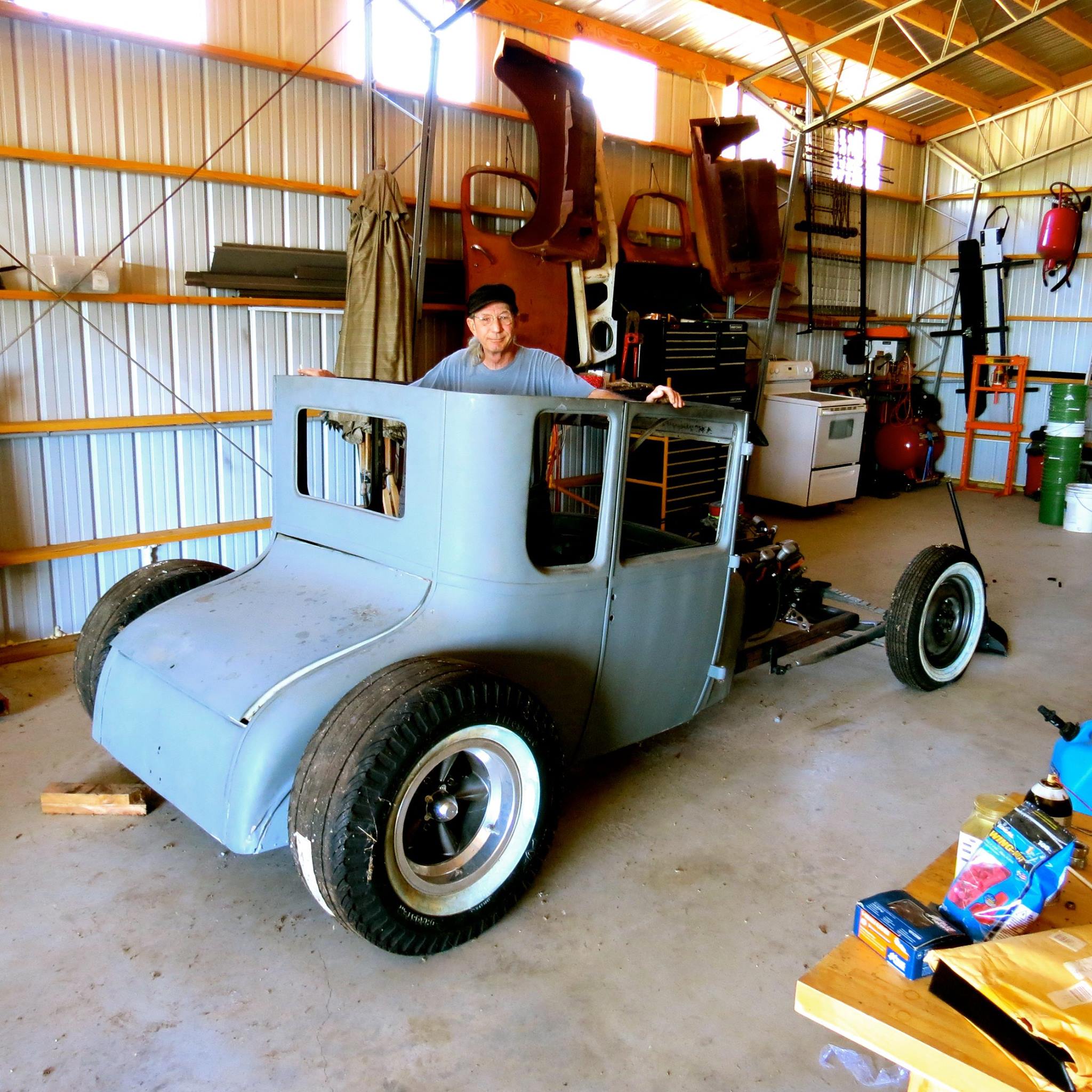

    10608587_10203226442087672_8089701519617561954_o.jpg After a long hibernation period, the Hotrodshiftknob 27 Tall T build is off the back burner. Here's a teaser shot of the car taken a couple days ago from its secret bunker in the Texas hill country. Does the dude standing in it look familiar? Anyone? HE's responsible for where it is as of now and where it will be heading in the very near future.
    I don't want to let the cat completely out of the bag, but look for a build blog on here with lots of progress pics following the thrash to get it to the LSRU show in April. Gory details forthcoming. Now if you'll excuse me, we have a care package to bust open from Jerry at Pete and Jakes. That is all for now. Over and out.

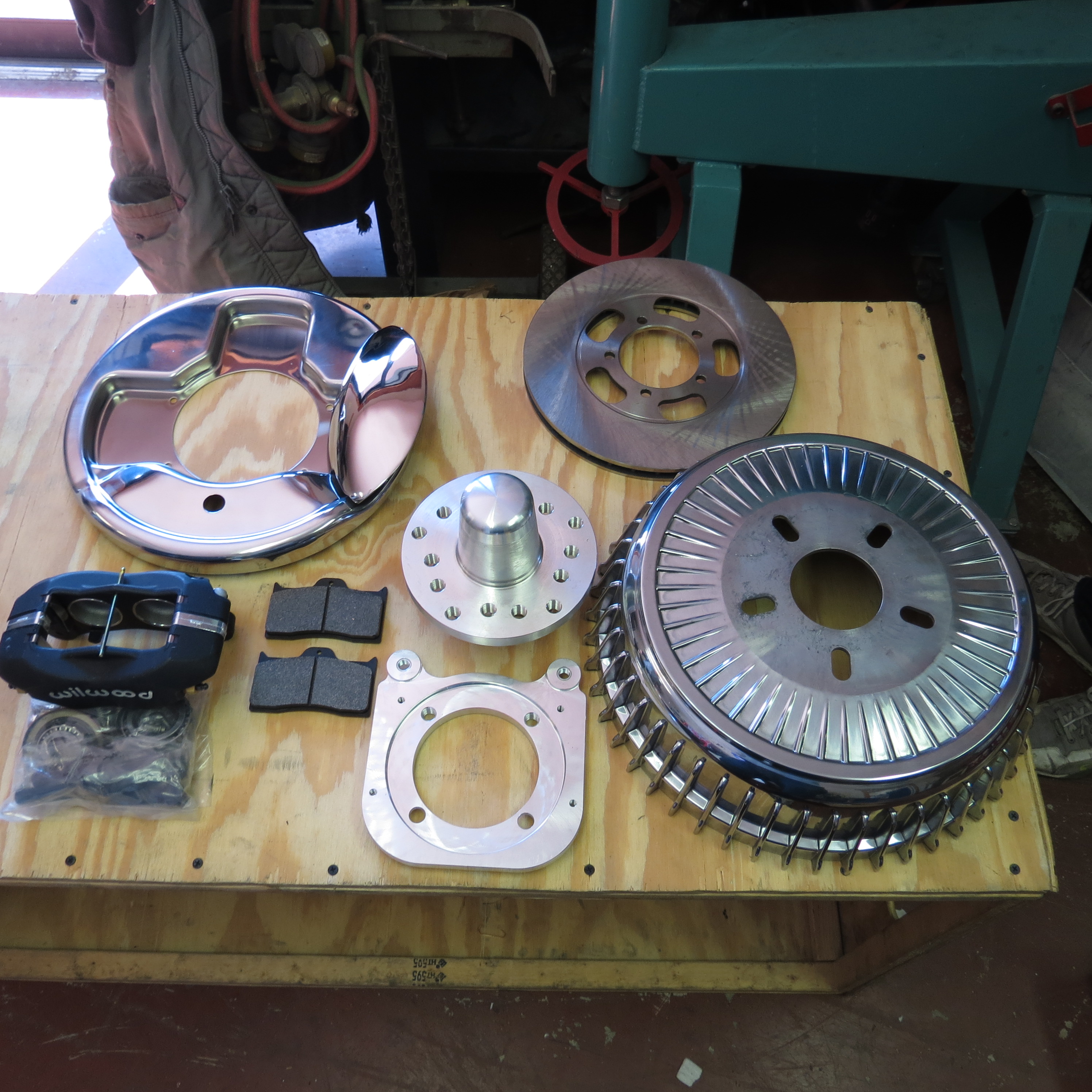

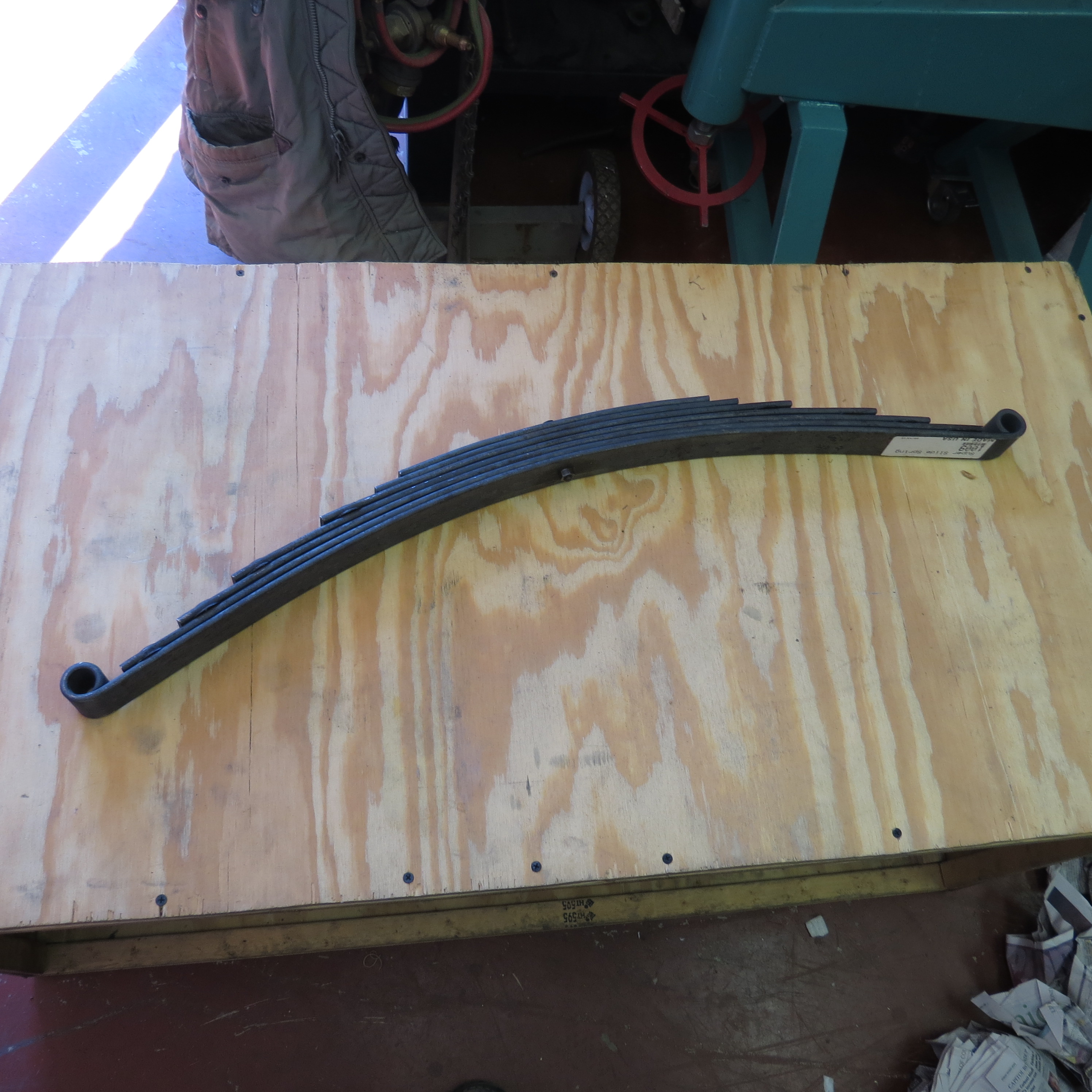

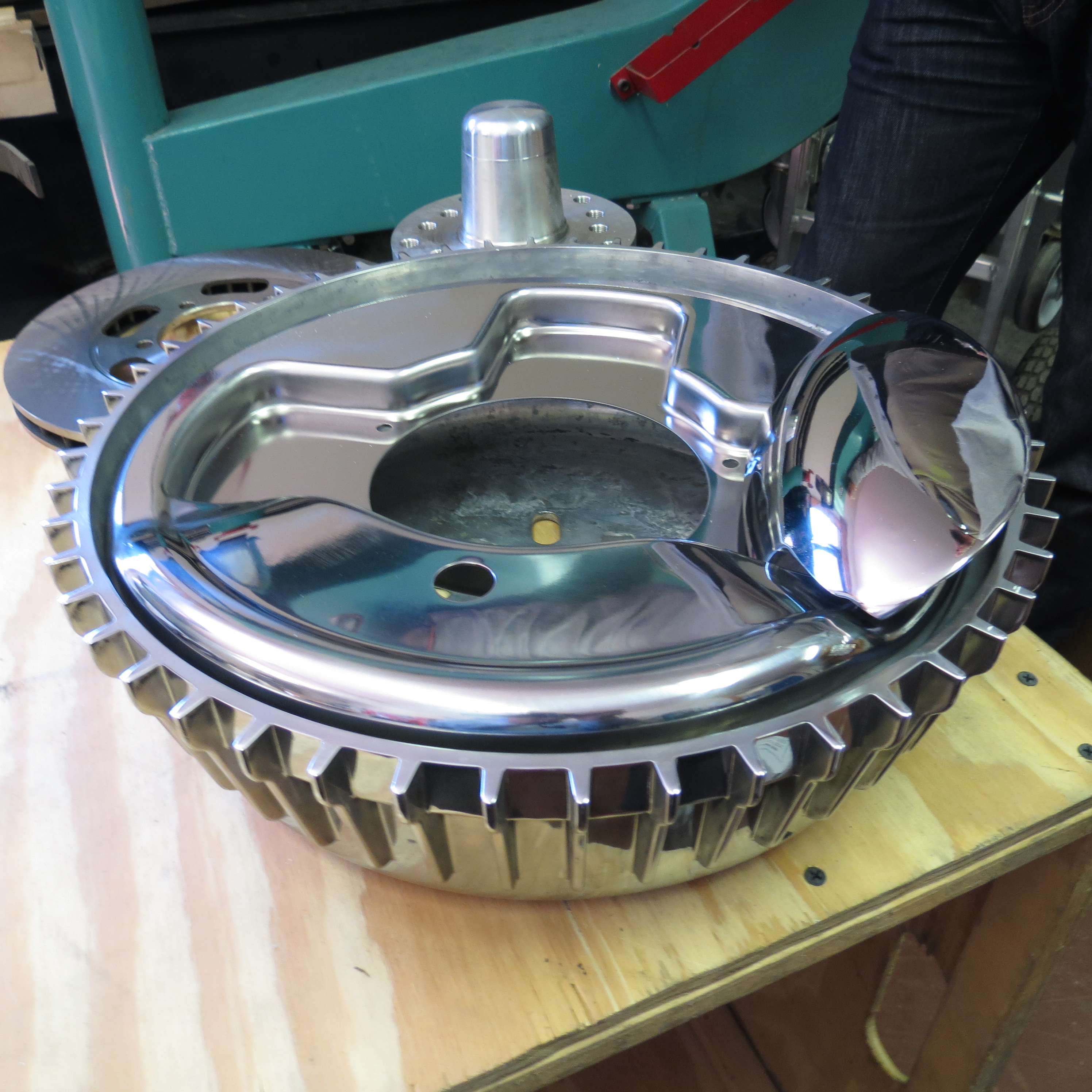

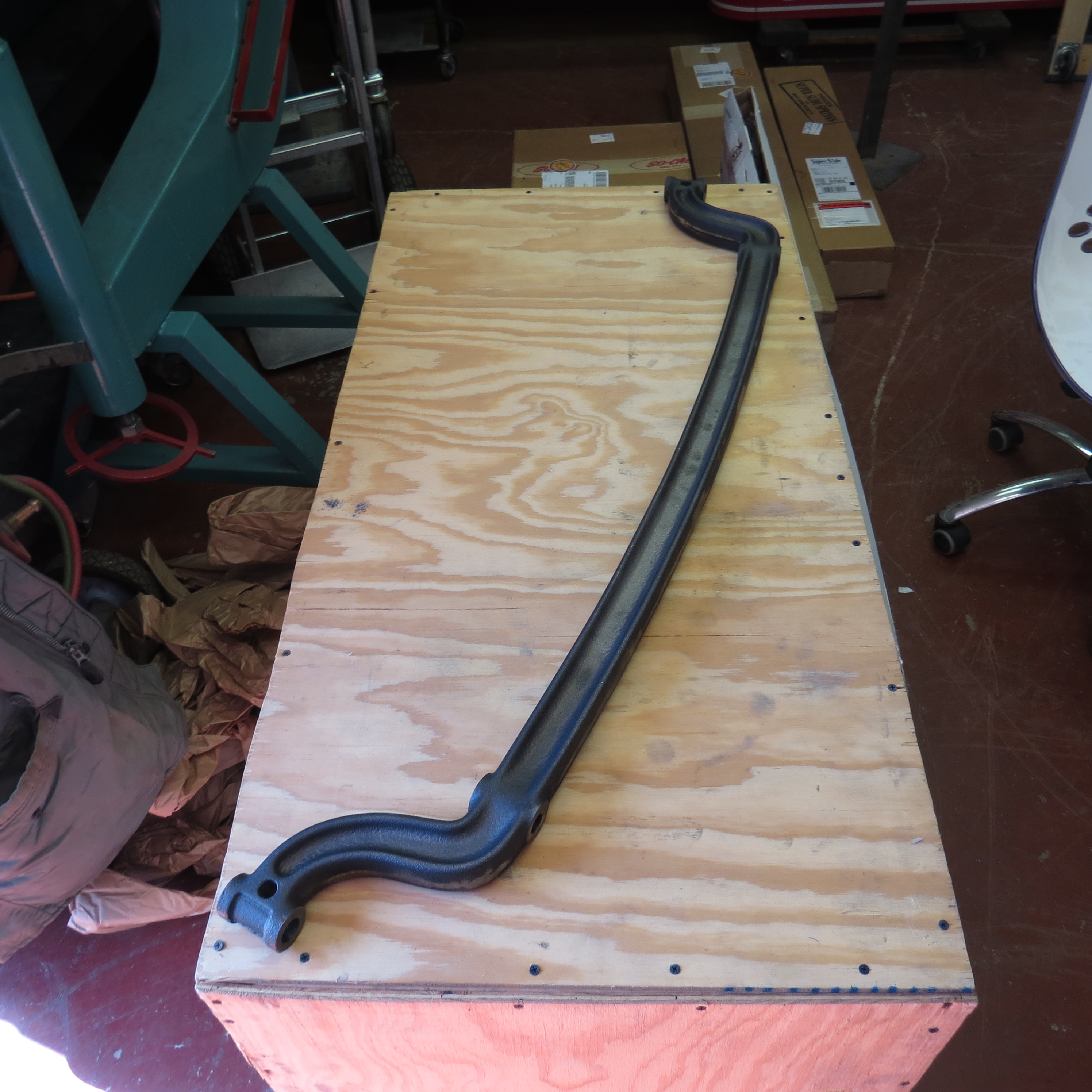

    Front end parts arrived from Pete and Jakes today. Magnum 5" drop. Super Slider spring. Went with a few chrome goodies but for the most part tried to not go nuts with the shiny stuff: Went back and forth on the front brakes, and Charlie and I decided to give the So-Cal Faux Buick Drums with hidden discs a try. They look pretty nice, IMO. Hopefully they'll stop as good as they look.
    BUICK DRUM.JPG FRONT SPRING.JPG T FRONT DRUM COMPLETE .JPG T STERRING PARTS.JPG T 5\" DROP SPINDLE.JPG T STERRING PARTS.JPG

    In my experience the So Cal brakes work GREAT as long as you remember to bleed the TOP of the caliper! Might sound silly but the top screws on my buddy's car were impossible to see once ***embled. He'd forgotten all about them by the time it was roadworthy.

    Oh man I like that brake setup :)

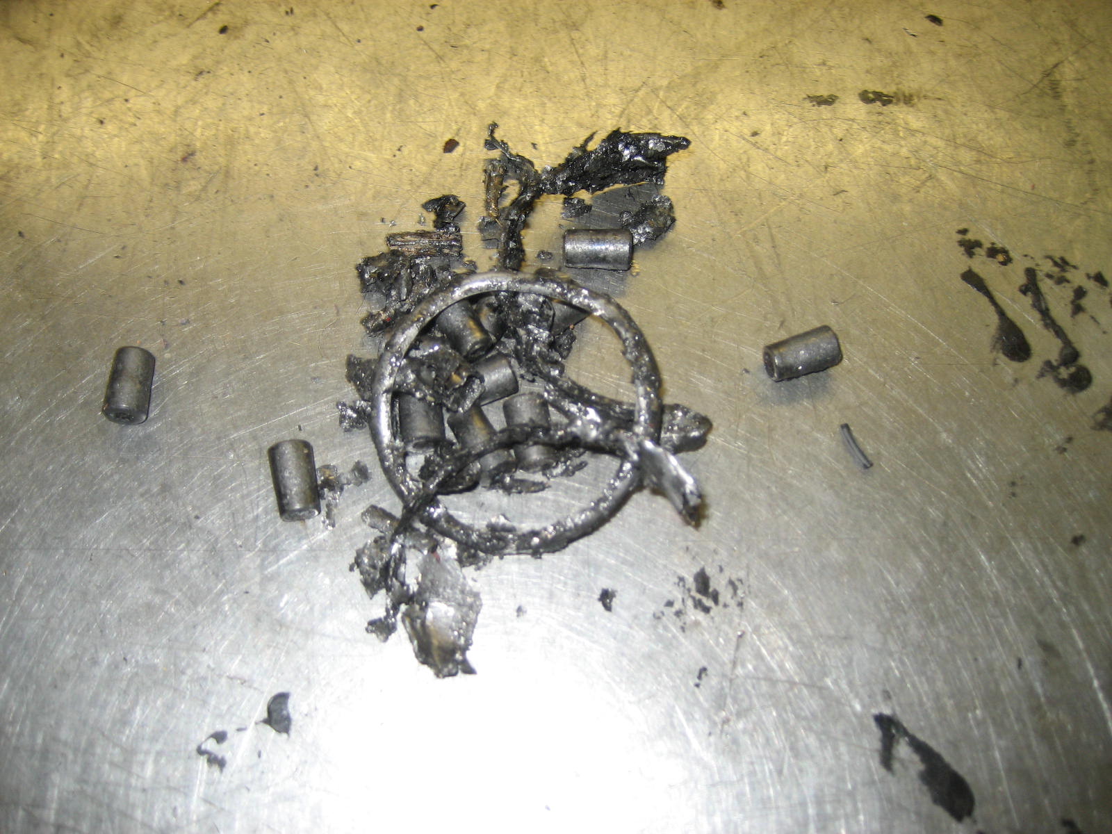

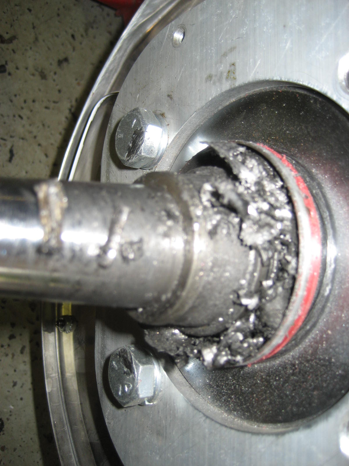

    One another thing abot the So-Cal brakes. I suggest you replace the chinese bearings with Timkens or something. I got to drive less than 35 miles before inner bearing was totally destoyed. Inner race welded itself to spindle and outer one ate the hub.

    -The entire ***embly rides on a New Traditionalist CNC machined aluminum hub that includes the highest quality bearings and seals on the market.

    Yep, I've read that too. My set had HL-bearings ( well, I guess they are top level in Chinese bearing industry)
    Althoug I bought my set couple of years ago.. Maybe things have changed.

    Now that is a trashed bearing :eek:

    Otherwise they work well :)

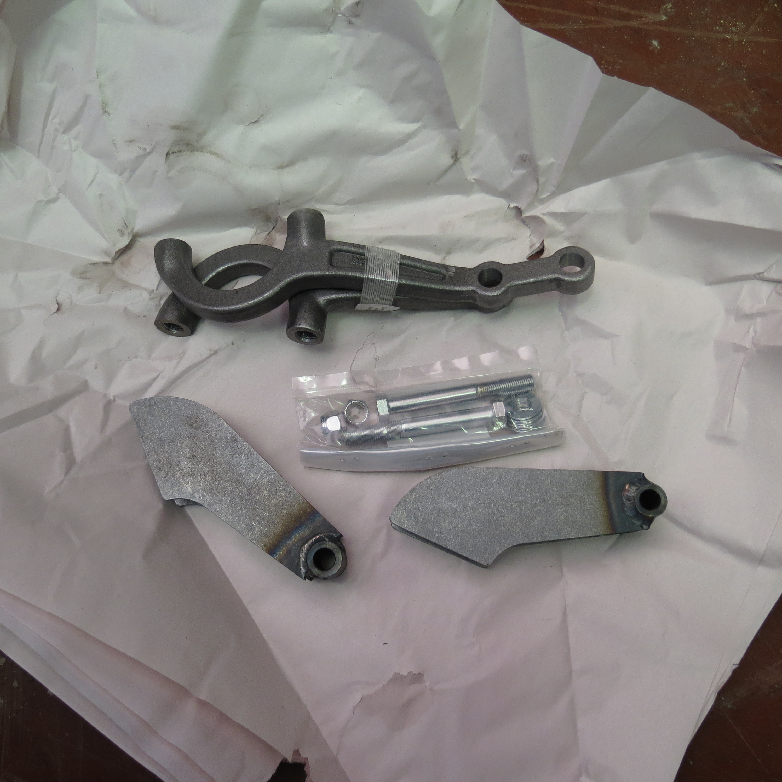

    So-Cal steering arms are must for bleeding, I learned it the hard way ;)

    Ok so now I'm curious, what do steering arms have to do with bleeding ?
  28. papacub
    Joined: Sep 2, 2010
    Posts: 17
    papacub
  29. Skelli
    Joined: Apr 16, 2008
    Posts: 16
    Skelli
    from Finland
    They have to be bolt thru style. If you have normal steering arms that are bolted on from "inside" thru caliber bracket, you can't unbolt them, because bolts are stuck behind brake disc. And since you can't get them off, you can't turn caliber brackets and brake cylinders to front and back which you need for bleeding.
    I hope this makes any sense. There are directions on So-Cal web pages.
    I had to unbolt the whole front axle to tilt the cylinders.
