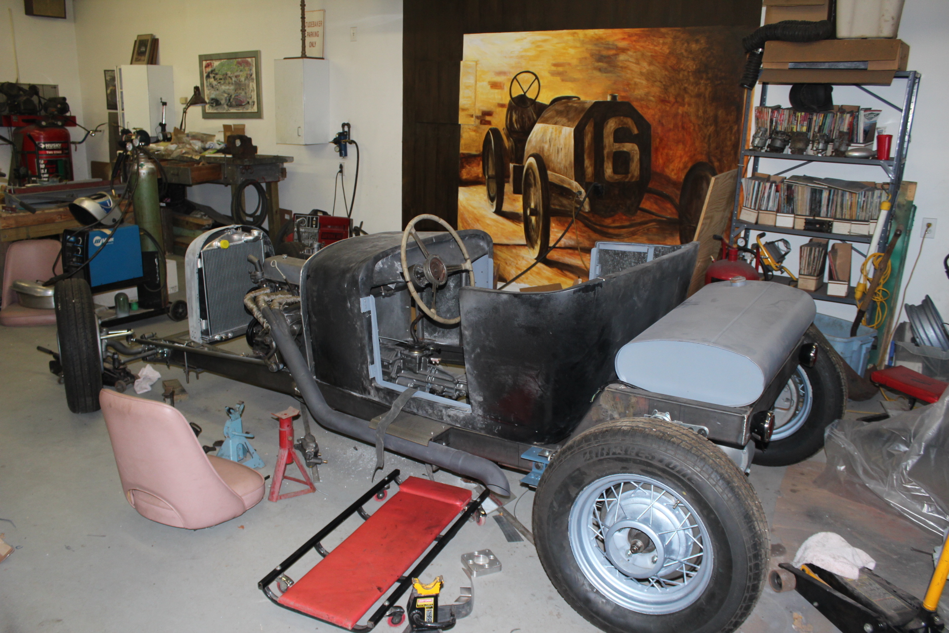

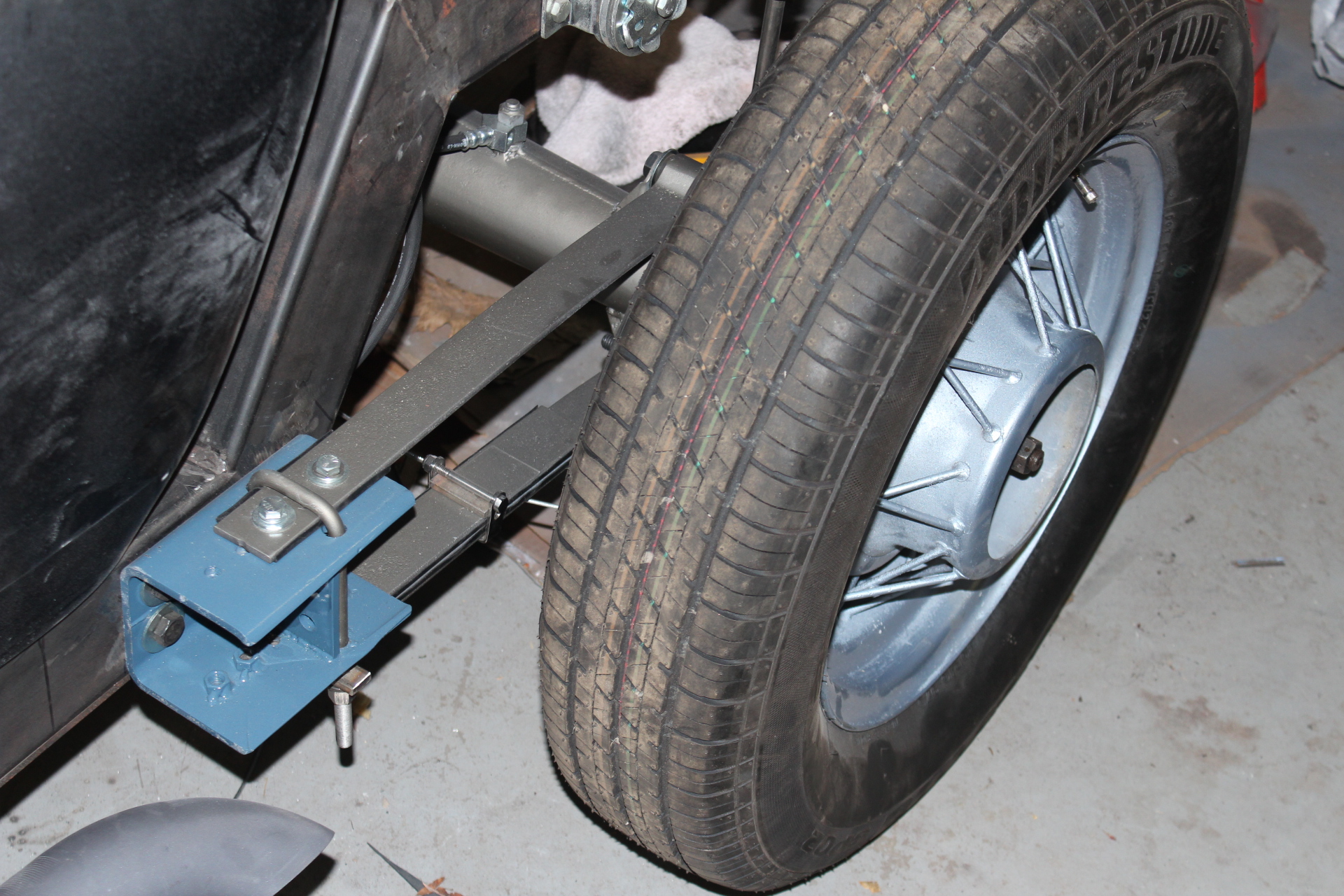

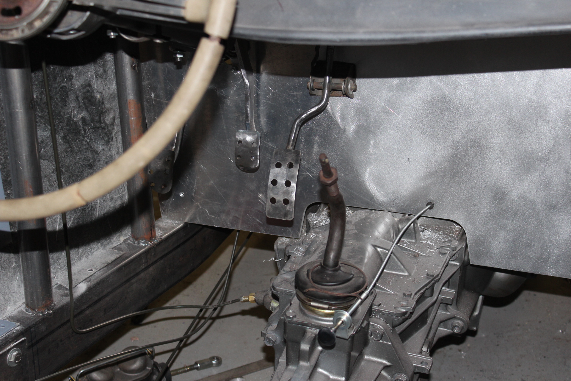

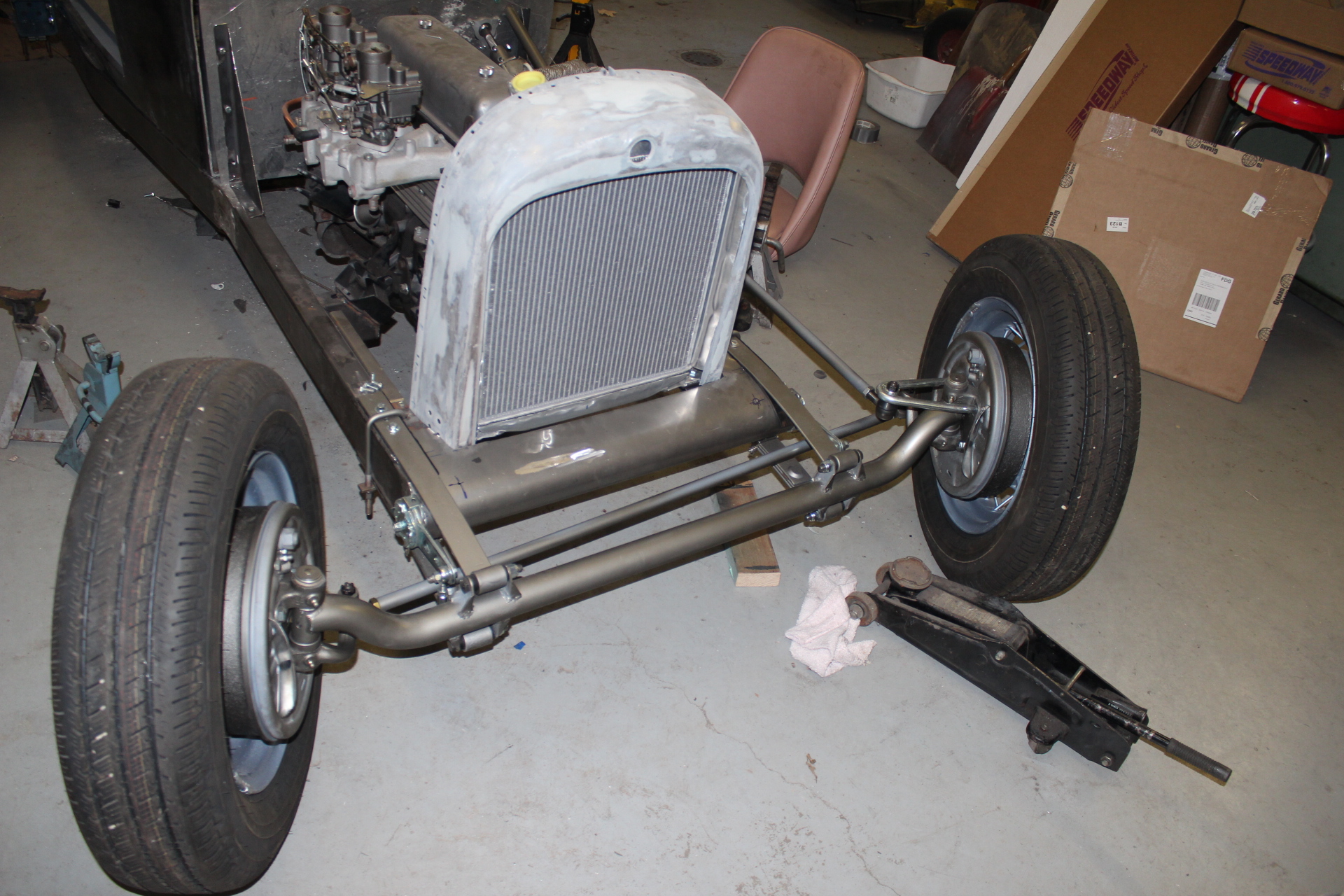

    Presented herewith, for your amu*****t, is my modified project. I used a S10 engine/trans, because it was laying around the shop, and eight spring suspension. If it worked for Harry Miller at Indy, and all those 30s British sports cars, it should work for me. IMG_3924.JPG IMG_3925.JPG IMG_3928.JPG IMG_3930.JPG
    Lil'Alb and Olson like this.

    Was it shorten, or dropped to narrow it? I need to drop my A axle to get the tires to center on the fenders, and to lower the front.
    Or is the offset on factory wires wheels that different, that it doesn't need to be. I see that the '39-40 rearend fits the tire nicely

    These pictures remind me a lot of a 27 T that was the feature of a thread on here that was deleted.
    He had a suspension with multiple springs much like yours and was saying that the car was all over the road, almost uncontrollable.
    The poor design of the suspension was pointed out to him by plenty of members and eventually the thread was deleted.

    Good luck with it. While you are building, you should definitely figure out a effective panhard bar system for both front and rear.
    The other car had none and that was probably a big part of his problems.

    One of the factors on the ''other'' car was the springs were not set very far apart and you would be able to steer it like a skate board, that was a lot of the problem, but not all.JW

    The rear Panhard bar is already in place. Still considering how to deal with the front.

    I don't see a panhard bar there, just the lower tie rod for the steering.

    My best friend built this T a few years back and this had a same set up. No panhard bar needed as the springs kept the axle centered. This car rode and drove great. John\'s 23 Spdstr.JPG

    JW, mine doesn't have a panhard bar and it handles great, no bump steer, tracks straight and tru. I can take my hands off the wheel at 100kph, slam on the brakes and it doesn't move an inch off track.
