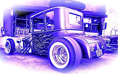

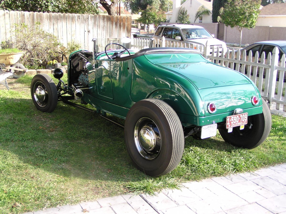

  4. ZZLEGEND
    Joined: Jul 20, 2008
    Posts: 250
    ZZLEGEND
    Thanks El. Ya. I think so to. I had black 16's on it for a while and I liked the size of the rears. 700x16. Might have to find some taller whites later. Maybe one day they will give tires away.....If you know what I mean. Mark.

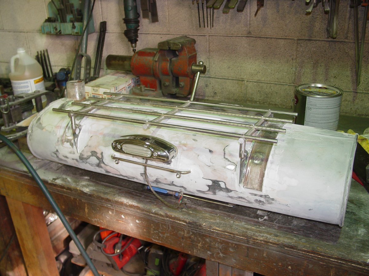

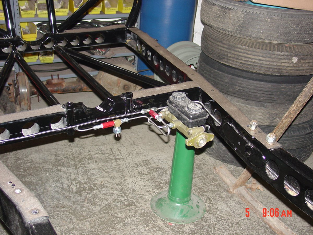

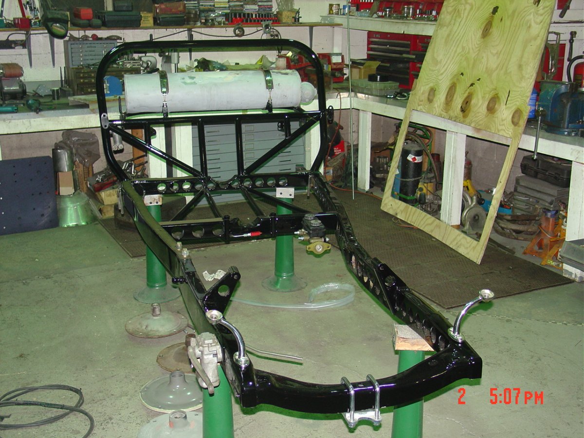

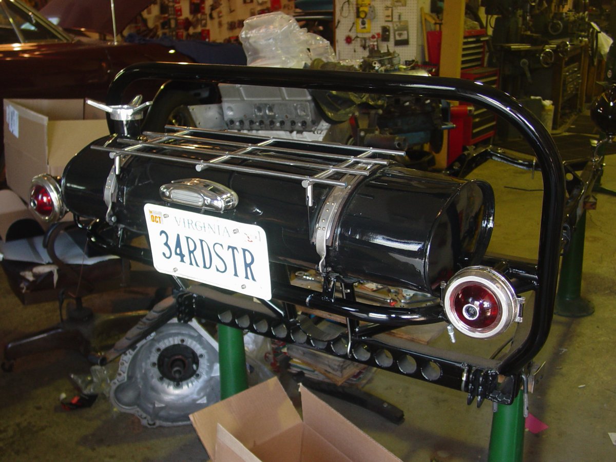

    Still pluggin along on mine, frame is painted and working on the suspension stuff. Other bits and pieces are being chromed, headlight & taillight housings are off to the pinstripers. I've been working on the gas tank, these things are so tiny that I thought I'd add a luggage rack to the top of the gas tank, the pic of it is work-in-progress. The tank was a mangled up '30ish Chrysler that was supposed to sit upright and I swapped the filler etc for laydown, the rack is stainless rods, the taglight/backup light is early Jag XK150?, the bracket below is the upper tabs for the license plate. DSC00957.JPG DSC01530.JPG DSC00026.JPG

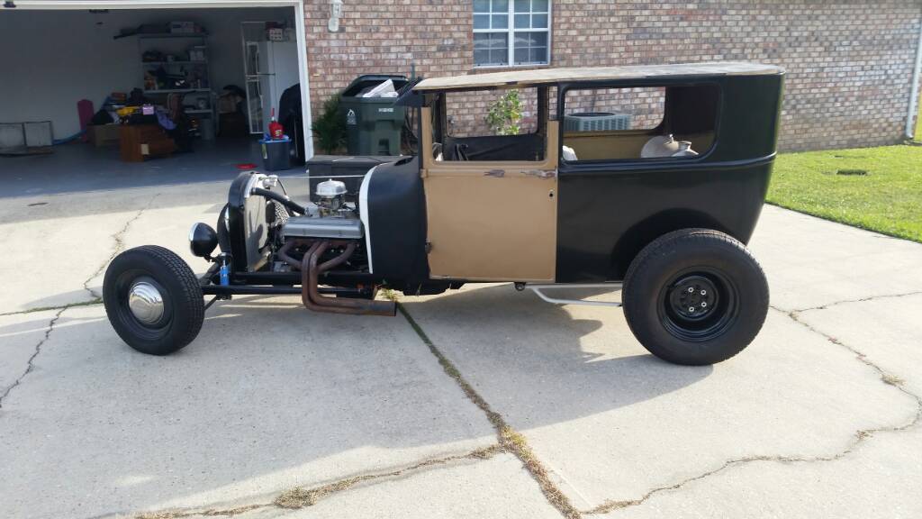

    Saving this one from a rat rod fate. Going to an A frame, split bones, dropped 35 axle, spring behind, and we'll see what else.. 1456444742943.jpg 1456444761089.jpg

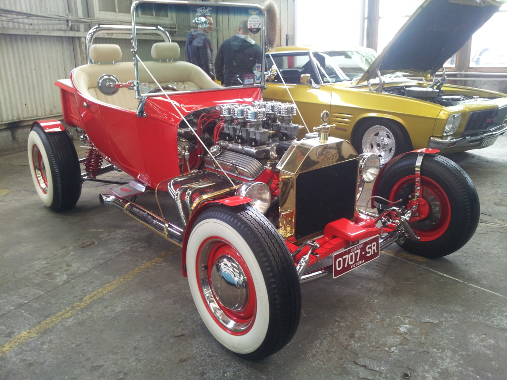

  10. 26 T Ford RPU
    Joined: Jun 9, 2012
    Posts: 12,954
    26 T Ford RPU
    First show for our RPU got us in a big NZ car Mag (NZ V8 Magazine).J:cool::cool::D W

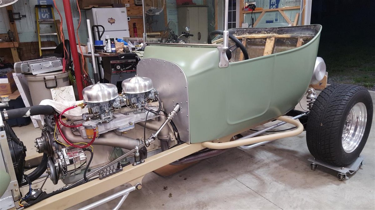

  14. hotrod brice
    Joined: Dec 16, 2008
    Posts: 61
    hotrod brice
    from molino,Fl.
    Here's my project

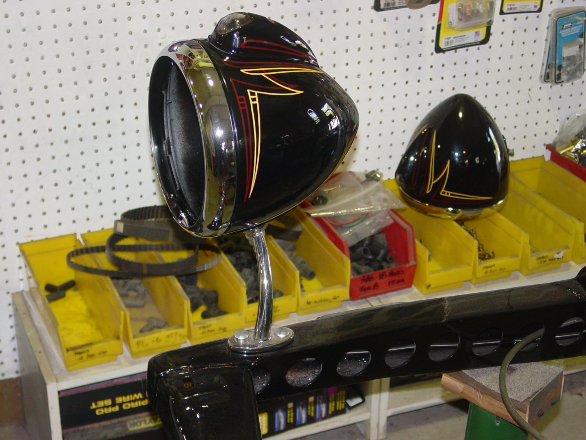

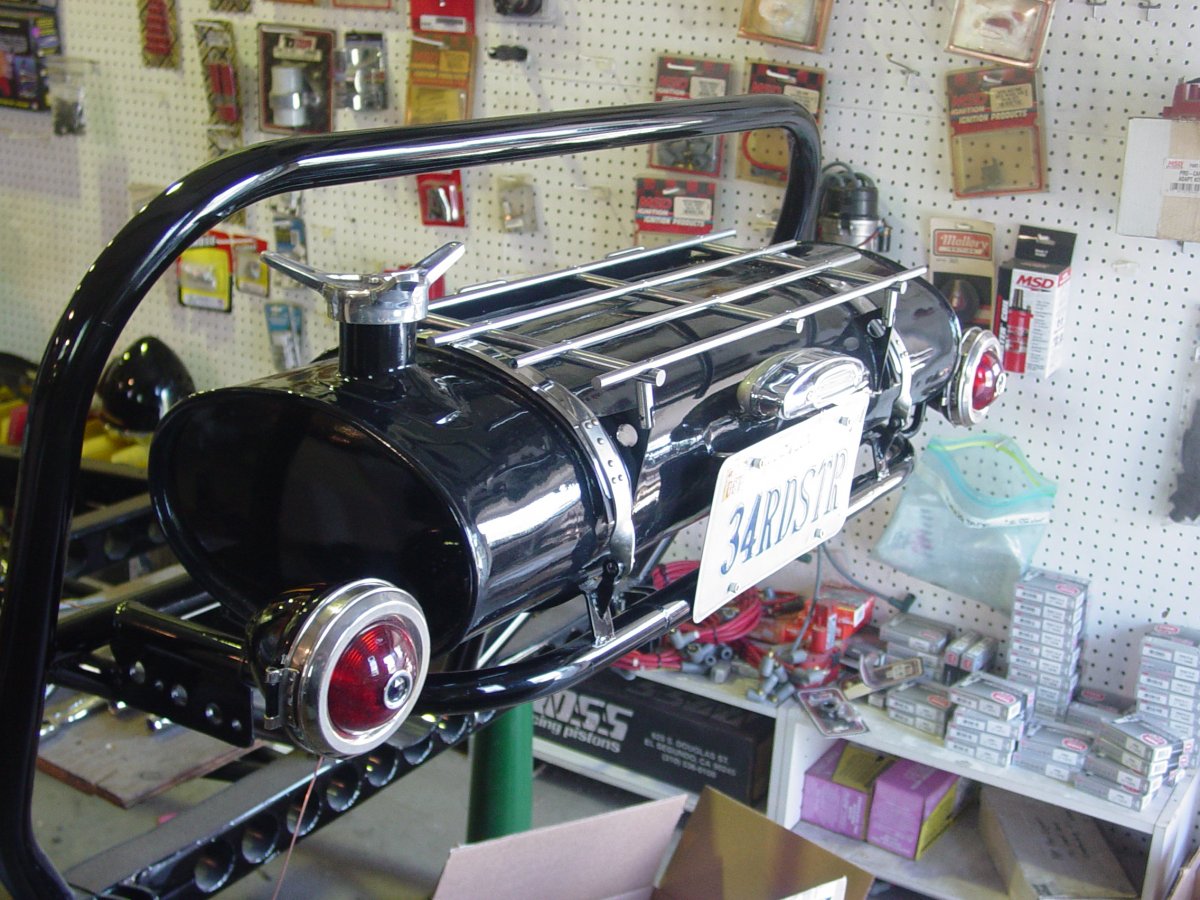

    Got some stuff back from paint and pinstriping and had a looksee, the tank is going out for pinstriping next. The license plate is just one layin around - it isn't a '34.
    The pinstriping was done by Matt Stankis over in Delaware. Lots of guys know him from the JalopyRama & JalopyShowdown, he wears the Gandalf hat. DSC00176.JPG DSC00177.JPG DSC00178.JPG DSC00141.JPG
