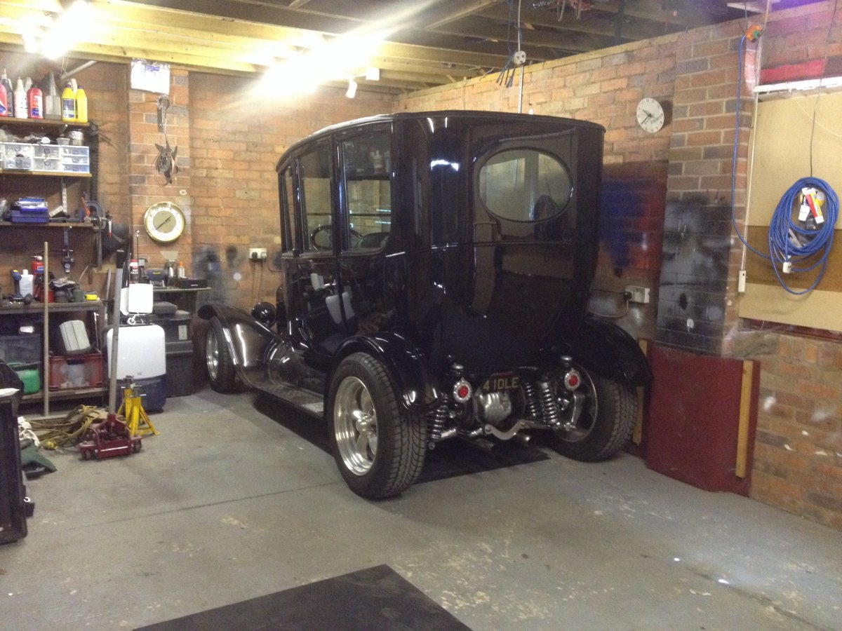

    All the rear bling now fitted and ready, just need to give my trusty Center Door a good old clean and off we go.

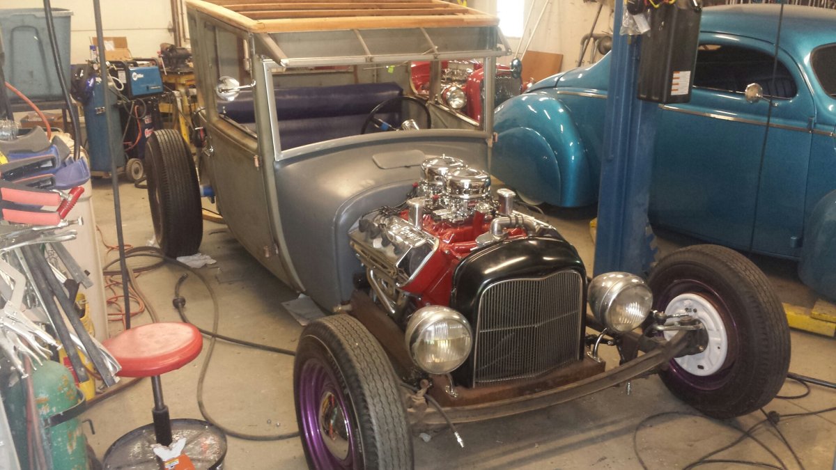

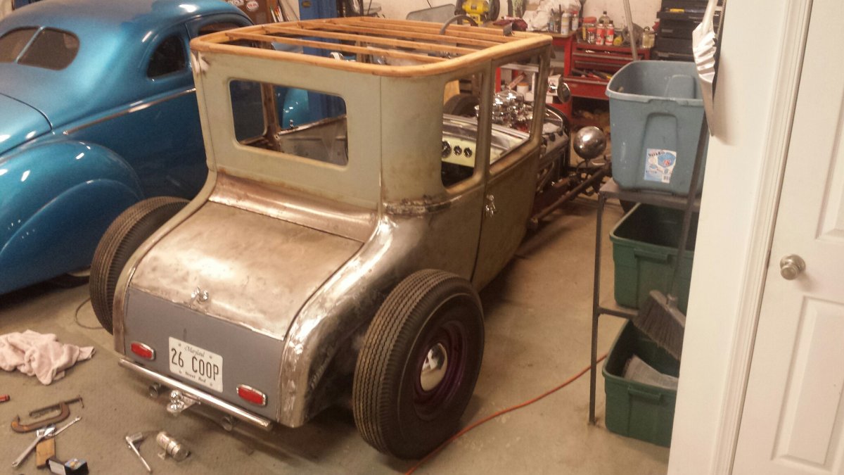

    It's been a long time since I updated my progress on 26 COOP. I decided not to chop it (after receiving more NOs than Yes's on this thread) and am moving along well. I hope to have it running down the road so I can take it to my 55th high school reunion in September. Almost all components are done and about ready to remove the body to finish and paint it and work on the frame finishing.

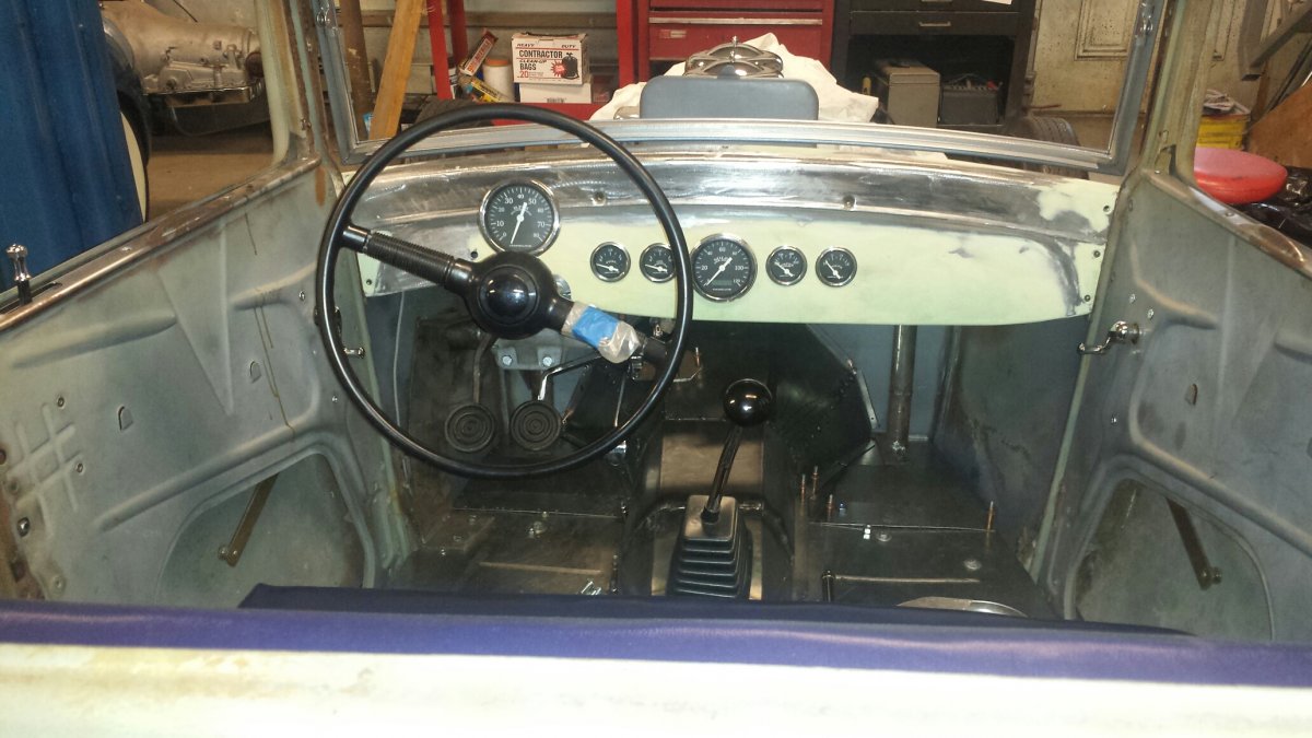

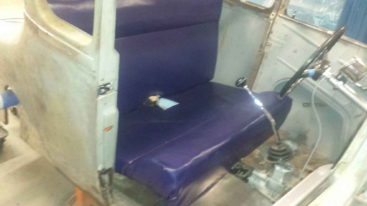

    I mocked up a seat and found room for the third pedal next to the TKO500:

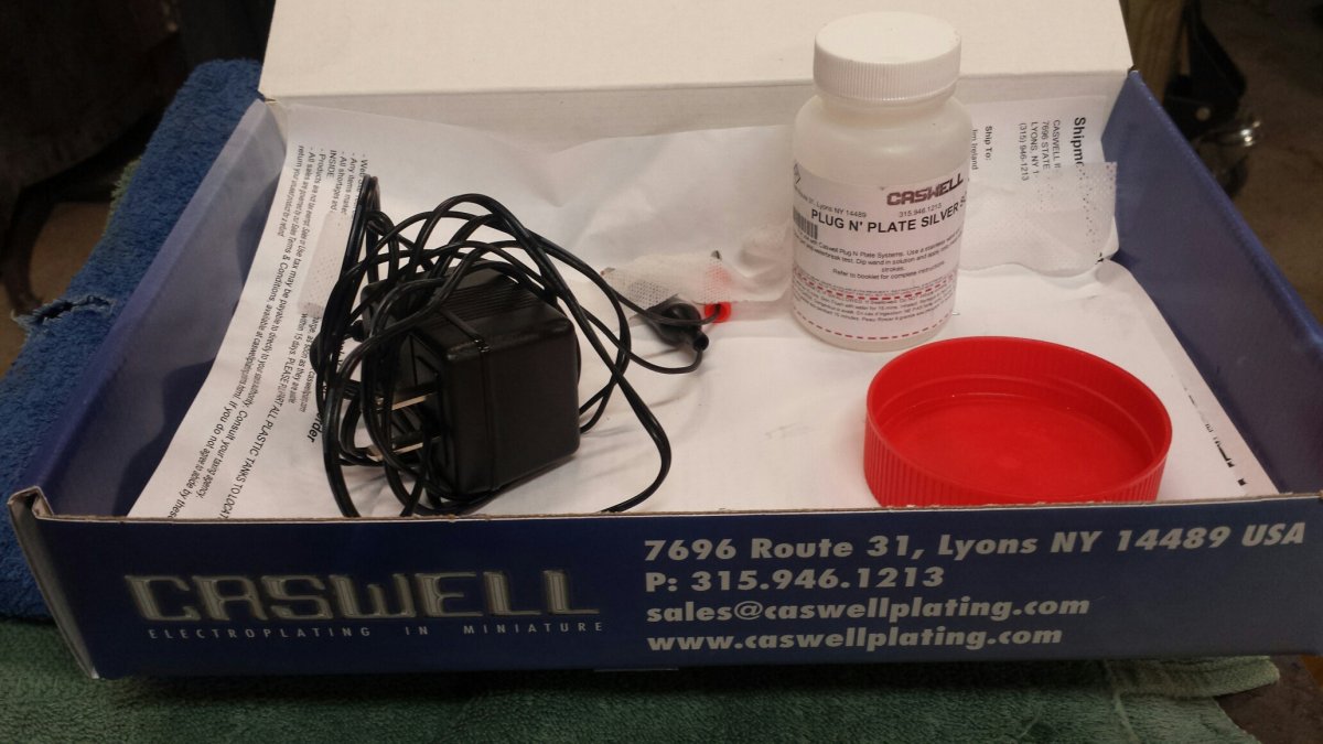

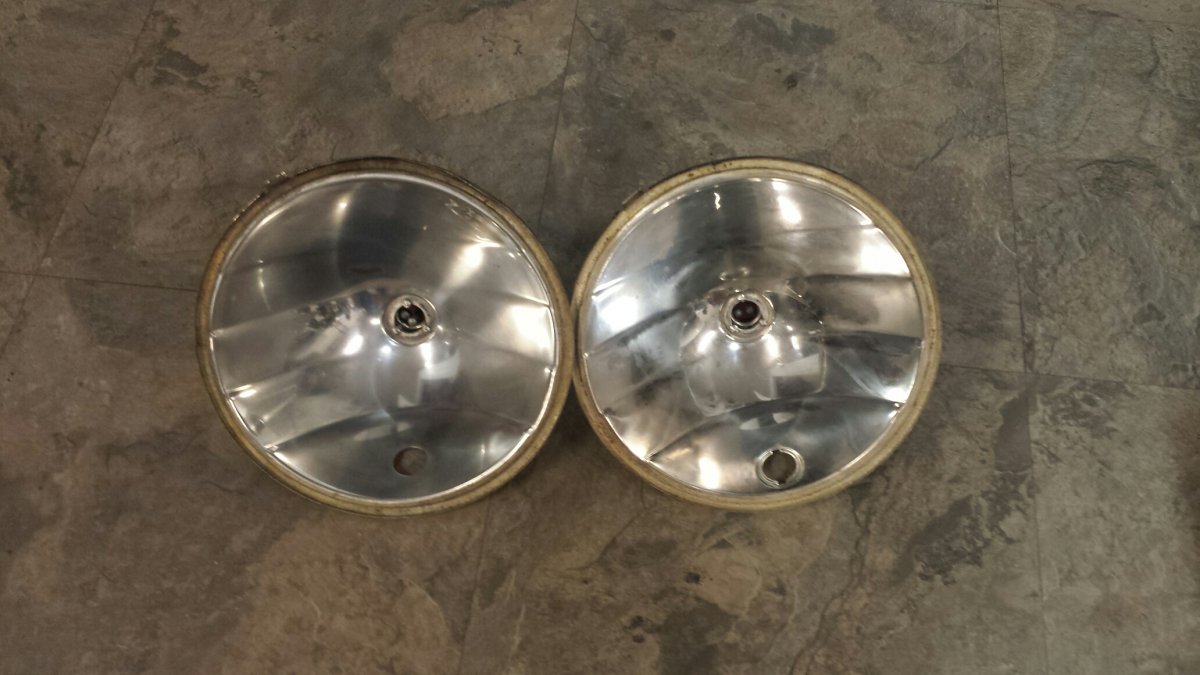

    Of perhaps some interest to other builders, I have been working on the headlights on 26 COOP. I really want to make them work for it, 'cause I think they look cool. It turns out they are '34 or '35 Chevrolet Master Deluxe lights. Know how I found out?....I dropped one and broke the lens! Then I found a Chevy marking and started to look for a matching lens. Found one on eBay and another pair on another site. Bought all three.
    Then it came to the reflectors. They are silver plated br*** and, except for some of the silver plating missing, were in good polished condition. After some research, I found caswellplating.com and bought a silver plating kit.
    IT WORKED! It took about an hour. Washed the reflectors with Barkeepers Friend. Then did the plating, followed by polishing with Never Dull and finally waxing:
    20170419_171022.jpeg Neat kit and cost around $50. Keep it in the back of your mind if you ever need one.

    That's handy to know. KW

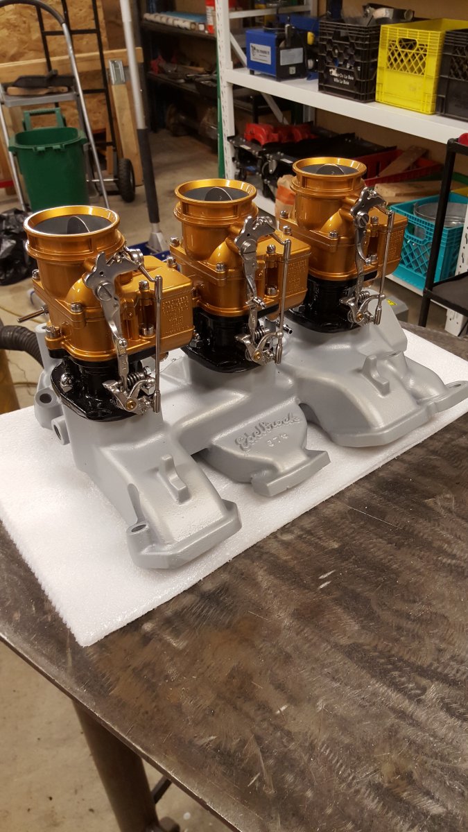

    My body has been blasted and the frame is ready for paint.... parts are chromed and other parts are powder coated ...getting closer. :cool:
    IMG_0819.JPG IMG_0836.JPG parts 2.png 20160110_161420 (2).jpg IMG_0797.JPG IMG_0822.JPG

    The intake and carbs is a thing of BEAUTY

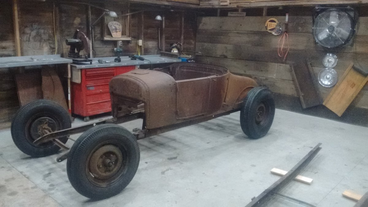

    Here is a little teaser of what I am working on. Build thread coming soon... IMG_20170501_205721795.jpg IMG_20170503_200920733.jpg

    Looks good Ryno. Stop by if you're in town. Here is the one I'm working on.

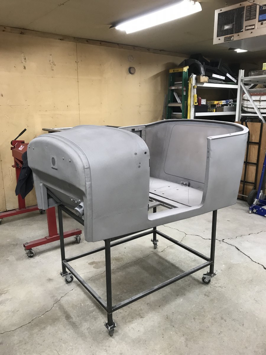

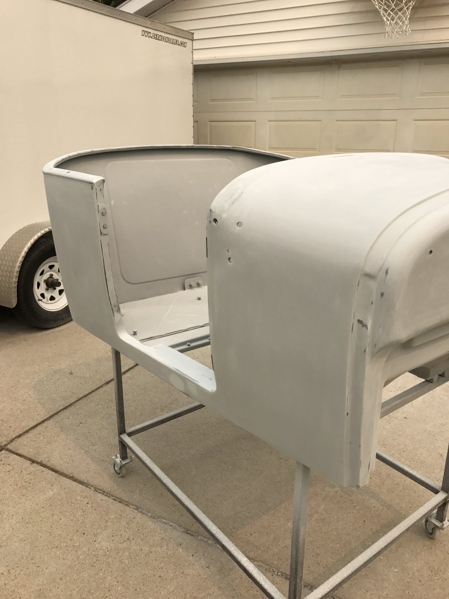

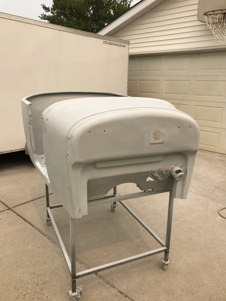

    The body is primed ,filled, sanded and shot with high build.
    Then sanded again and blocked out to 400. Ready for paint :cool:
