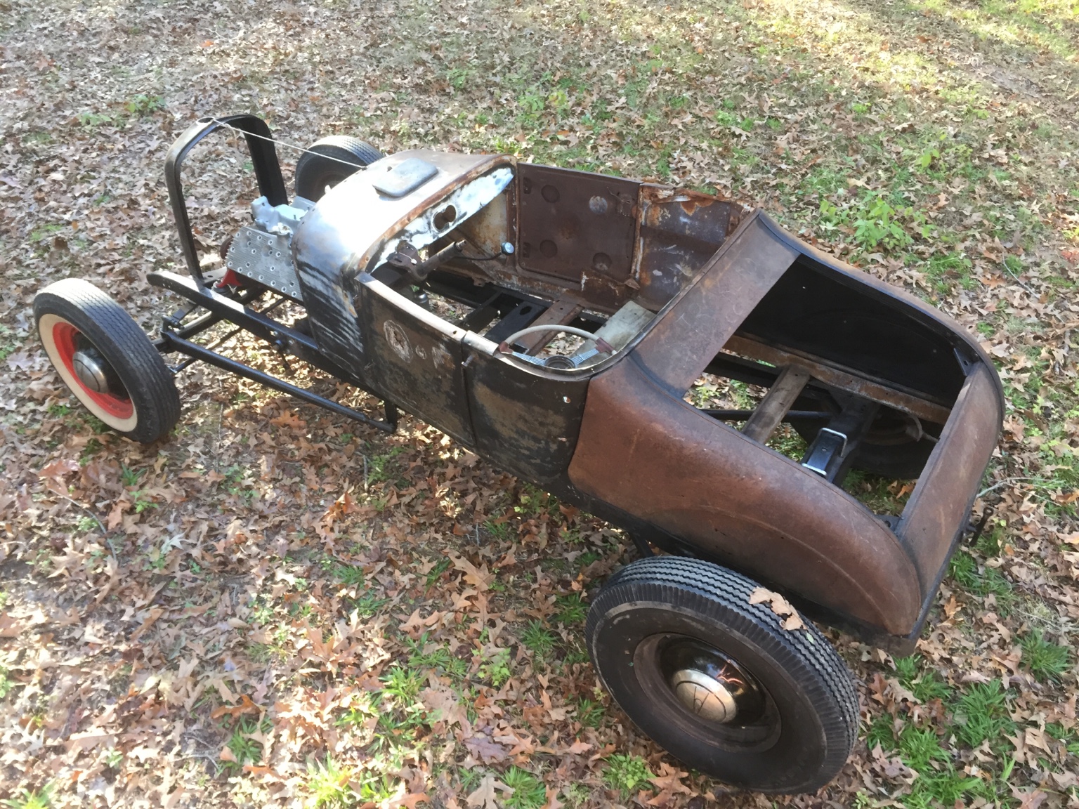

    Slowly chipping away

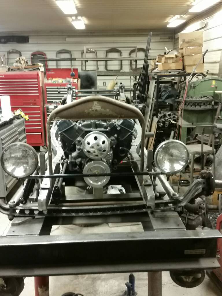

    Here's mine. Finished this spring and drove it about 3000 miles. A few engineering flaws to work out this winter. A build thread to follow, coming soon, I hope. IMG_3624.JPG

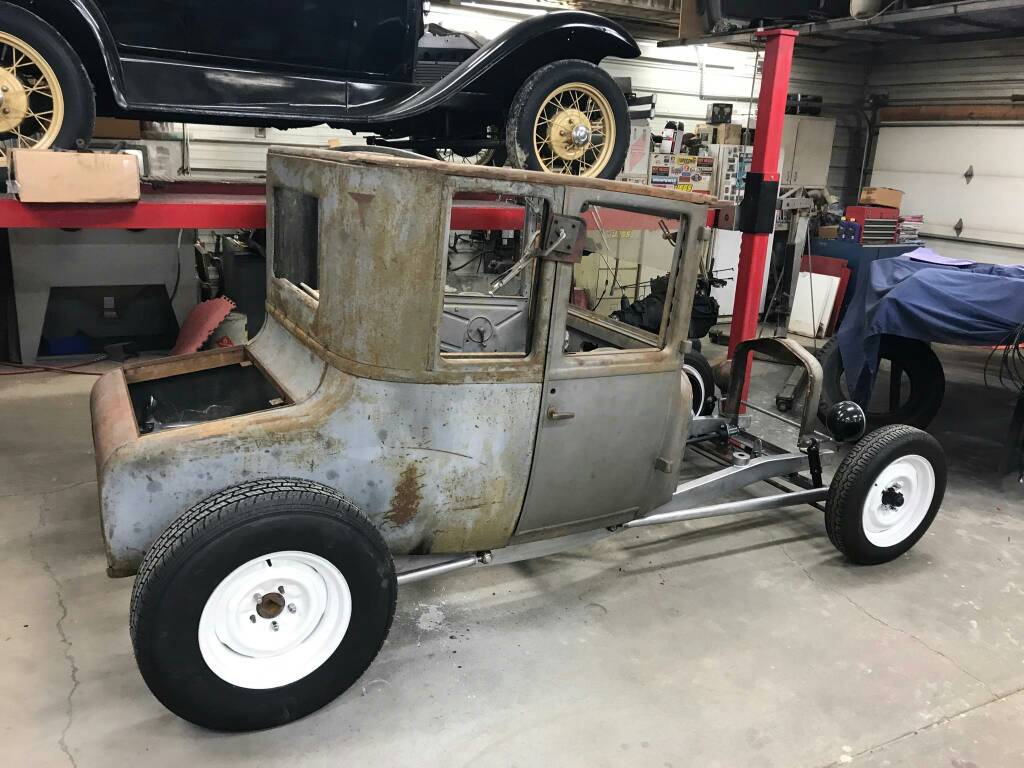

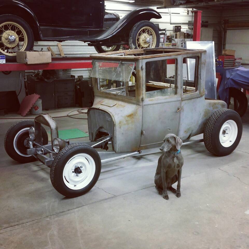

    I picked up this '25 coupe body a couple of months ago. I wasn't looking for a project, but I couldn't p*** up a rust free body for the price. It's been in a barn loft for the last 50 years. Still has working window regulators and everything.

    Been working on it in my spare time since bringing it home.

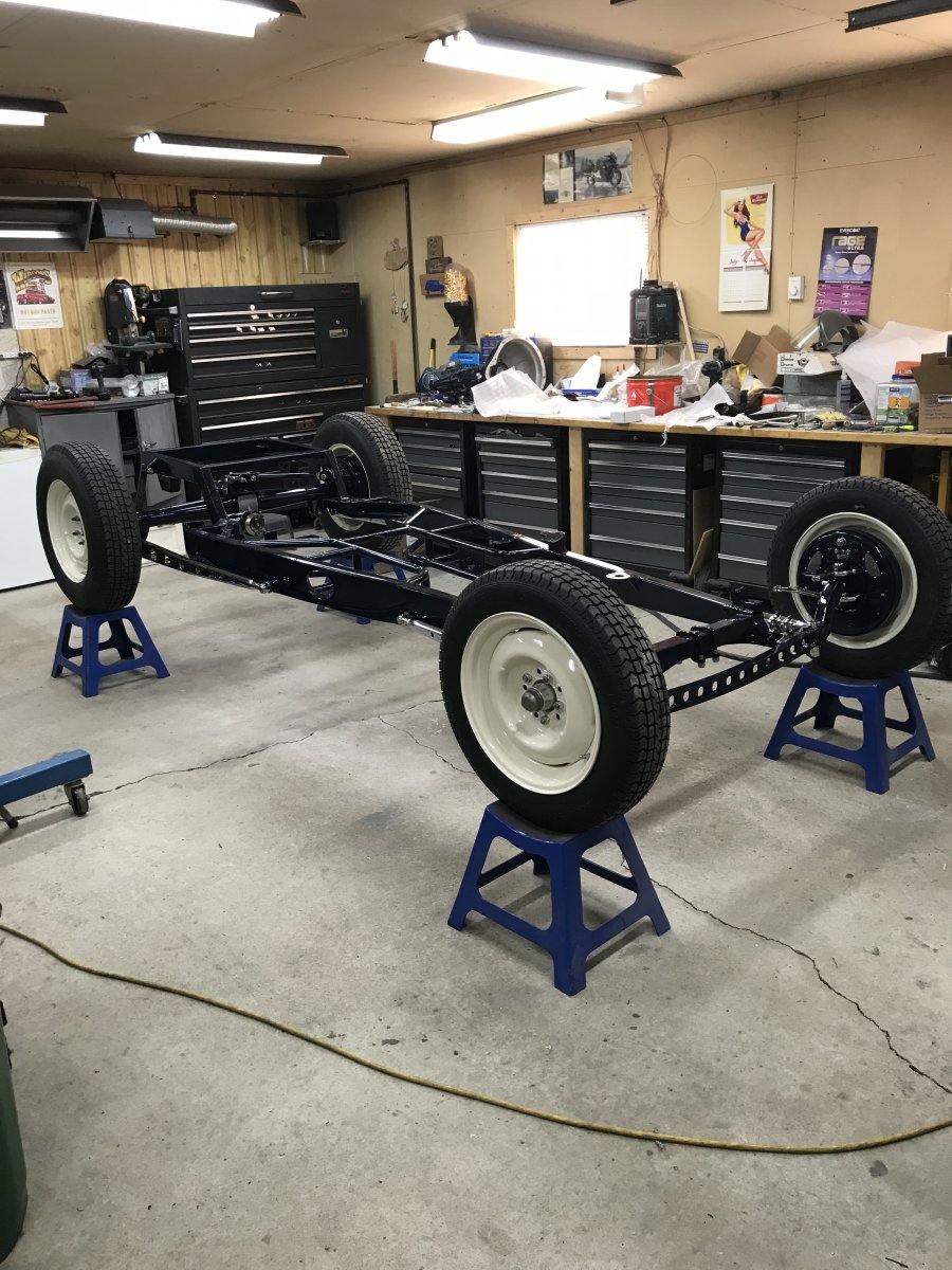

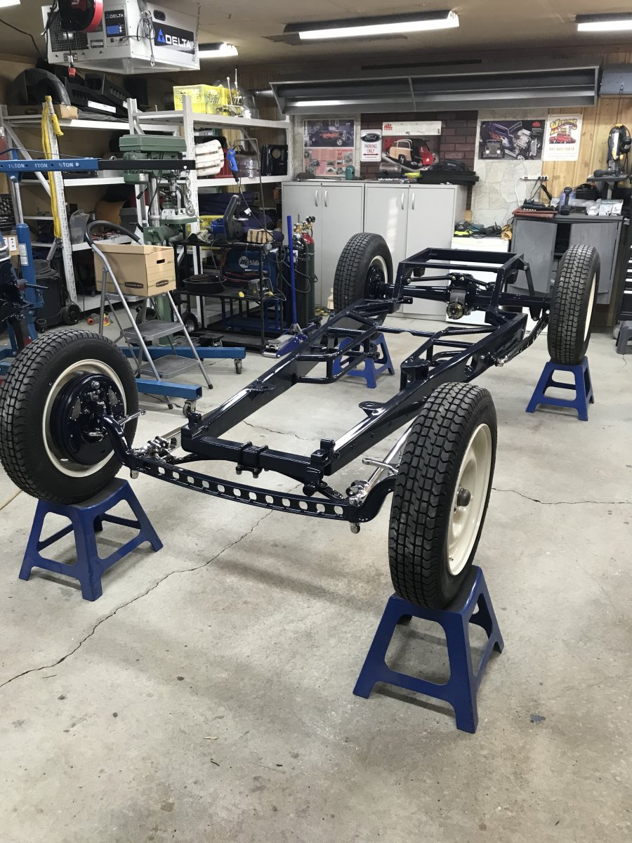

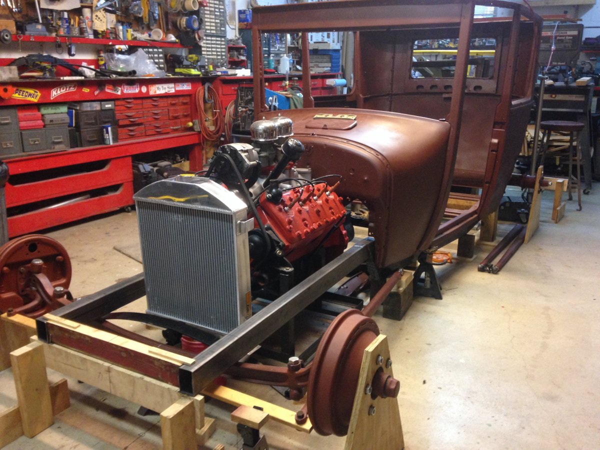

    Here's the frame we made for it. It may not look like it, but we started with two pair of '33-'34 Ford boxing plates, shortened, sectioned, and kicked up the rear. Then the top and bottom pieces were cut to fit the body. I don't like the looks of a front axle stretched out in front of the radiator, so a lot of work went into keeping the axle under the radiator, and keeping a short wheelbase (101").

    We set the body on the frame for the first time last night. [​IMG]

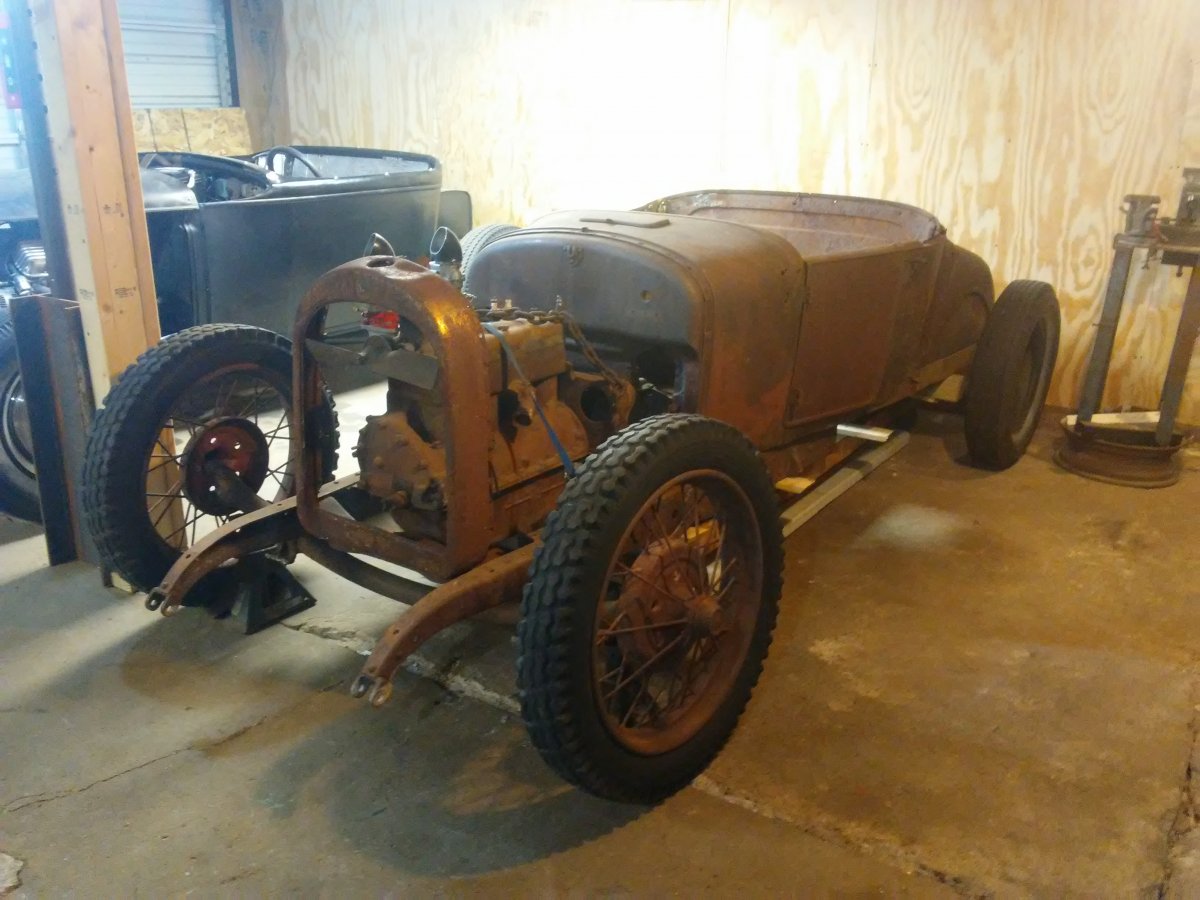

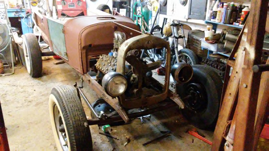

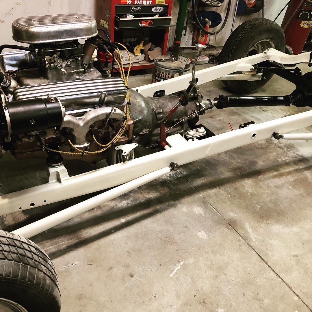

    IMG_0403.JPG IMG_1874.JPG Been gathering parts for nearly 7 years. Retired in June and got serious about this in October. Here is where I'm at...
