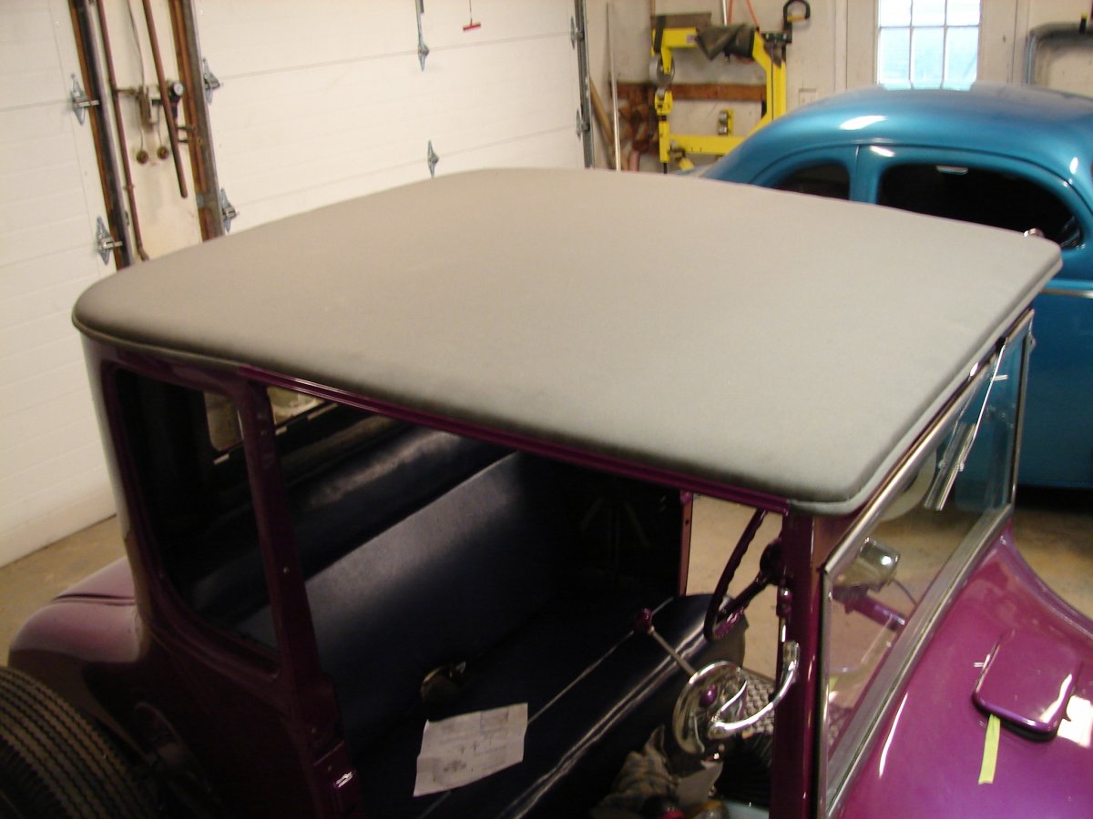

    Top looks great. :)

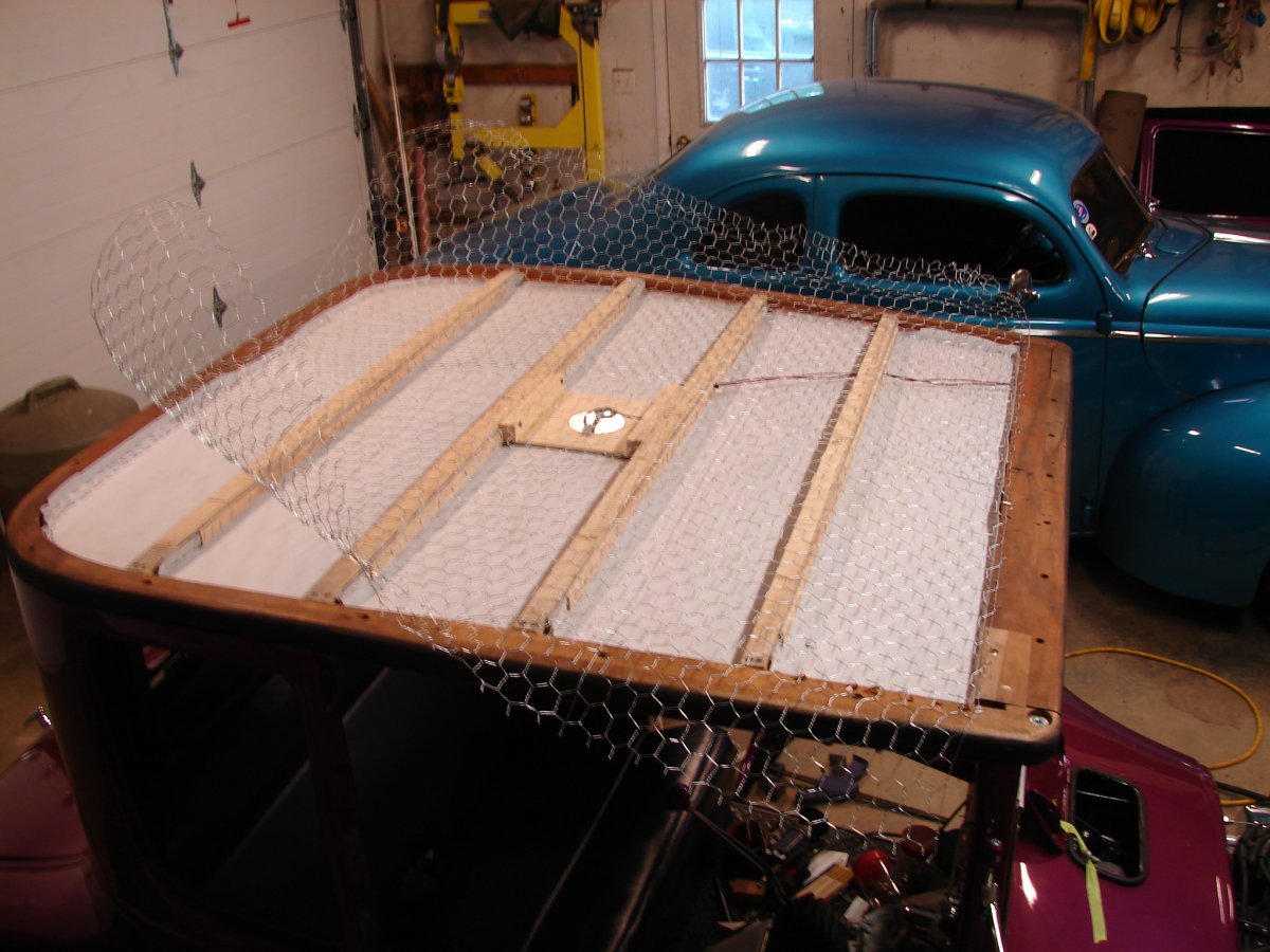

    We put a layer of poly plastic down to keep water from soaking thru the cloth into the car.Just a thought.

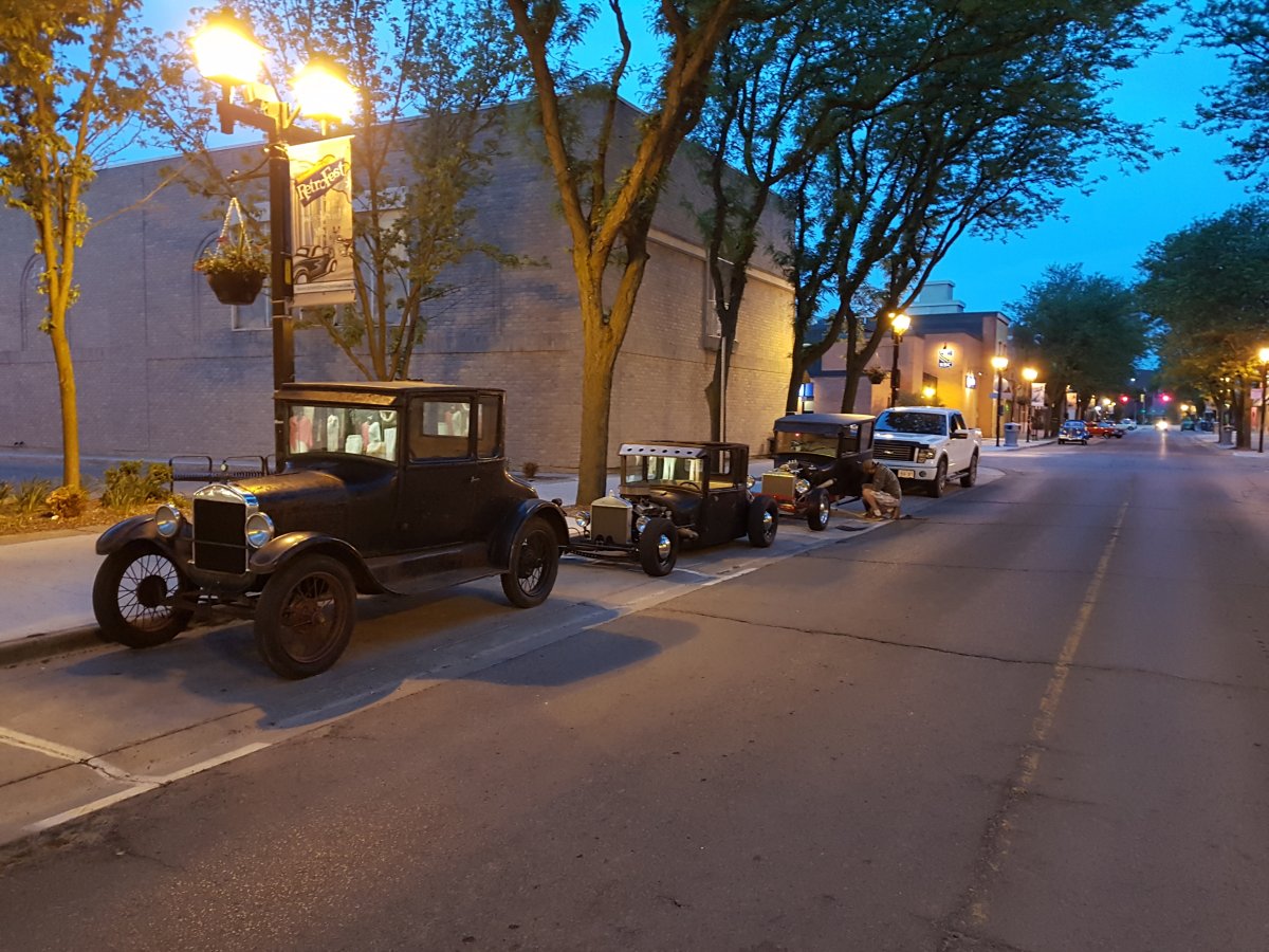

    Here's my '27 T coupes. And my brothers tudor. All un cut. Always changing stuff on the hotrod.

    Nice. I am a 26/27 fan. I don't live too far away if you ever need a hand. I am in Arnold.

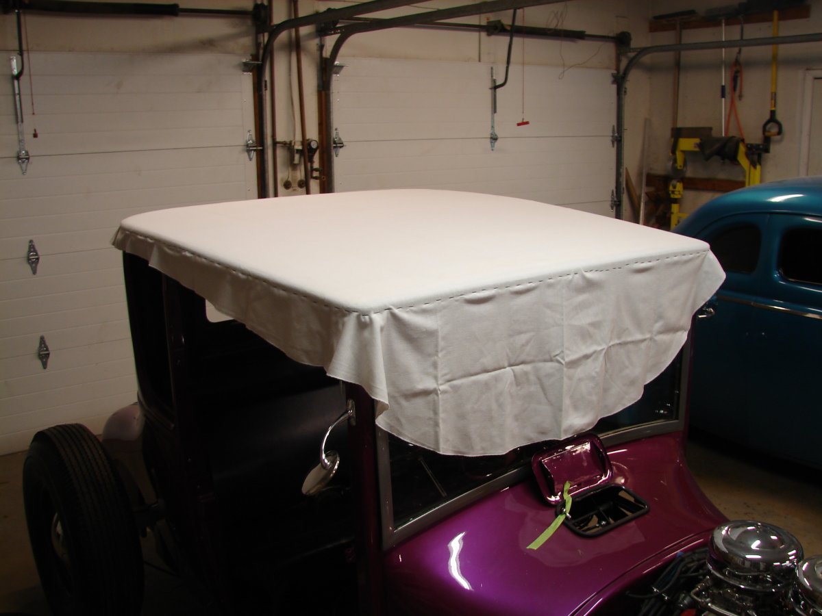

    Hartz cloth is used for convertible tops. It is comprised of two cloth layers with a rubber layer in between. There are no sewn seams, so it won't be penetrated by water. The two yards of it cost about $90, but I believe it is worth it.

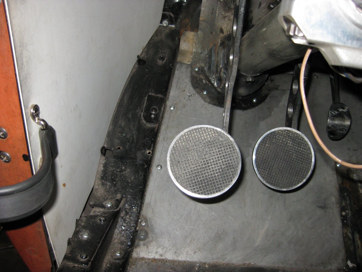

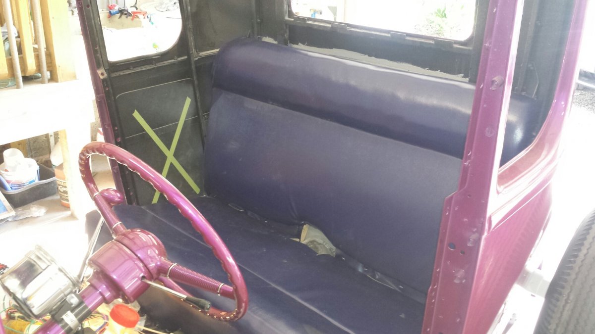

    I installed Model T door check straps and guess what.......It is in the way of the clutch when the door is closed. I may elect to move them up just below the window crank, but I am looking for suggestions. I noticed that '32 3-Window check straps are 10"+ long and have a "T" end. It appears that they may retract inside the quarter panel. Is anyone out there familiar with these and can take a picture of how they are installed? HELP!!
    By the way, I'm getting closer:

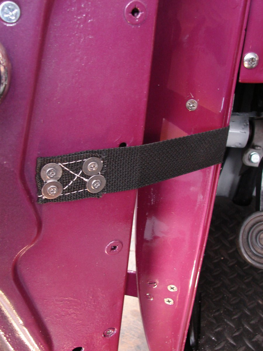

    Beat me to it :D

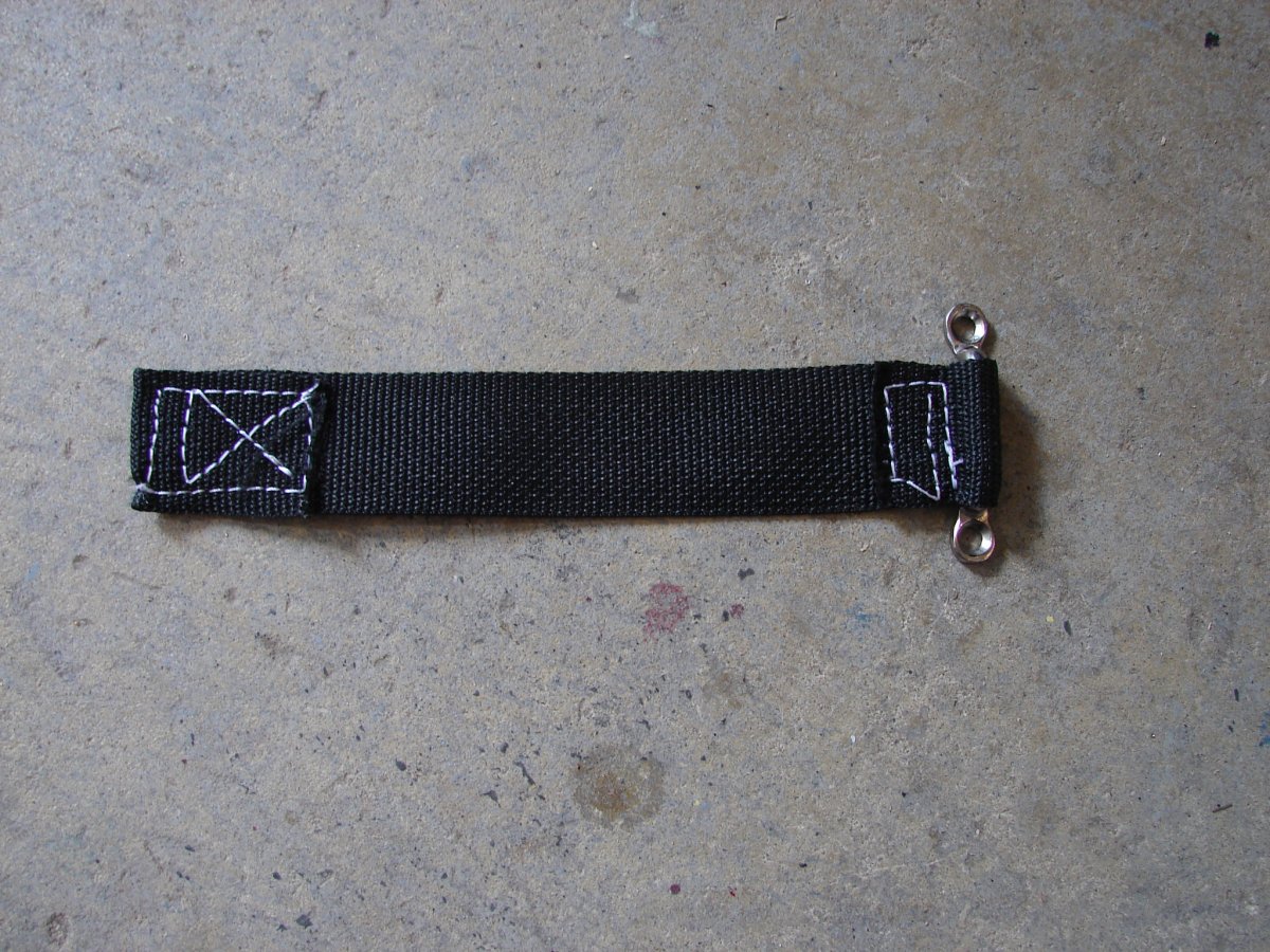

    I fabbed mine up with the heavy duty 1” webbing and the fender washers the spring retracts them behind the kick panel.
    Clean and simple. :cool:

    That's slick. I like the track idea which serves as a stop (could be adjustable if need be). I'm thinking I could bolt it in to the door jamb and create a surface to mount the kick panels at the same time. Interestingly, I found this article online where Hot Rod Garage did a similar thing on Ray Bartlett's Deuce Roadster...maybe it is too sophisticated for us T guys....It was in SRM in 2012. HRG is about 25 miles from me.
    https://www.hotrod.com/articles/1204sr-retractable-door-straps/
    I like Blue One's solution better!
    This HAMB stuff is ALL RIGHT!

    Well after whining previously about l IMG_1066.JPG ack of footroom and looking at your door check straps, I realize I got lots of room in mine. Looks like Blue One has hit upon a good idea but how will you get around your cowl steering support?

    I agree that the steering mechanism will interfere with an easy solution to hiding the straps ala Blue One. So instead, and in the interest of not using up too much time before I must get this car done, I came up with a much simpler solution. I moved the strap up to just below the dash. I used black webbing I got at the local hardware store and sewed a loop in one end for the stock bracket, which is mounted inside the door jamb with flat head bolts thru the jamb. At the other end of the strap, I doubled up the webbing and sewed it in a pattern to strengthen it. I then used 4 sheet metal screws to hold it in place at the door end. The green tape in the picture simulates the door panel which will force it to form a relatively small loop when the door is closed. Sometimes the simplest solutions are the easiest and best.
