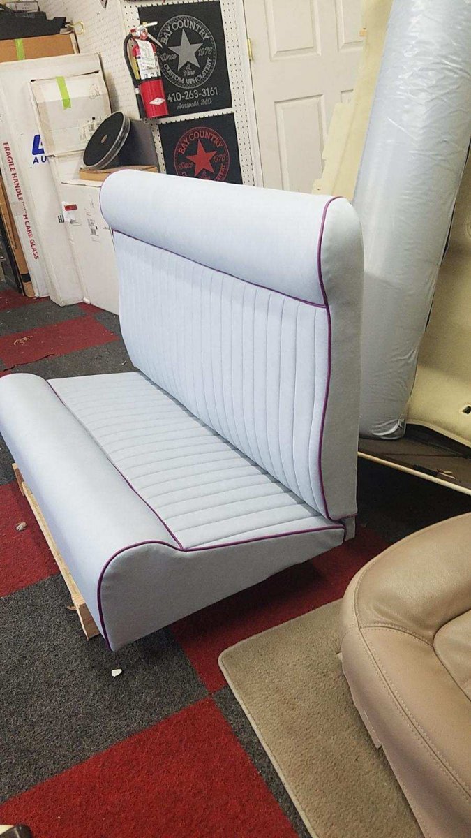

    I have the grandkids coming on Saturday and still scrambling to finish the upholstery before they get here. Hitting the road for the Salt 2 days after they leave.
    An upholsterer in Annapolis was supposed to have the seat upholstered by the end of last week. It turns out that he was leaving on vacation on July 21, so he had to finish it before he left...he pulled an all-nighter on Friday and sent me this pic Saturday morning:
    He did a nice job, but the pleats were supposed to be plum vinyl I had bought through him! And he used up all the gray vinyl I had left with him. So I had to change plans big time! The gray vinyl was a roll I bought along with the used Juki sewing machine got about 3 years ago. It is no longer available!!!
    Luckily, I had cut material off the roll to do the headliner and door panels, etc. Now I am scrabling to find enough material to finish the whole thing. Really tight on being able to have enough to do the kick panels. I am really pissed!
    To further complicate things, I had planned to do the door panels as a gray field with a pleated plum raised panel. With the seat all gray with only plum piping, that would not work. so I came up with an alternative that reduces the amount of plum showing.
    Back in 1980, I upholstered 40 COOP in black vinyl with a Ford emblem on the door panels, that my late mother-in-law needle-pointed for me. In its present configuration 40 COOP would not look right with those emblems, so I saved them in the attic.

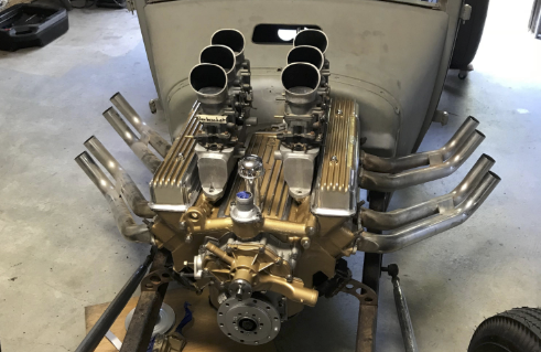

    Got a chance to fully detail my motor this weekend. Painted the block in primer, then VHT Universal Gold. Replaced the water pump, timing chain cover, and fuel with new parts form Nailhead Buick. Polished Fenton VCs, and polished Vally cover also detail painted Universal Gold. Swapped all bolts for polished stainless bolts from Alloyboltz.com. Dropped the oil pan and repainted in Aluminum high-temp. Buried all my paint in hi-temp clear. Chased all the bolt holes with taps and used blue thread block when replacing the old bolts. Followed the revised torque specs that came with the SS bolts.

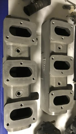

    Researching thermal coatings for log the intake manifolds, Zoomie style pipes and carb bodies. Which leads me to the intake I scored off of San Antonio Craiglist on Friday. It's an old-school Eelco and came with all linkages and six carbs. I spend the weekend hot tanking and scrubbing the intake, cataloging the linkages and taking loads of reference shots before tearing it down.
    Strombergs here we come. Ouch.
    I'm putting spending on freeze. Time to finish fabbing the floors and getting the driveshaft sorted. And rebuilding or replacing the Turbo 400. It never ends.

    Mock up. VHT Universal Gold with loads of ultra high-temp clear.

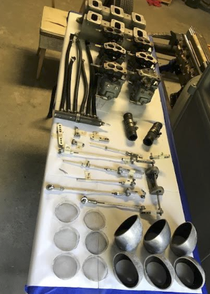

    Eelco 6X2 "before" shot with all linkages attached.
    Screen Shot 2018-07-30 at 11.27.31 AM.png Screen Shot 2018-07-30 at 11.27.45 AM.png
    After hot tanking and scouring.
    Cataloging.
    Clean and stripped down.
    The whole enchilada. Dis***embled.

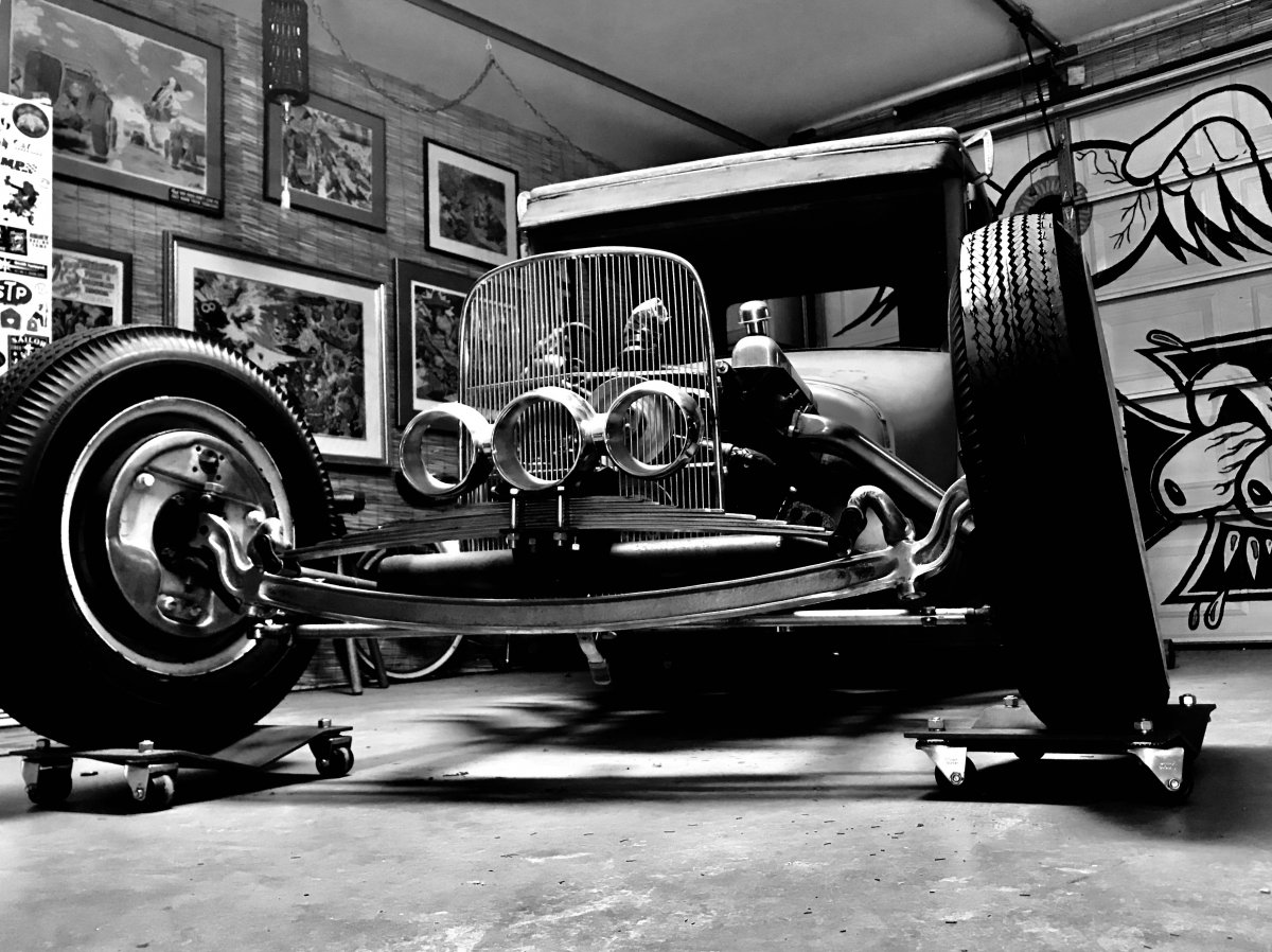

    Arty shot. Still thinking about a three headlight set-up. Who knows?

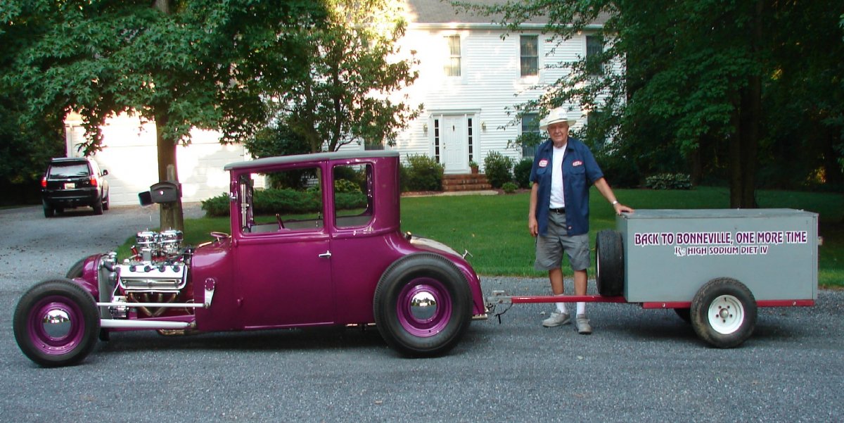

    Been driving 26 COOP around as much as I can and it tracks well, is fun to scoot with the hemi/5-speed, and gets some laughs with my arm hanging out the rear quarter window ;);):confused:
    Been packing the trailer:

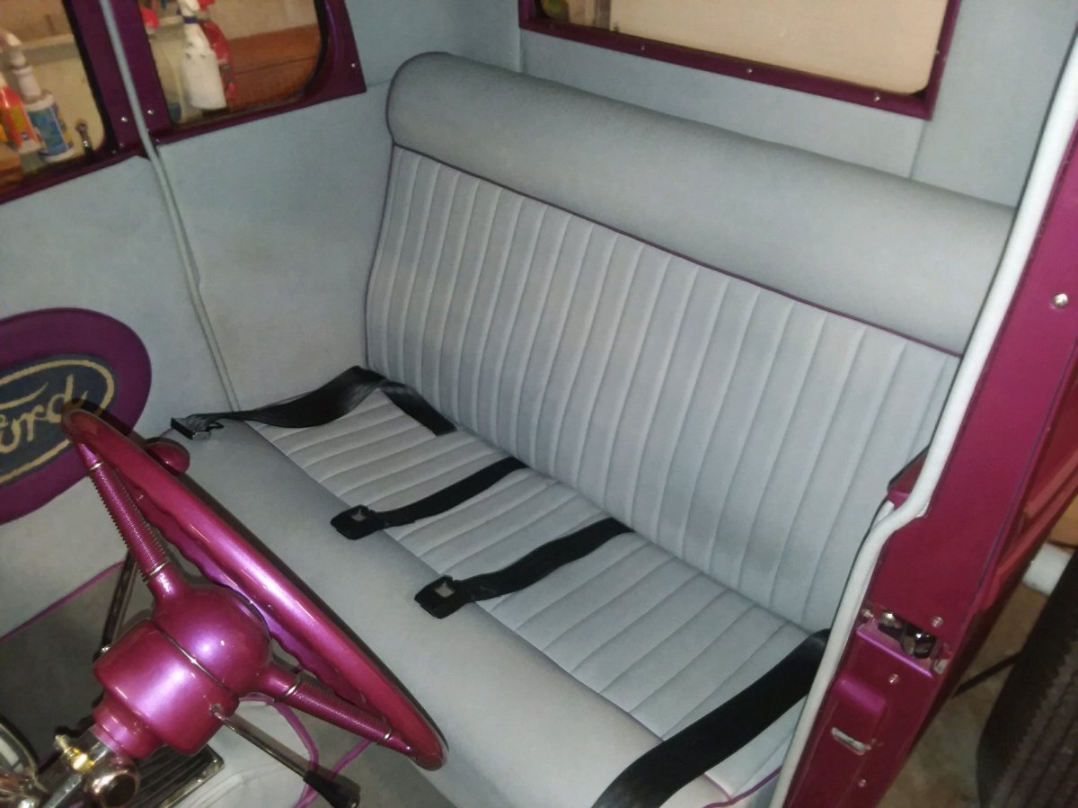

    Here's a pic of the interior:

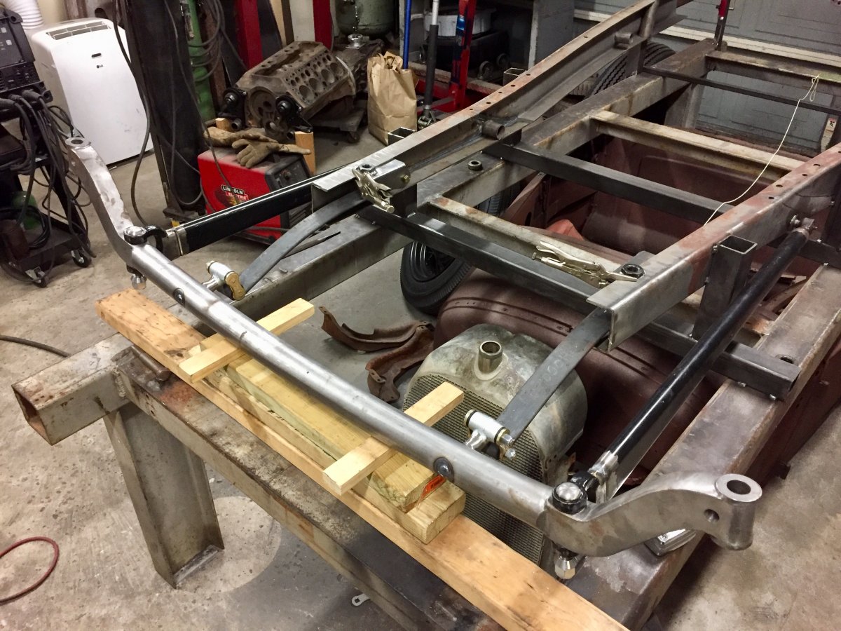

    I like how this is coming together. What's the story on the front axle? Are you building that? I'd love to have more info on it.
  17. Anderson
    Joined: Jan 27, 2003
    Posts: 7,558
    Anderson
    Eric Carter, Carter Speed & Machine is making them. Only place I know to find him is on Instagram. The spring hangars are by my hands.

    Been detailing my nailhead. Gold VHT, loads of clear, Fenton VCs, PMS valley,
    cover, new timing chain cover, water pump, and stainless steel polished bolts,
    6X2 Eelco intake.

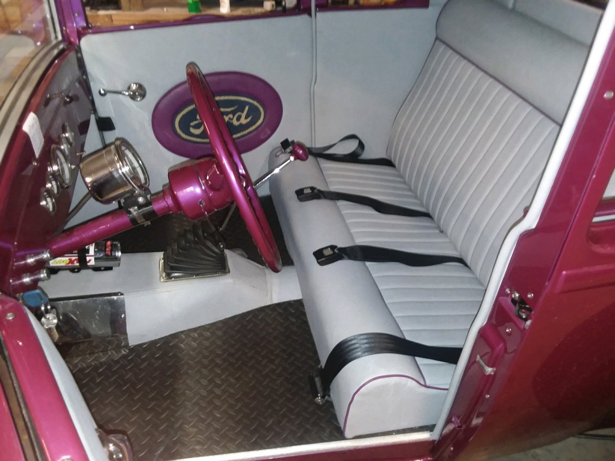

    I finished 26 COOP by removing the rubber floor covering I had for ease of cleaning at the Salt and made the carpets and mats:
    Before:
    After:
    All done!:D:D:D
