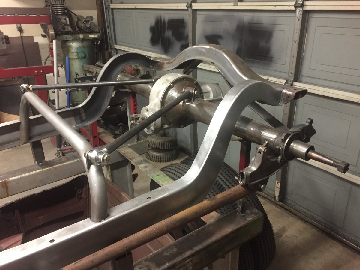

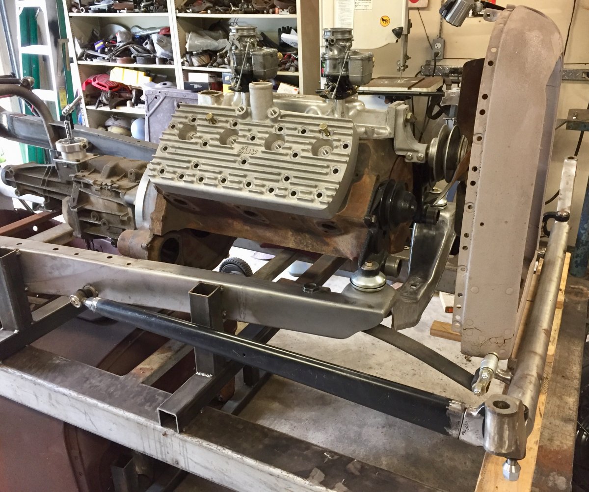

    Getting the suspension set up and drivetrain mounted.
    5F8A2225-7048-4B0D-9C17-841DCBA853C4.jpeg 2000225B-04BB-4A85-8B6F-DC54DDE87FFD.jpeg

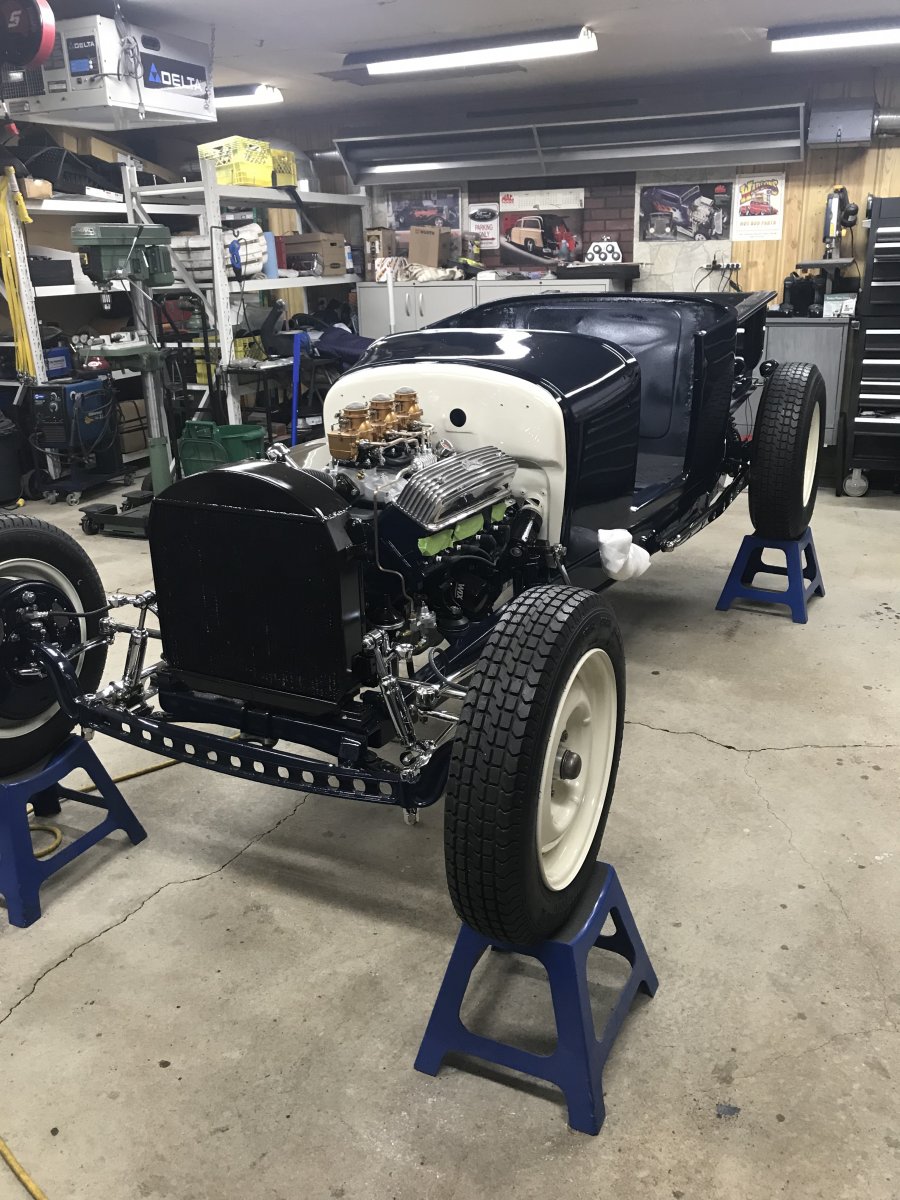

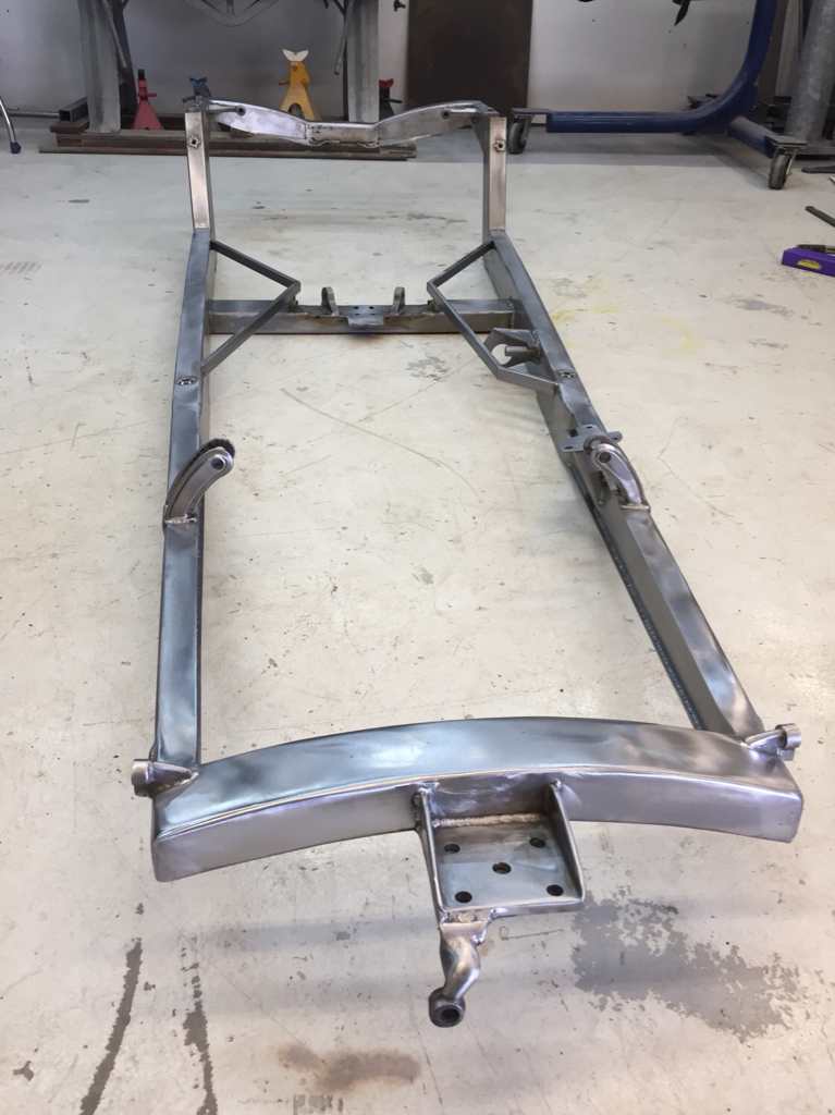

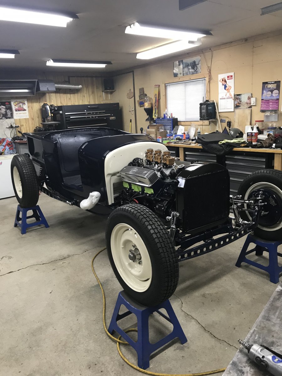

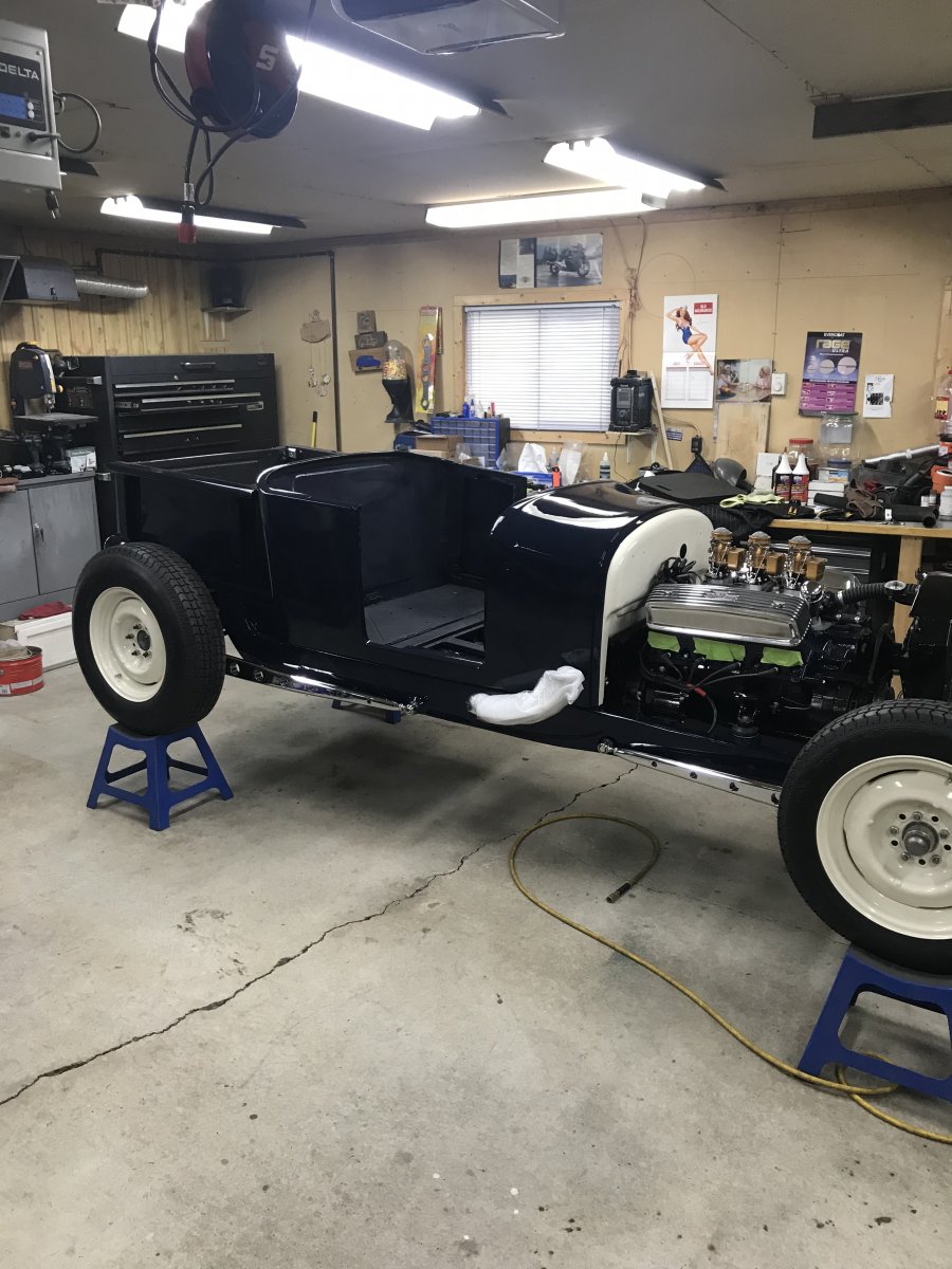

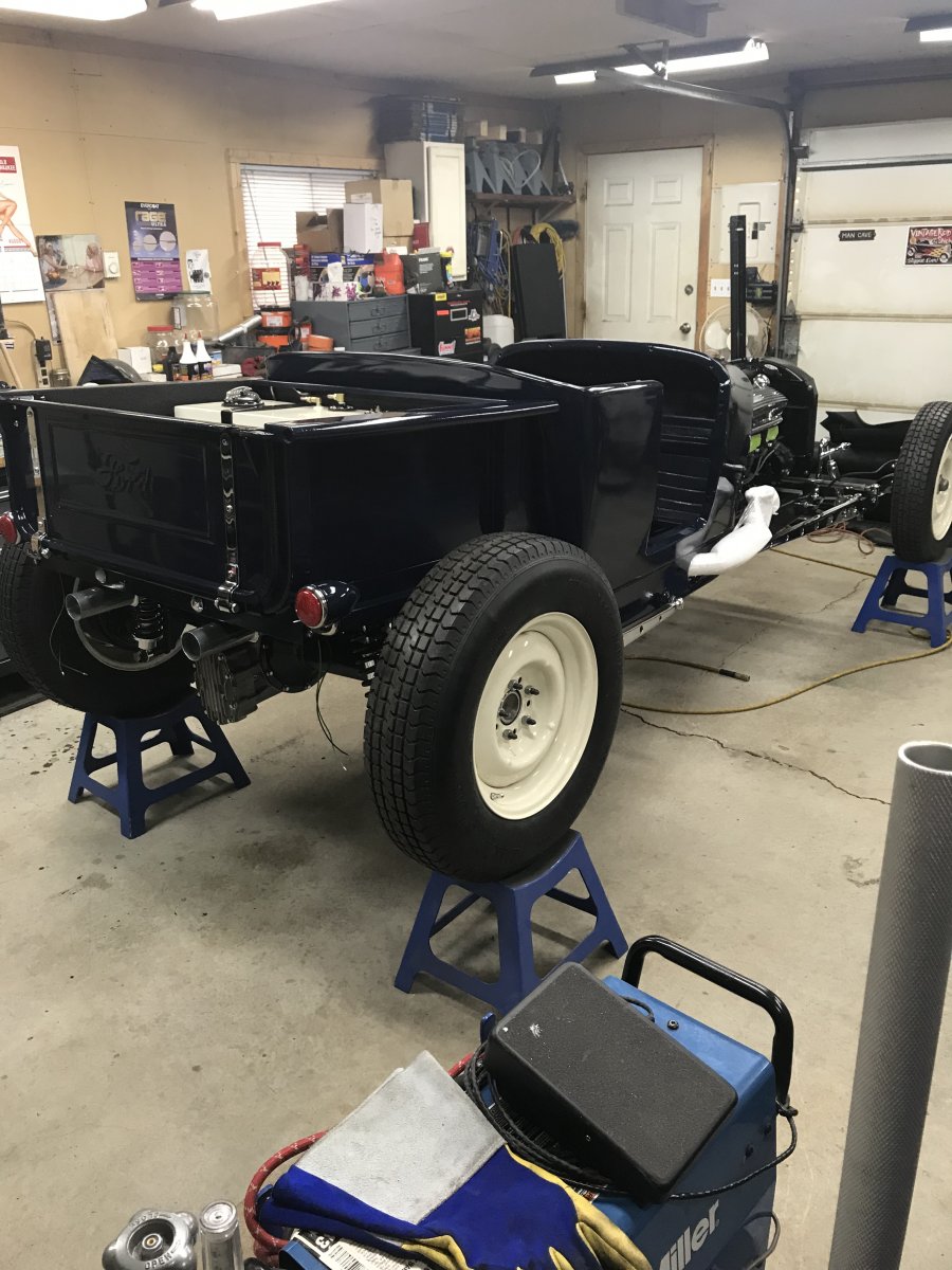

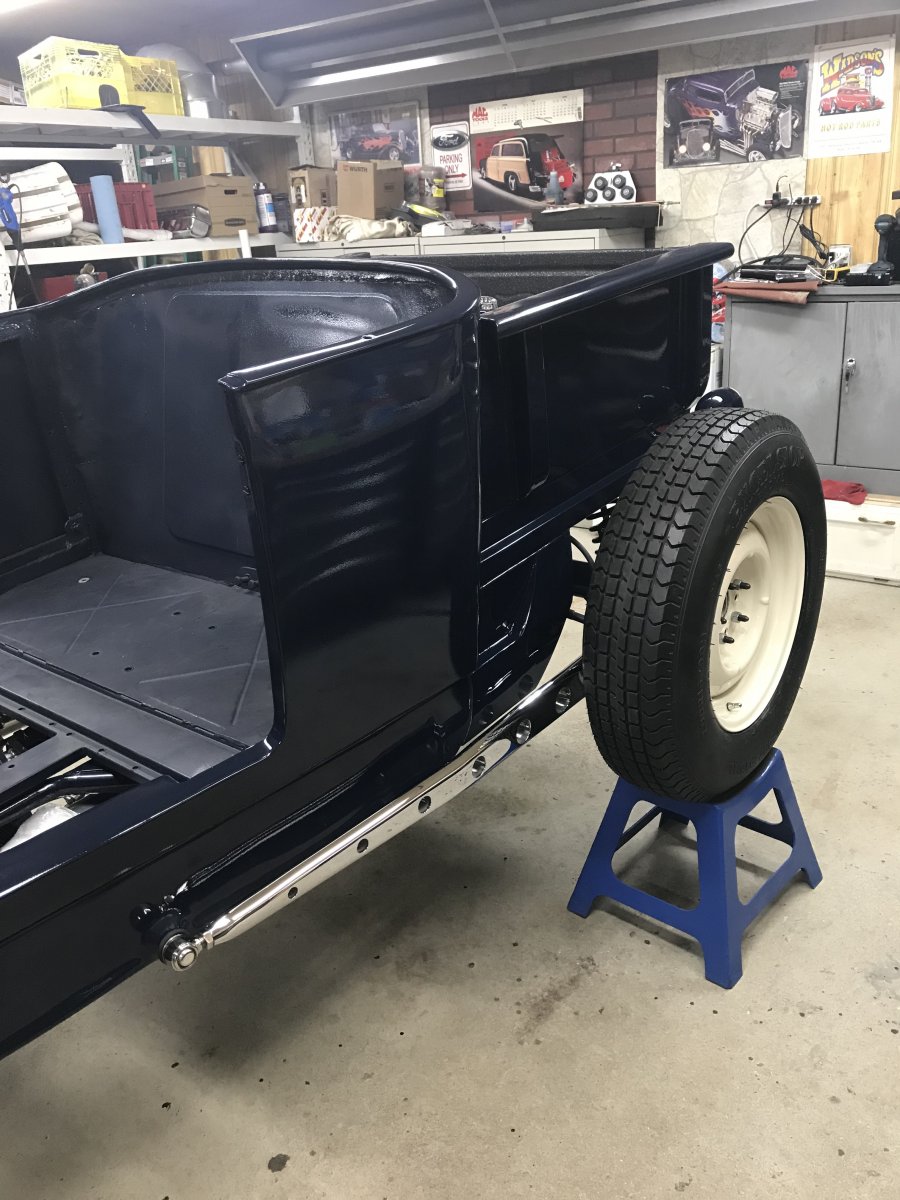

    Mine is coming along.
    1F20459B-64C6-40E0-89D6-CECD5E38363D.jpeg 08AABB9F-D3D1-4C1C-82CB-A6D98B321256.jpeg 9C09F27D-9A5E-4E66-A8C5-0EF65807BC3F.jpeg 9D05DB08-A678-4911-B0BA-787AC5AA30B1.jpeg DC3ACCB1-AFE7-44DA-BC6B-F9CA8DC1E5CC.jpeg

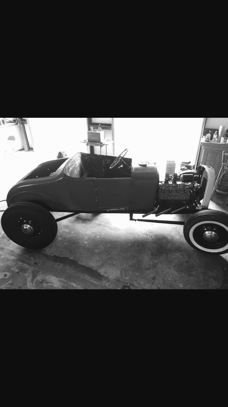

    [​IMG][​IMG] mine is nearly a driver finally. Hopefully will fire it up this weekend god willing

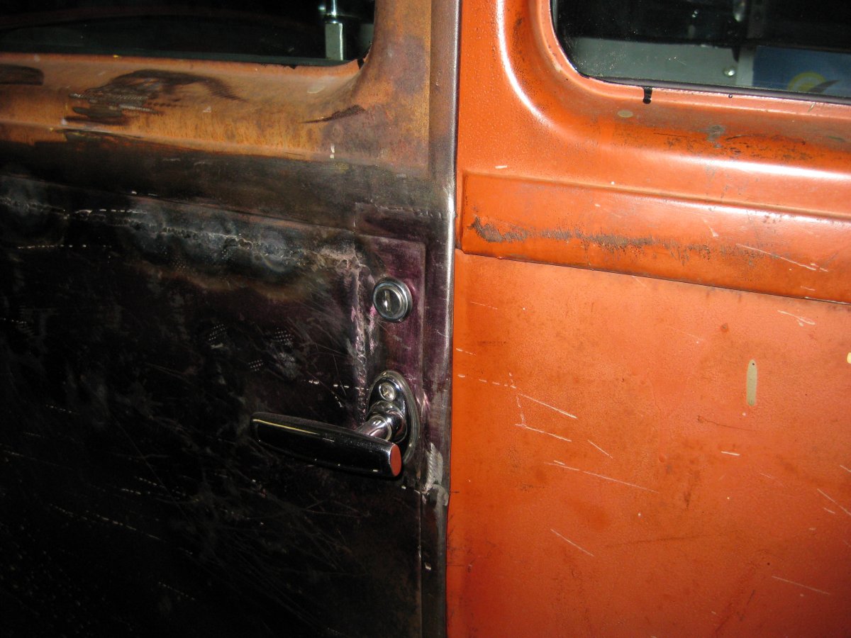

    Does anyone else out there have a left door with a lock cylinder in a T coupe or sedan? I found a really decrepit door that had one and had to graft it into my car. I have never seen another like it. I remember seeing Canadian T roadsters and touring cars with opening left doors since Canada also supplied car bodies to the RHD countries, so is this another example of this kind of practice? With this car being over 90 years old, I'm certain that none of us has first hand experience with these cars when they were new, so what have you bidding archeologists unearthed? IMG_1121.JPG

    That’s not original model T parts, looks like old hardware store stuff.
    Or possibly from some newer vehicle.
    T s never had door handles or lock cylinders like that.

    I'm talking about the door sheet metal, not the repro lock cylinder.

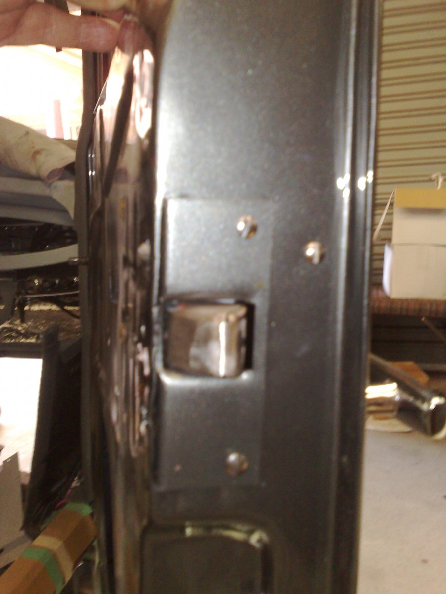

    I duplicated a lock onto the drivers side door as part of my T build.
    It was not that hard, but just need to attach a reinforcing plate inside the door and drill a small tapped hold in the end of the door for the barrel lock screw.
    Precision drilling and alignment is required, but slow and easy with double checking will win the day...
    So no good pic's, just what was found by accident.

    Not claiming to be an expert but I have never seen a T door or sheet metal with any kind of provision for anything but the door handle.
  19. Closed 26/27 had a door lock on the nearside. Dunno about other years.

    I don't recall all the details now, but the inner support panel that is required, I used some sticky panel sealastic stuff to set it in place, as I could not spot or tack weld it for fear of damaging panel work and primer.
