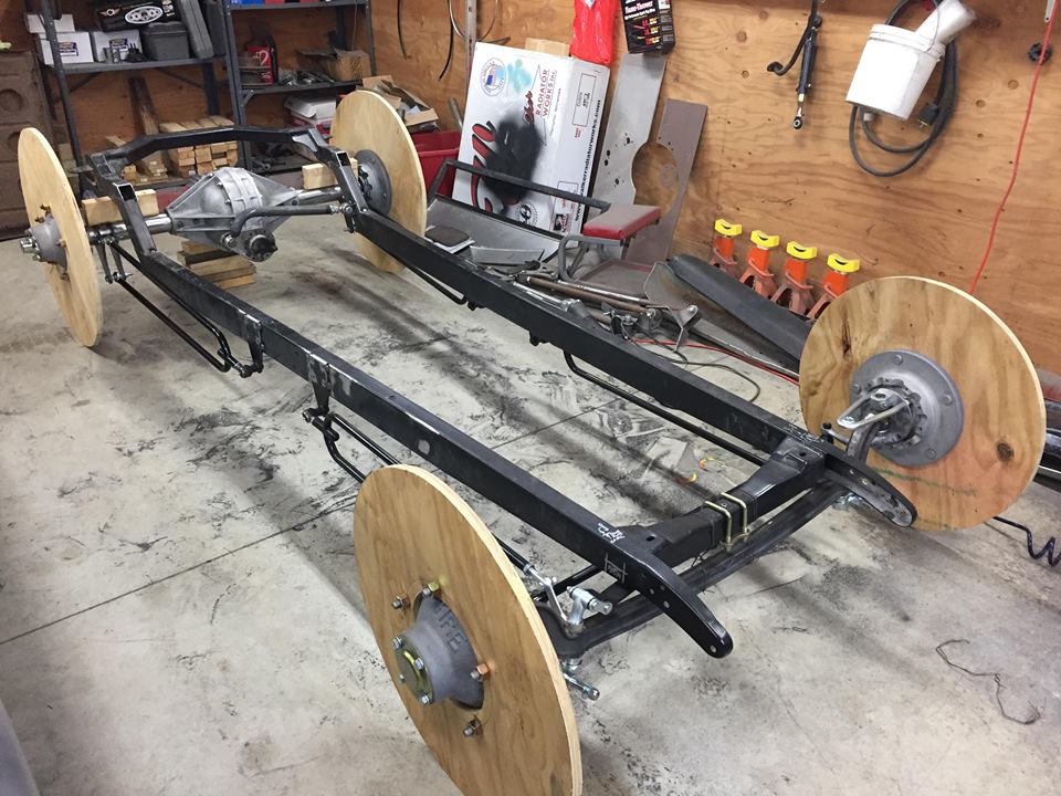

    reminds me of when mine was coming together

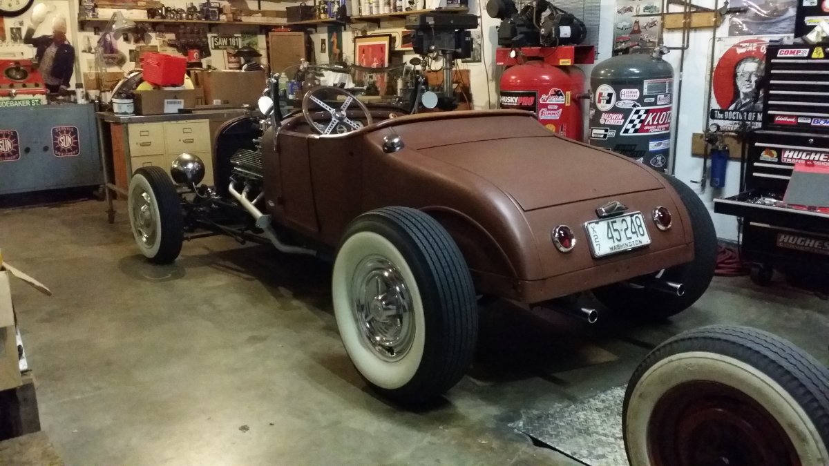

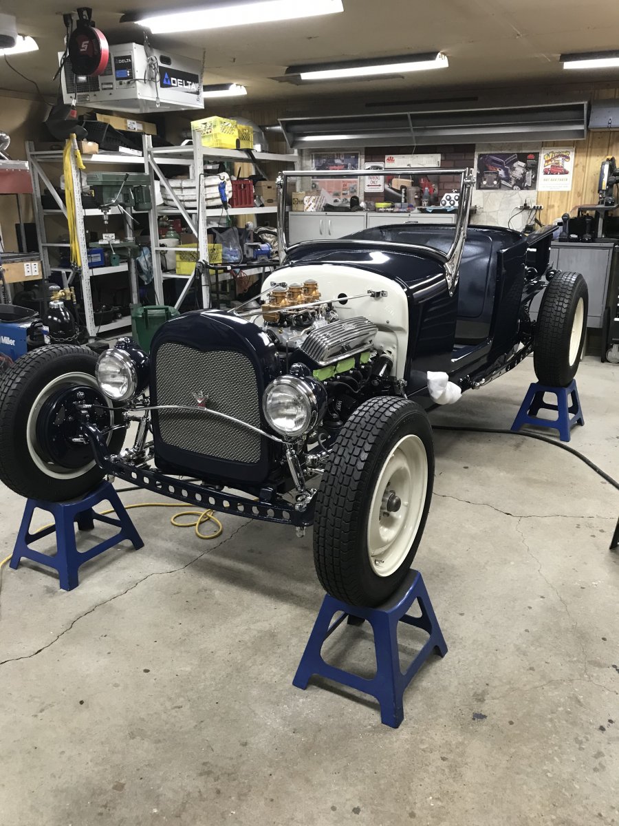

    I wouldn't say "finished" although I have put a few thousand miles on it.

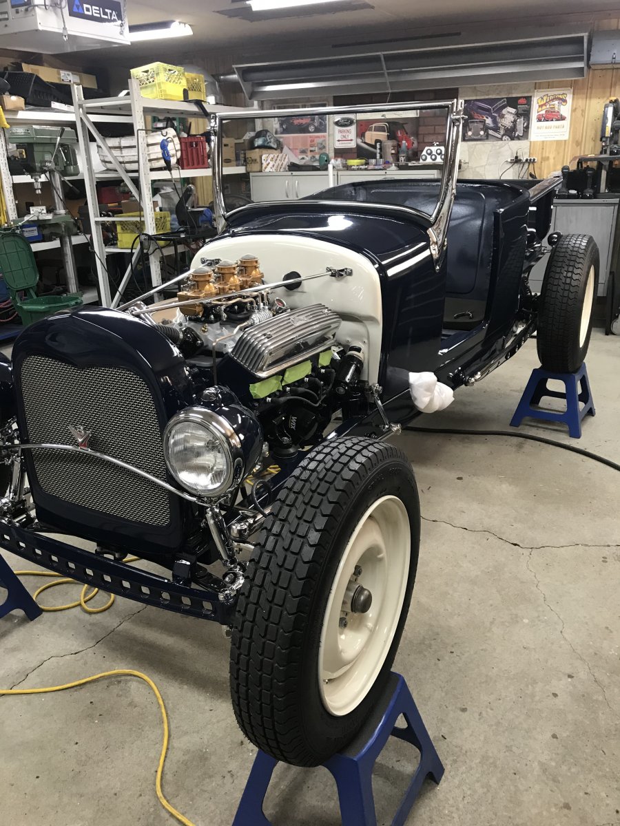

    This is what it looks like now,
    waiting for the sun to come out so I can stretch it's legs some more

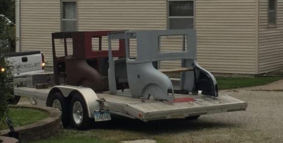

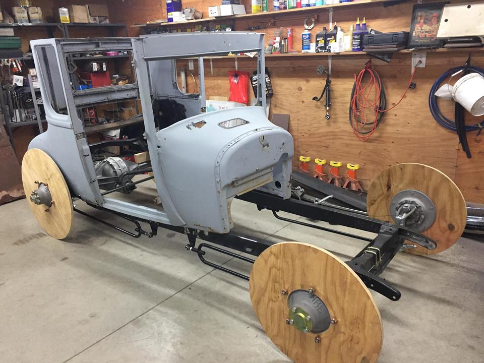

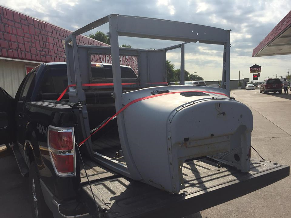

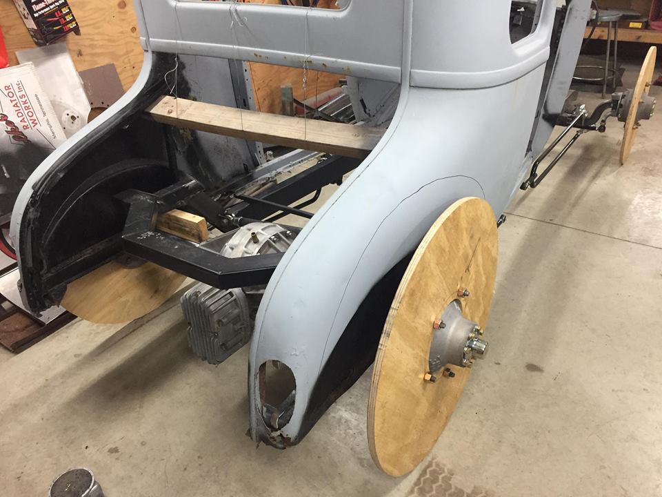

    Doing a '26 coupe as a dirt track modified style build. Wide 5 hubs, Frankland quick change, will have a roll cage, keeping it really basic. The body is just sitting on the frame in the pictures (will be 2.5" channel in front and 1" at front of back tires). Tires and wheels will be 5.00-16 ribbed fronts on original Ford wide 5 wheels, rears will be 11.00-16 diamond tread on wheels built with new hoops and original Ford centers. Engine is undecided. One piece hood top and stock 23 grille shell. Have 2 bodies to combine to make one nice one along with a few patch panels. Sitting on a Speedway Model A frame I kind of inherited in a deal.
    SPark
    roller1.jpg mockup10.jpg mockup11.jpg 26T Body2.png kingston1.jpg bodies.jpg spindle2.jpg W-5d.jpg Wheel1.png

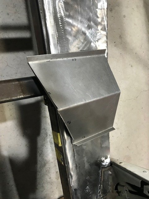

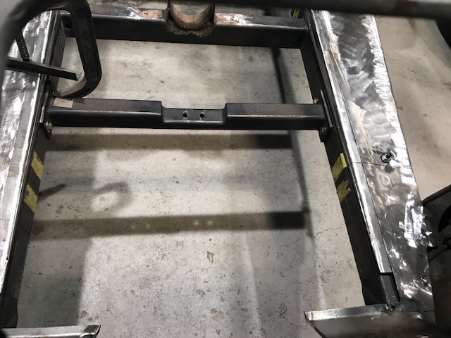

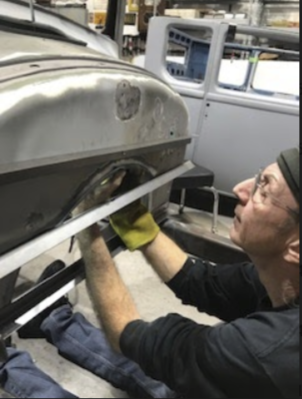

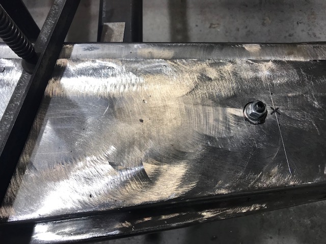

    I'm pleased to report that after a prolonged coma, my T is now at Mercury Charlie's and we're making some real progress, with Charlie guiding me through the metalwork needed to get the floorboards in. So far, I've fabbed a secondary firewall, the transition pieces from the firewall to the floorboards, rounded the front cowl, boxed the subrails, filled all holes in the firewall, filled all the trim holes, hammered and dollied, welded, and done lots of sheet metal cutting and grinding.
    After years of letting others do all the hard work, I'm knee-deep in learning how to do it myself, thanks to a unique arrangement with Charlie. I wrote his new website and his Rodder's Jornal ad campaign, and he's returning the hours I spent teaching me to use the metalworking equipment and coaching me through the finer points of the build.
    It's been one of the greatest experiences of my life. More to come. Screen Shot 2018-11-27 at 12.38.33 PM.png
    fabbed a secondary firewall to hide wires and offer more heat and sound deadening,

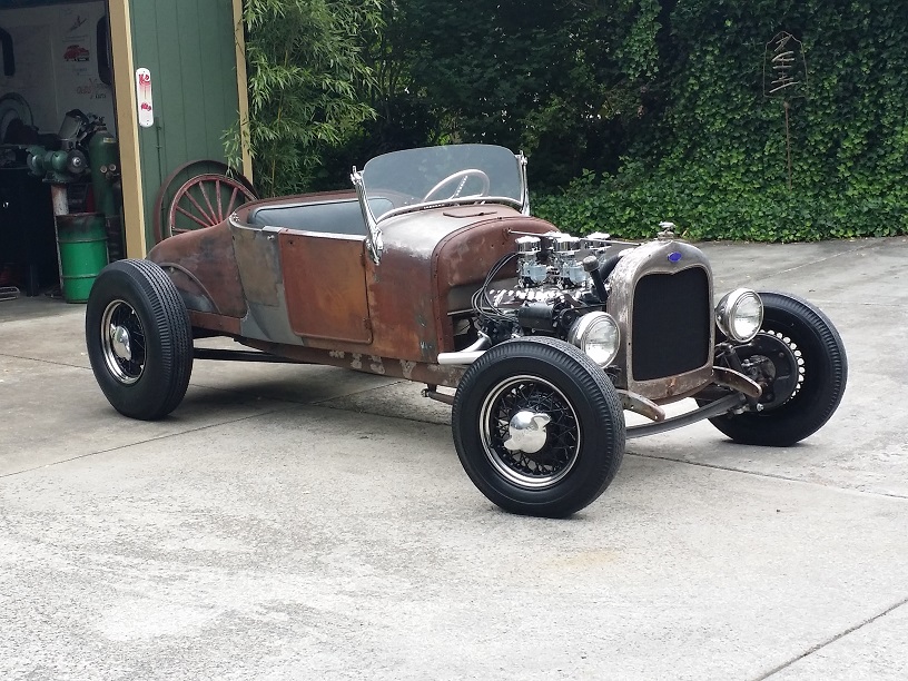

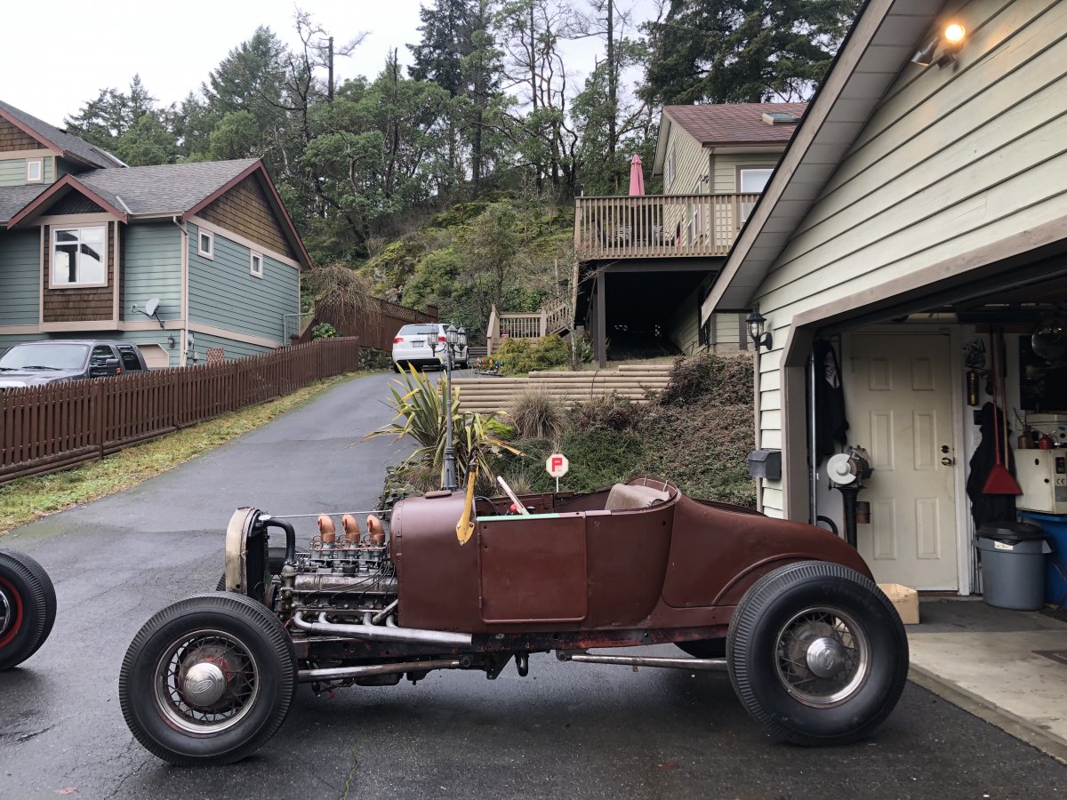

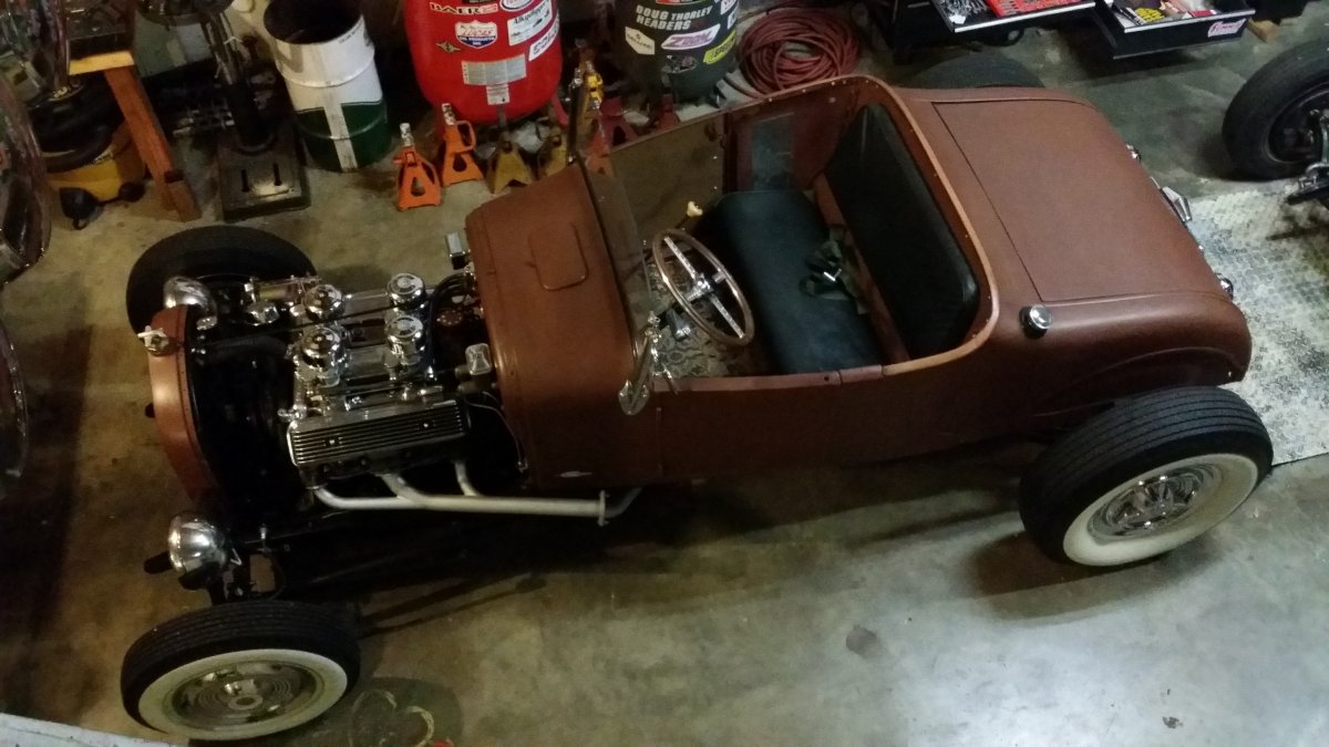

  14. Slowly but surely making progress on mine

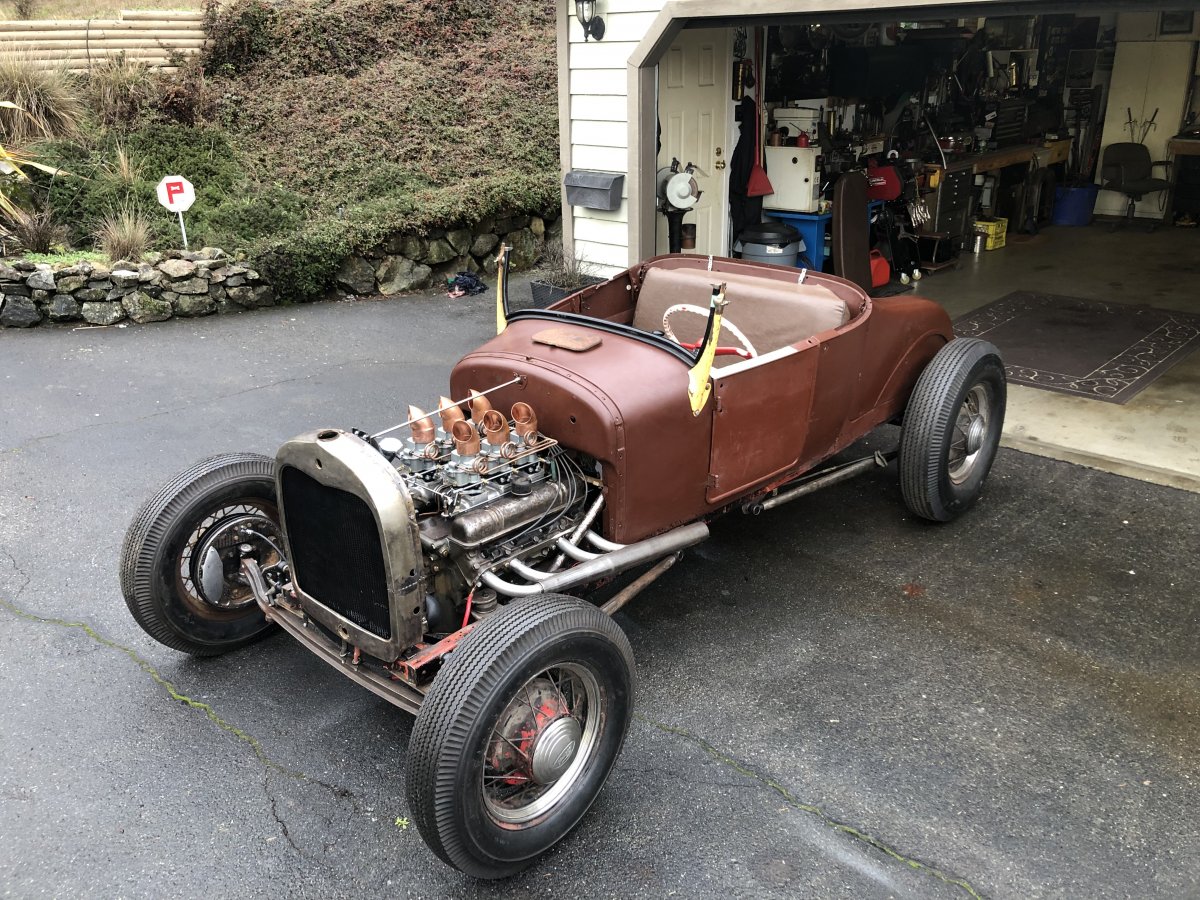

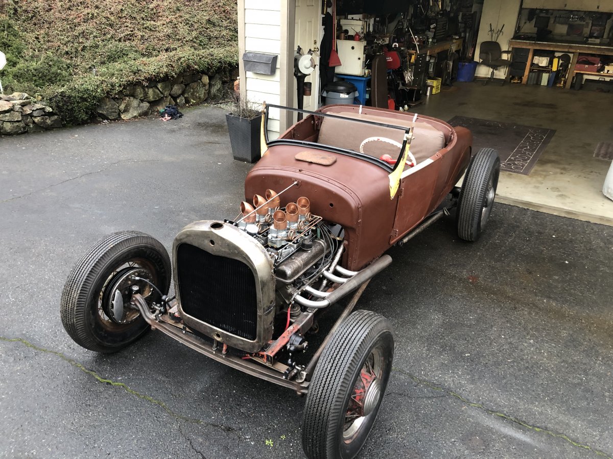

    My $hit box, well what’s left that I have to work with anyways

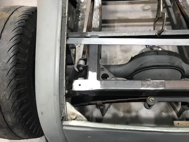

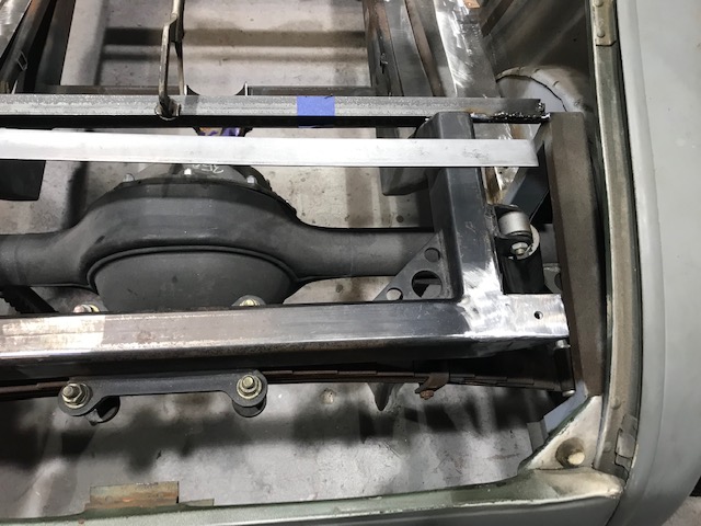

    Inner firewall will allow us to route wires behind it and double insulate the firewall to the keep heat down.
    The rear corners of the frame now have body mounts that I fabbed from 2"X 2" box steel, angle cut.
    We welded 3/8" bolts to the underside then boxed in the angle cut.
    The underside of the bolt heads tap down into two more tabs mounted just aft of
    front door jambs on the other frame.
    Still need to slightly fine tune the inner firewall, but it wll be removable with tabs and thumb screws.
    Another shot of the Mercury Charlie Zee frame. Next, we will be refining the placement of the rear driveshaft loop, having forgotten that the 9" carrier is offset. Doh!
    Here a shot of the toe-board before installation. Five folds in all. Thankful for having access to a box break.

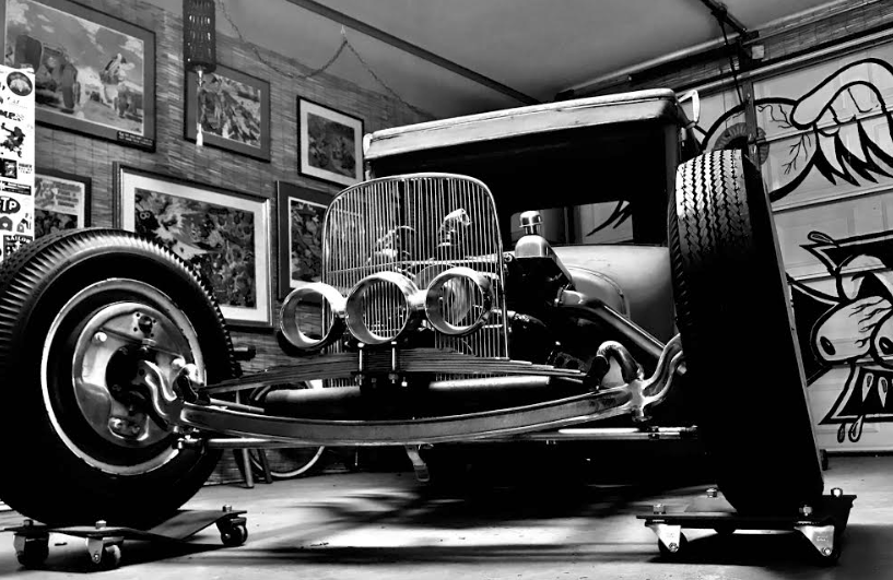

    Still thinking about the three headlight idea. I kinda like it, but it would take a fair share of fabrication to float it of the spring perch.

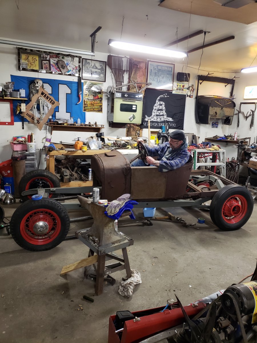

  24. camcrusher
    Joined: Aug 11, 2013
    Posts: 257
    camcrusher
    from Candor, NY
    Been slowly working on it. IMG_20181118_150321300.jpg IMG_20181202_165822704.jpg IMG_20181217_163308050.jpg
    Nothing real special, just using what I have kicking around the shop. Also put a 9" Ford rear in it.
