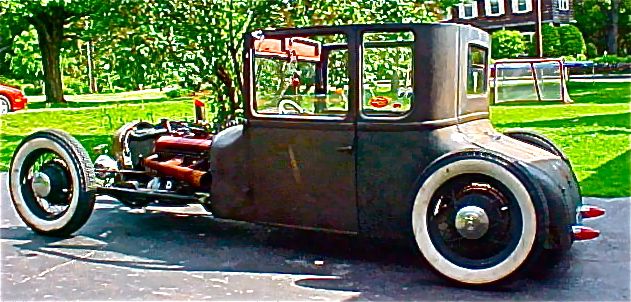

    Mine blown flatty built with a heap of mates....
    Next one T coupster with V12 lincoln motor...

    Cool ride. And an amazing view!

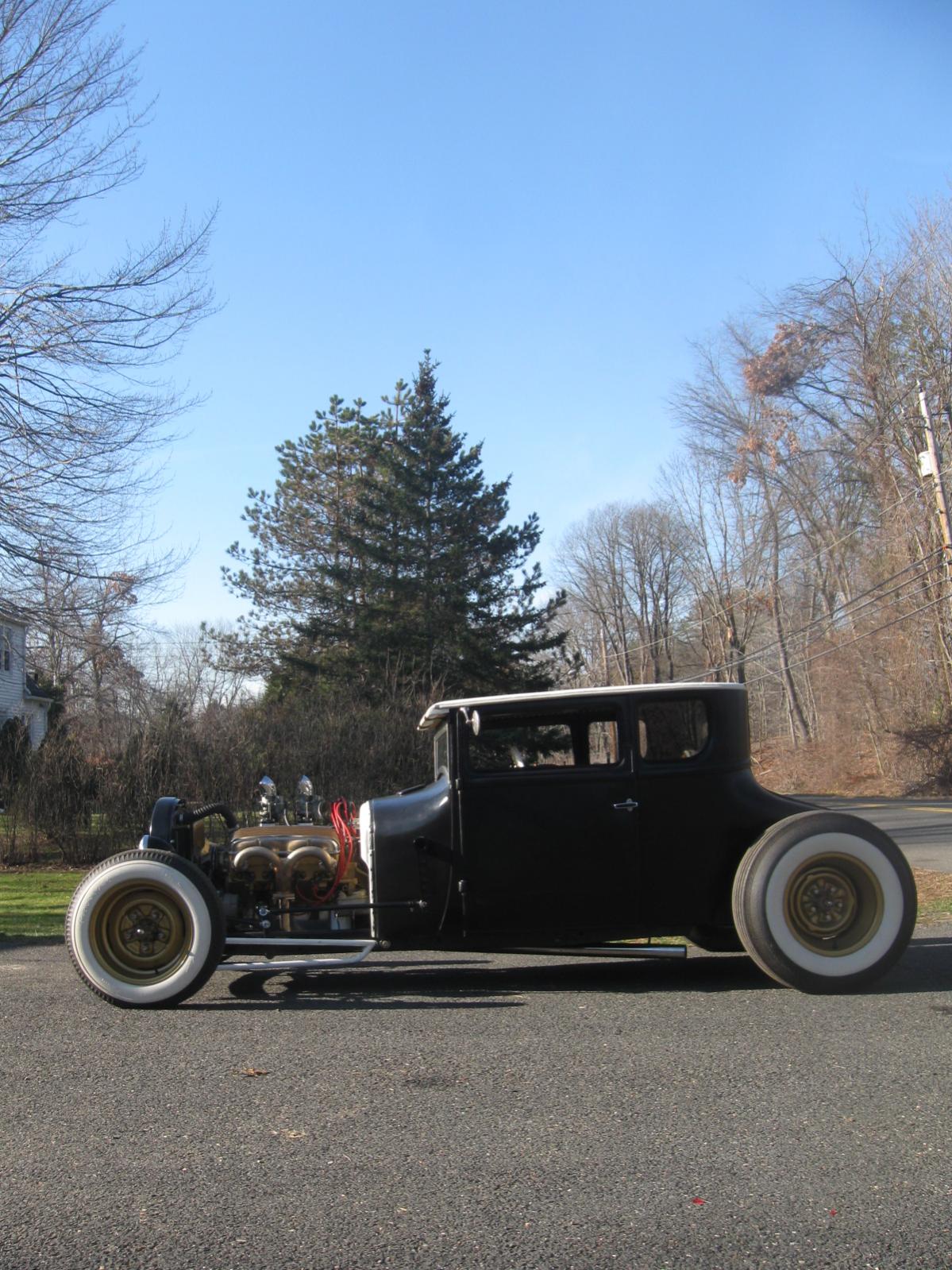

    Ol Skool

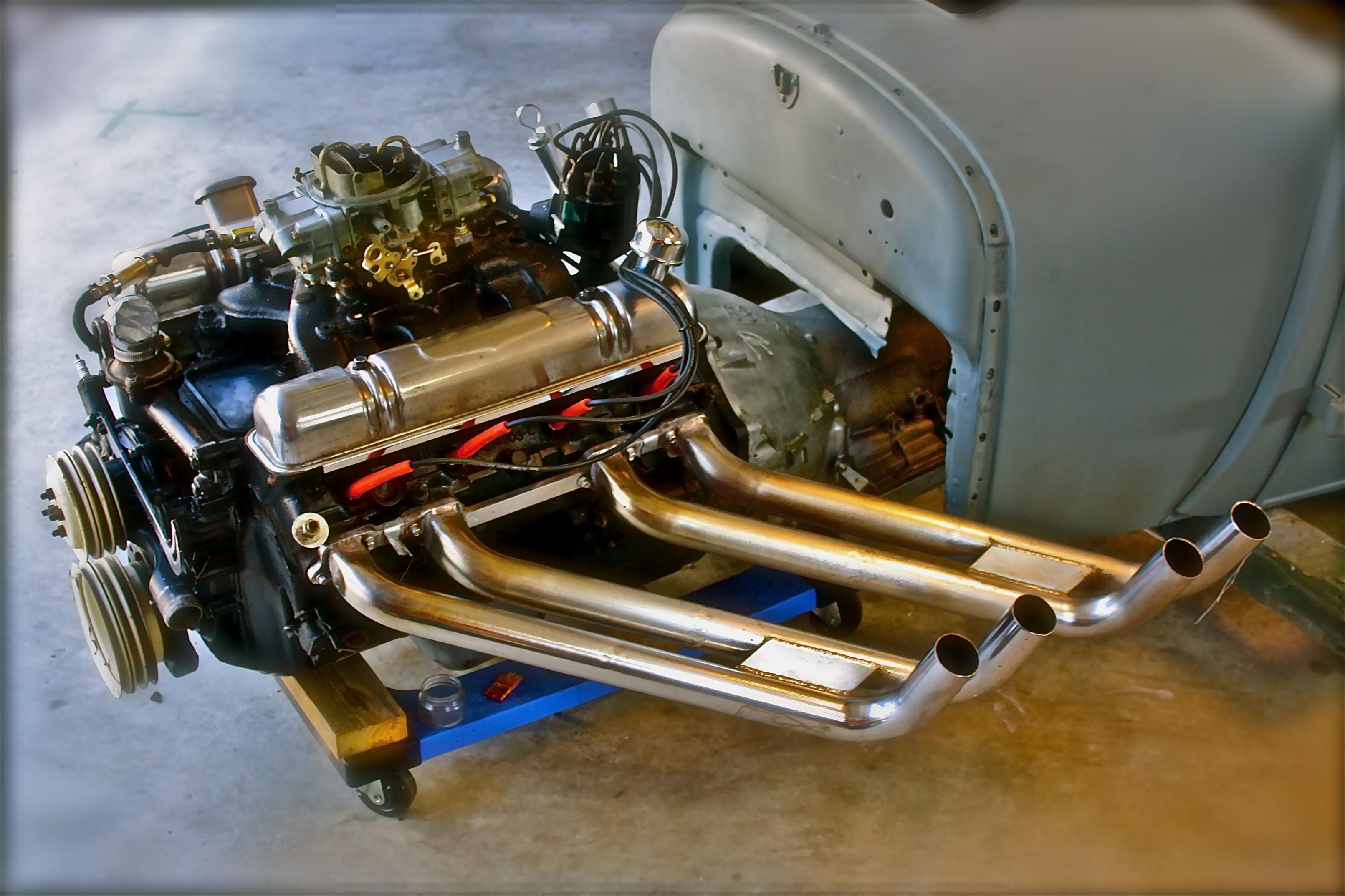

    About to order the 9" for my T. All the suspension parts are in from Pete and Jakes.We're going with a 3.50 rear gear and 10" X 2.25" brake package, all from John's Industries. The rear suspension will consist of a traverse rear '40 Ford style spring and a triangulated ladder bar set up. The 425 Nailhead reaches max torque at 2,800 RPM. With the 3.50 gears and a 30" rear tire, when the Turbo 400 is in third gear, the T should be at the following RPM's at these various speeds: 2352 RPM's @ 60MPH; 65 MPH, 2548; 2744 RPM @ 70MPH; 2940 RPM @ 75 MPH; 3136 RPM @ 80MPH; 3332 @ 85 MPH; 3528 RPM @ 90MPH; 3724 RPM @ 95 MPH and 3920 RPM @ 100 MPH. Should be a rousing ride for a relatively lightweight car (c. 2500 lbs.)

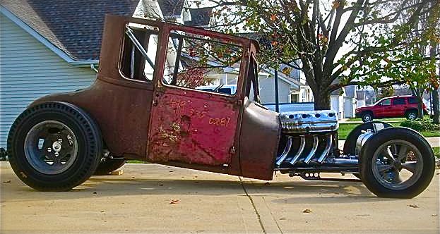

    More re-building than building. I changed a few things this year- new front axle, blacked out suspension (well most of it), chrome shocks, new exhaust, raised the rear, new carb set up.
