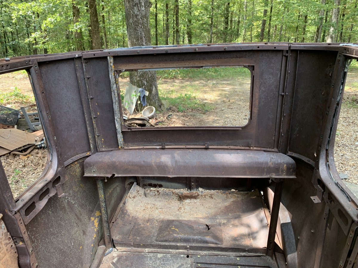

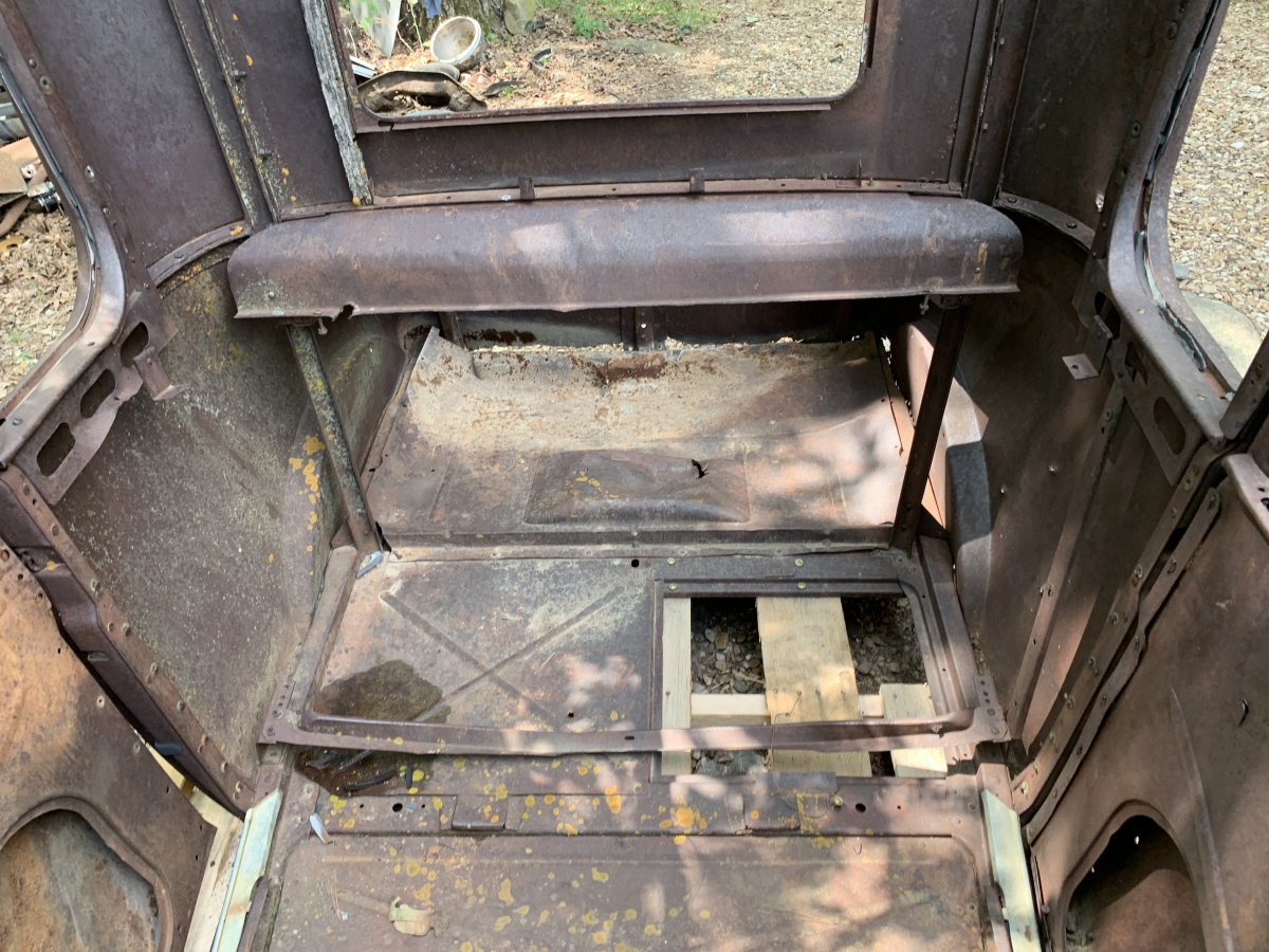

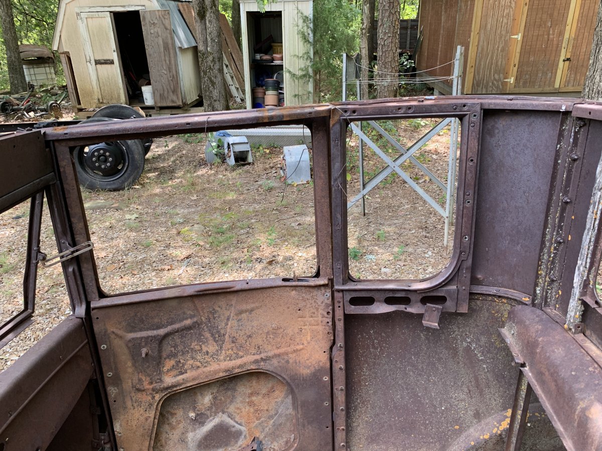

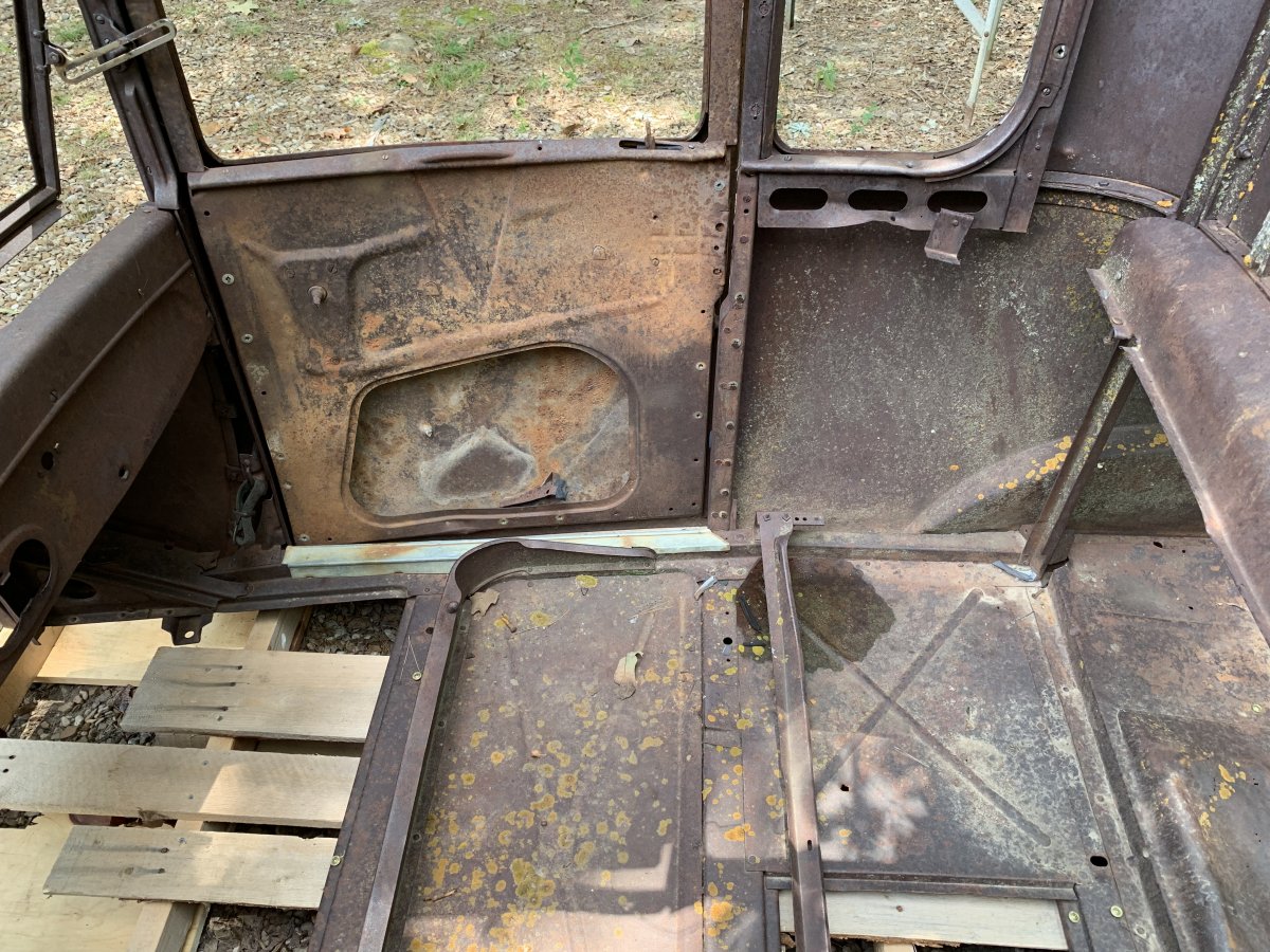

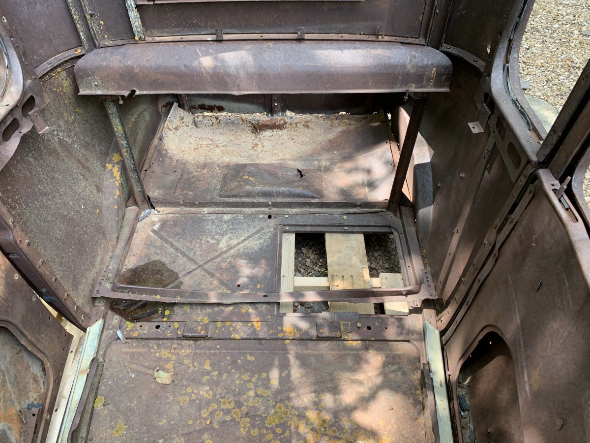

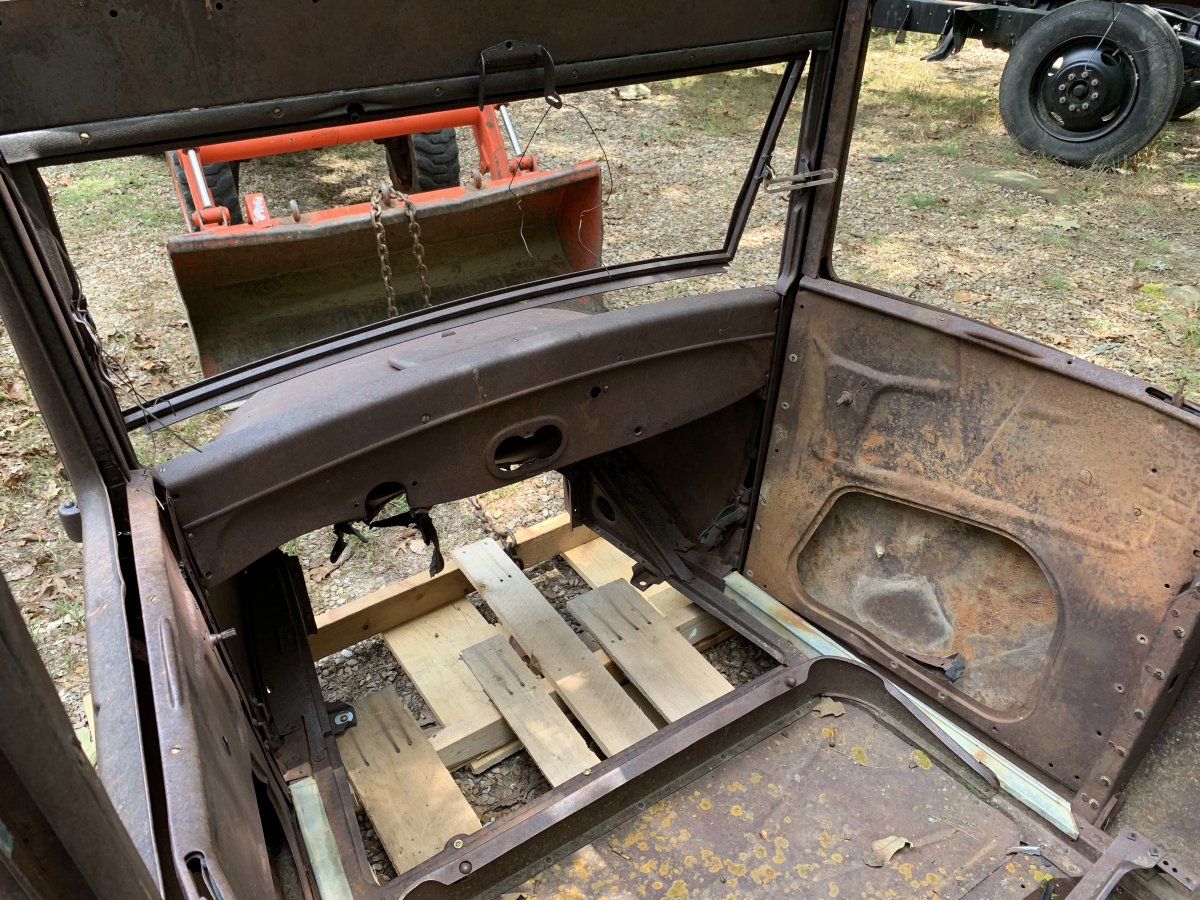

  2. robert4005
    Joined: Jul 14, 2009
    Posts: 48
    robert4005

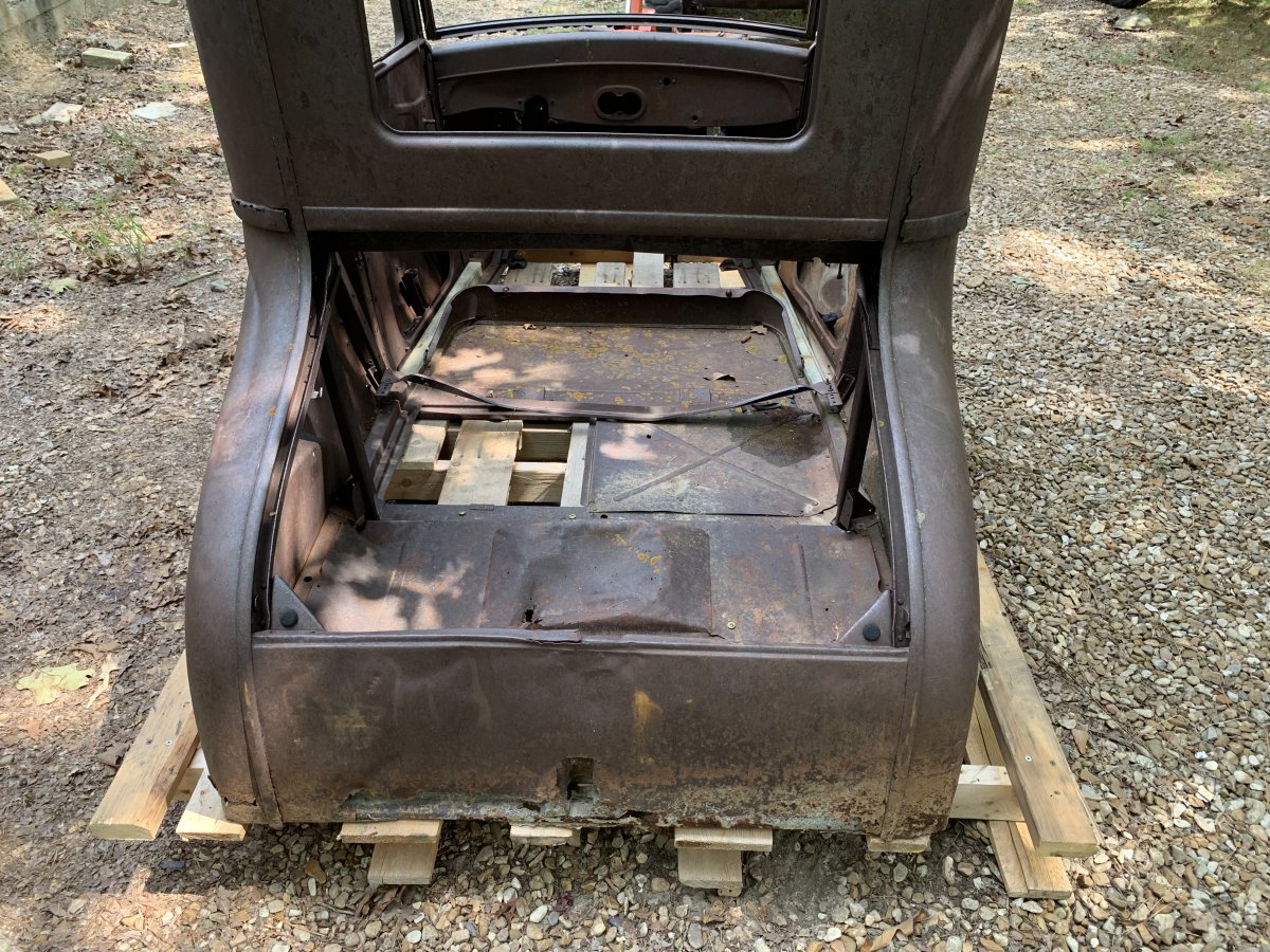

    If you’re right and I think you probably are I’ve got a 27.

    All you get from Howell’s is the outside skin. From what I understand the fit is pretty poor so be prepared to do some work to make it fit. I plan on making a skeleton for it with square tube maybe some angle. There’s an original one on eBay right now ,that’s the second link I posted. The 3rd and last one is an eBay listing from Howells, that’s how I got mine. I understand when you deal directly with them that service can be pretty poor and you’ll have better luck getting one through eBay.

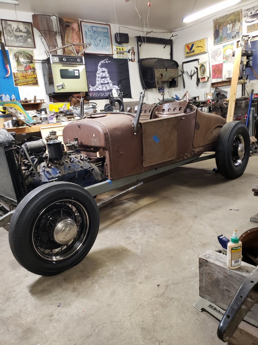

  19. 20191027_181551.jpg Slowly but surely making progress. think I'm doing it proper
  20. 26 T Ford RPU
    Joined: Jun 9, 2012
    Posts: 12,609
    26 T Ford RPU
    Looks good to me.:cool: JW

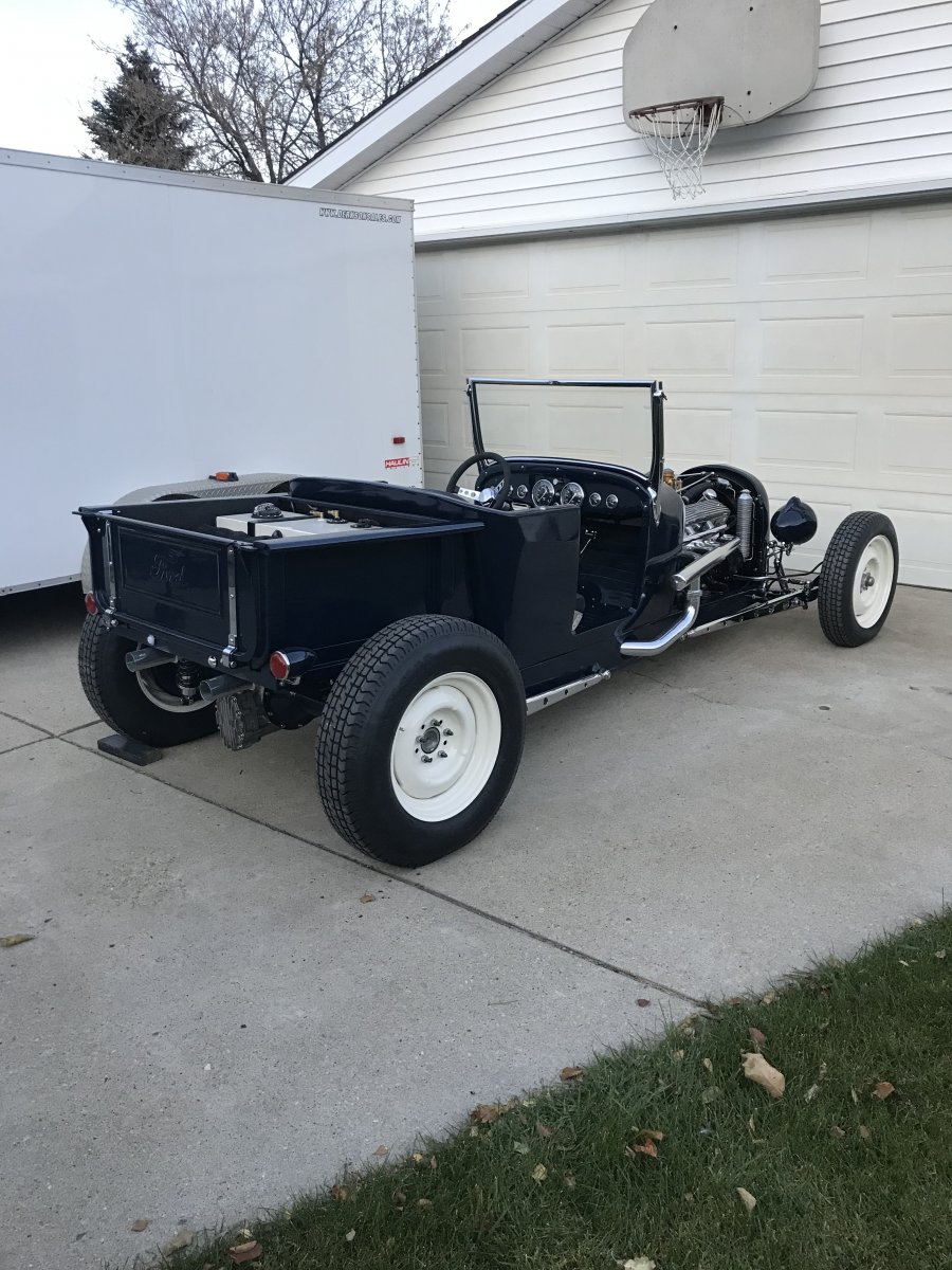

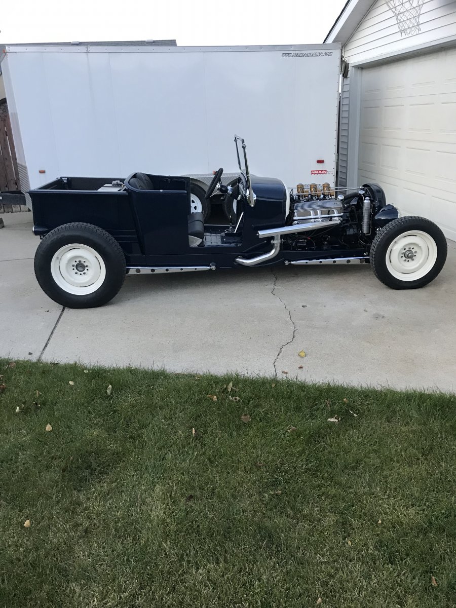

    I’m getting closer :cool::)
    E208F89C-28C2-4D57-B45A-0D447680E343.jpeg 2C1AE376-3CF5-43C2-9FE9-D6D96D593BF6.jpeg 47F596A2-24CD-4847-ADD6-9620EB2550FA.jpeg 39400CE0-A97D-4729-B013-BDC0B0ADCC72.jpeg

  25. Thank . I made a beginner's mistake and changed tire size after I modified the frame. I dont have a full spring pack on the back so hopefully a few more leaves will make the top of the wheel well align with top of tire

    I would see how it rides before adding springs. I think it looks fine the way it is.

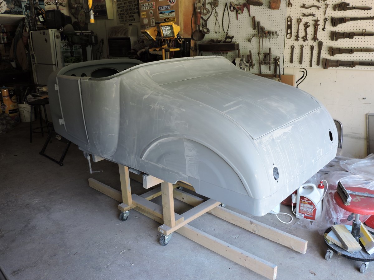

    Howell will sell you a complete deck lid or the inner or skin. I bought my skin and inner in two pieces and put them together my self because my body was so bad I knew I was going to have trouble fitting it up. I don't think I could of with a complete piece. Making it fit was maybe the hardest part of the entire build. DSCN1120.JPG DSCN1124.JPG

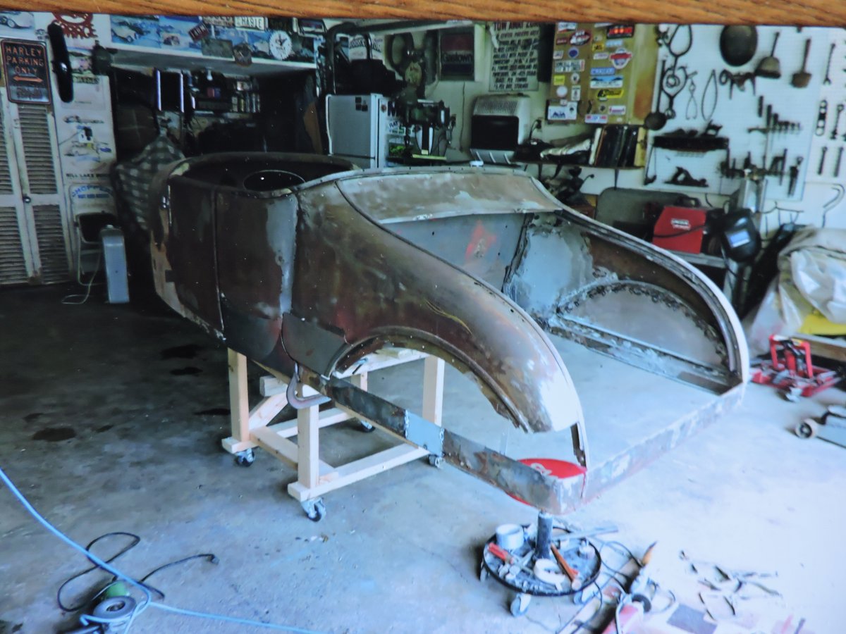

    T skele.JPG hought i would throw this picture in.

    That's exactly what I ran into but because I had both pieces I made the outer skin fit the body first. Then I got the inner panel to work more or less and then I put them together. I also had to adjust the panel below the deck lid and even moved the quarters around some. Getting the hinges to work right is another whole problem.
