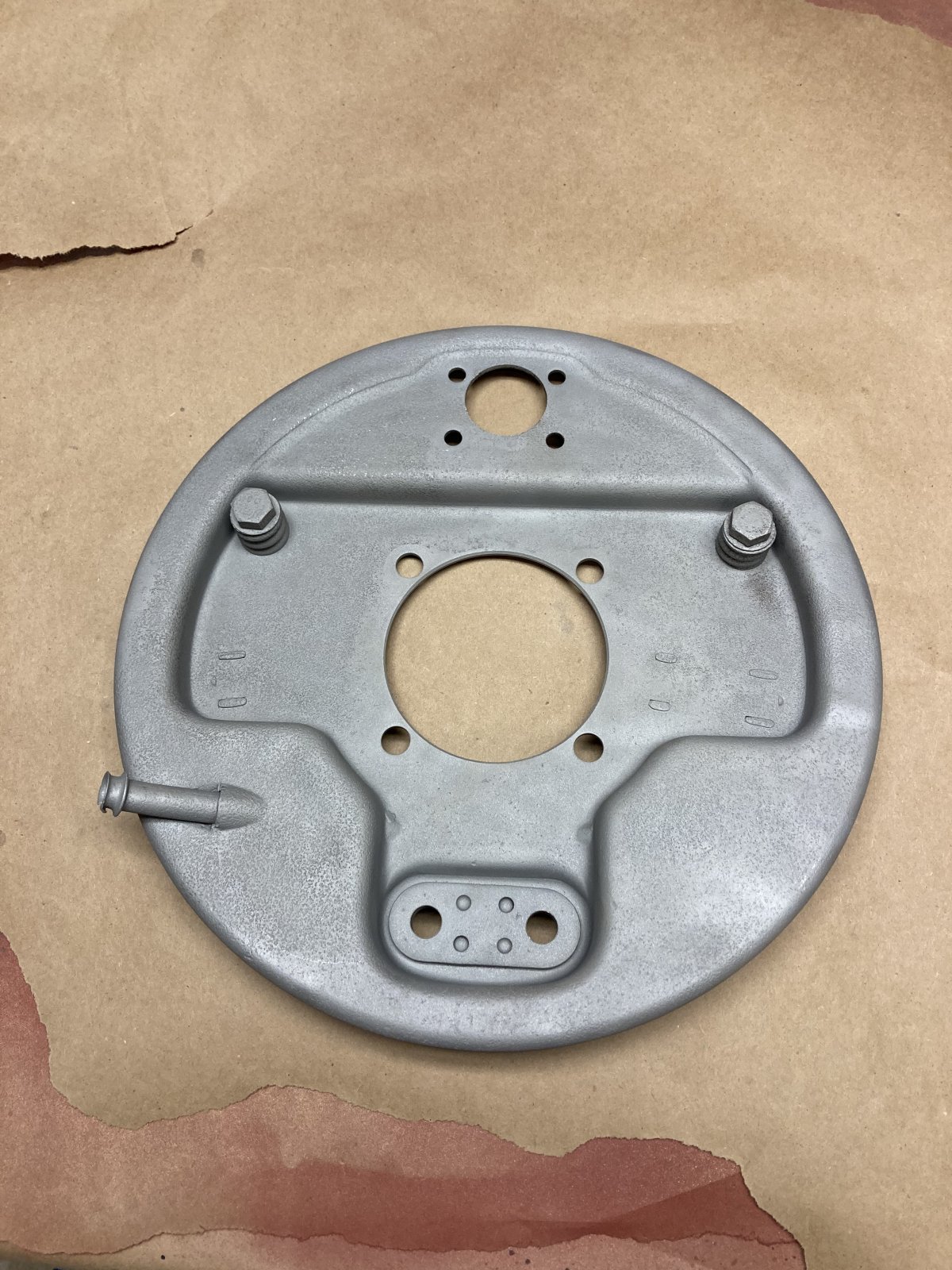

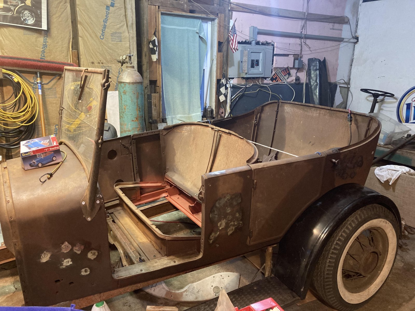

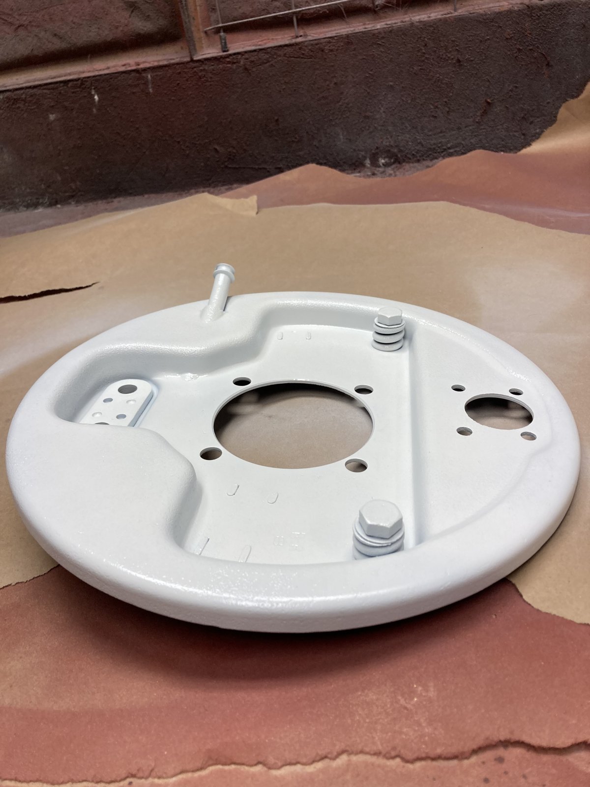

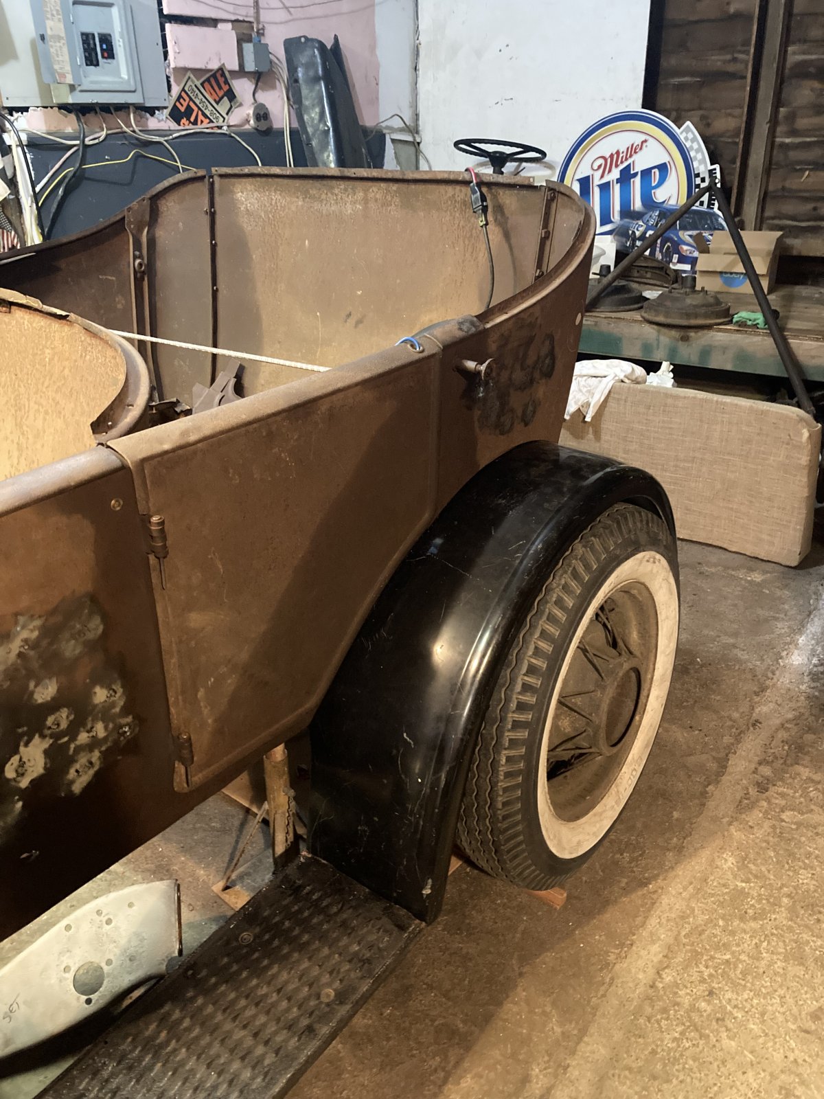

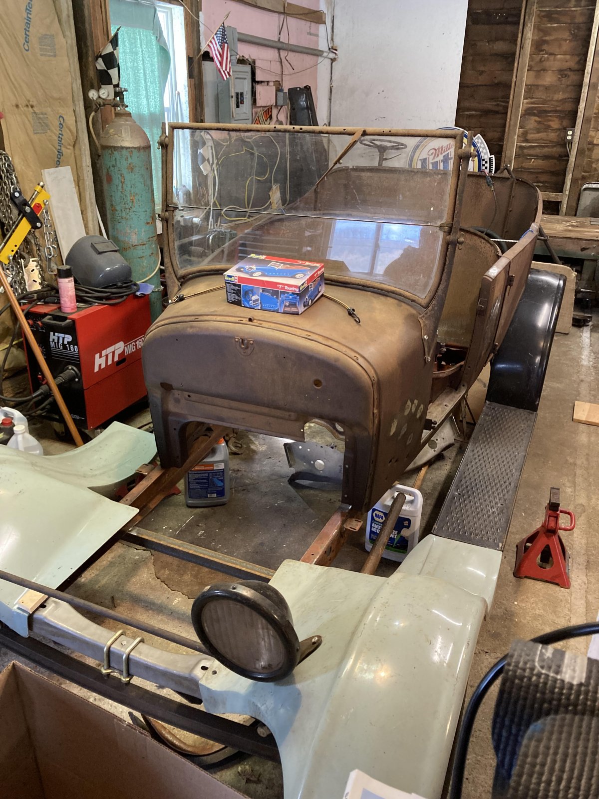

    A small update, but huge obstacle overcome for myself. Finally got those stuck bolts out of the rear fender wells and drilled two holes in each rear fender with the help of a couple friends. We used a carbide burr to drill out the rusty bolts and numerous broken drill bits. The hole will probably need to be tapped one or two sizes bigger once I get them cleaned up more but they're being held in place for mock up. With the rear fenders on the car and the front fenders nearly where they should be (I'll probably have to trim more off of the frame horns), we pushed the body forward to get the spacing correct for the stock running boards. Next to do is ***emble the rear end with wheels and tires to roll under the car to get the rear crossmember where it needs to be. I rolled a wheel underneath the wheel well for motivation. Also have been sandblasting and painting as many ch***is parts as possible while I still have access to the sandblaster at school. The model box is also for motivation.
    If anyone has any suggestions I'm all ears. I also need to figure out the fender brackets and running board brackets, I'm thinking of using the A running board brackets and maybe the T fender brackets for the front fenders. 67072139199--46A117AD-FDEF-40BB-909B-EFFFCEEBA326.jpg

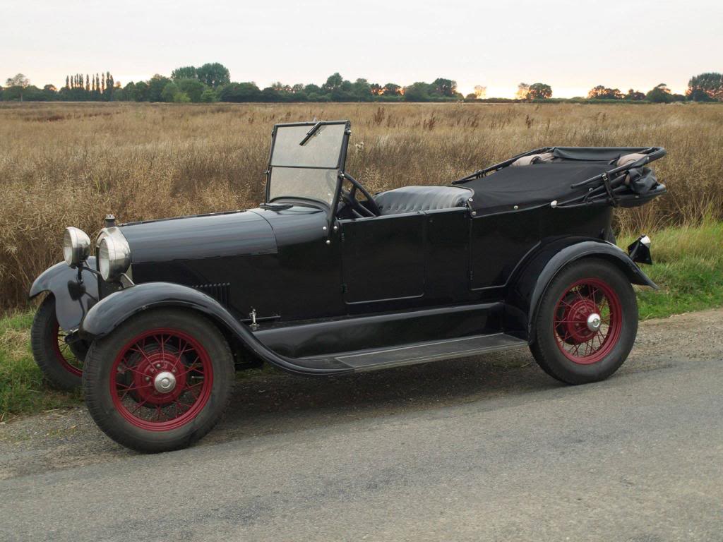

  2. I cheated and used all A fenders and running boards. Tourersnewwheels1_zpsd56afa6c.jpg
  3. krazee
    Joined: Nov 3, 2011
    Posts: 93
    krazee
    What year "A" fenders and running boards, that looks killer!!

  4. Rand Man
    Joined: Aug 23, 2004
    Posts: 5,434
    Rand Man
    I’m guessing 28-29. A 26-27 will sit right on a A ch***is. It’s a cool swap.

    For anyone wondering, the Model A frame fits about perfectly with the stock Model T hood, grill and fenders etc. The only thing is, the Model A front crossmember needs to be modified to be flat in the front, in order to get the wheels a half inch to an inch farther forward.
    Does anyone know of a flat faced front crossmember I can buy or should I attempt to modify the roadster supply repop one I have now? Any other ideas I'd love to hear as well.

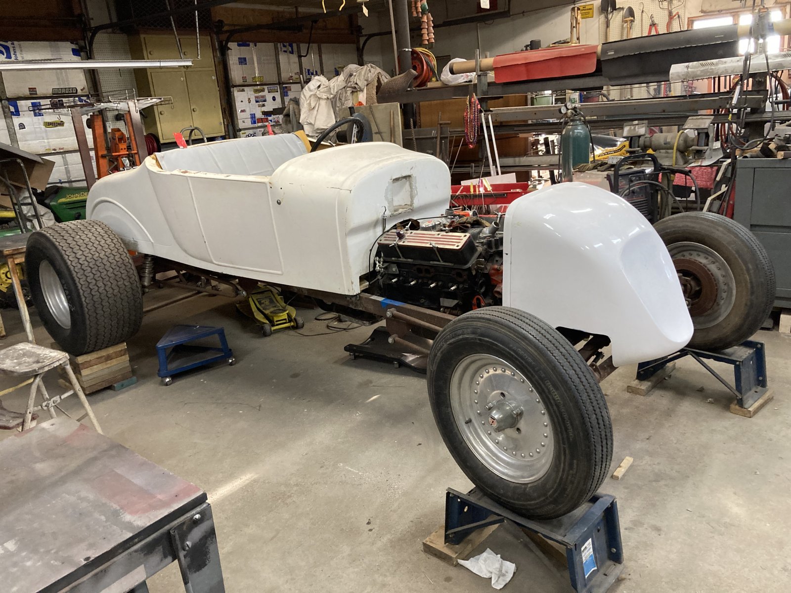

  24. Exactly that. Liked it so much I built it's sister... t COUPE EN ROUTE.JPG
    Outback, RyanAK, Lil'Alb and 10 others like this.

  26. Mr48chev
    Joined: Dec 28, 2007
    Posts: 36,232
    Mr48chev
    I've always liked that 26/27 T body with A fenders look. Wescott sells a gl*** roadster kit with the pieces but it's too rich for my wallet.
    Dang nice looking touring.

  27. vanherrb
    Joined: Nov 23, 2010
    Posts: 53
    vanherrb
    that 26- black coupe with 28 fenders ,, sha-zam now 28-9 fenders on my swap meet hunt-- list
  28. fiftyv8
    Joined: Mar 11, 2007
    Posts: 5,401
    fiftyv8
    from CO & WA
    What hood did you use on the T coupe with Model A ch***is???

  30. I made it. It’s a four piece the same as the T but around 3.5” longer.
