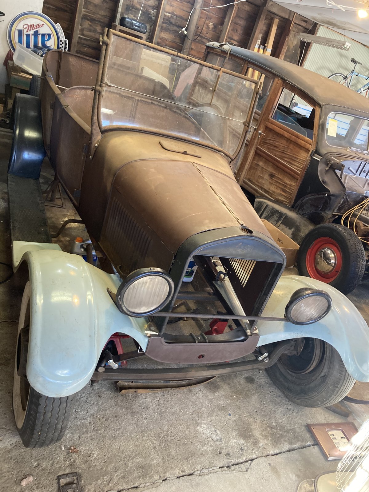

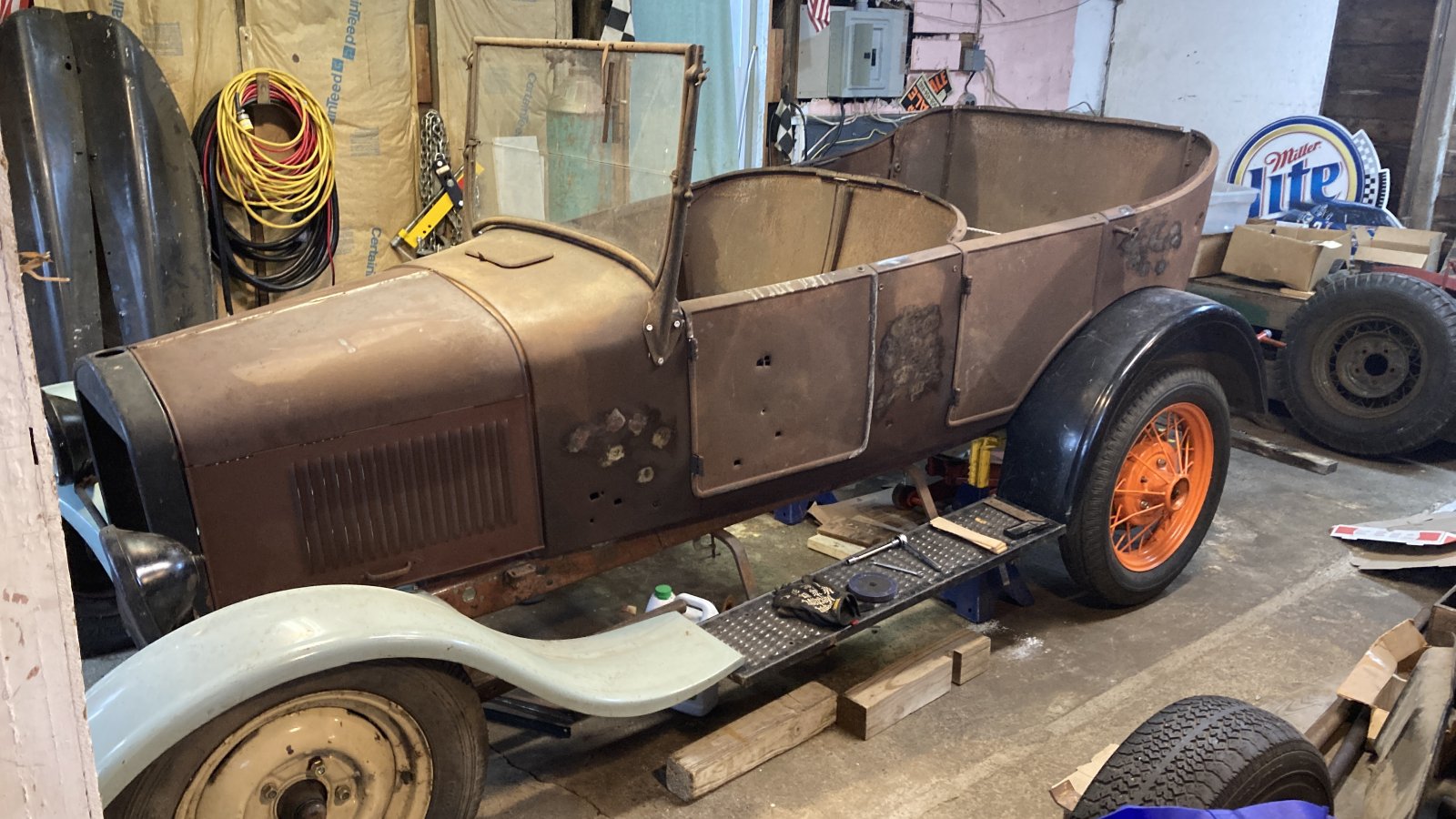

    This one has just followed me home, I bought it from a restorer & when he told his wife it was going to be a hot rod she got very excited!
    (He was ok with the idea too btw) I hope it will be hot rod enough for her! Plans are Banger either on a T or an A ch***is.

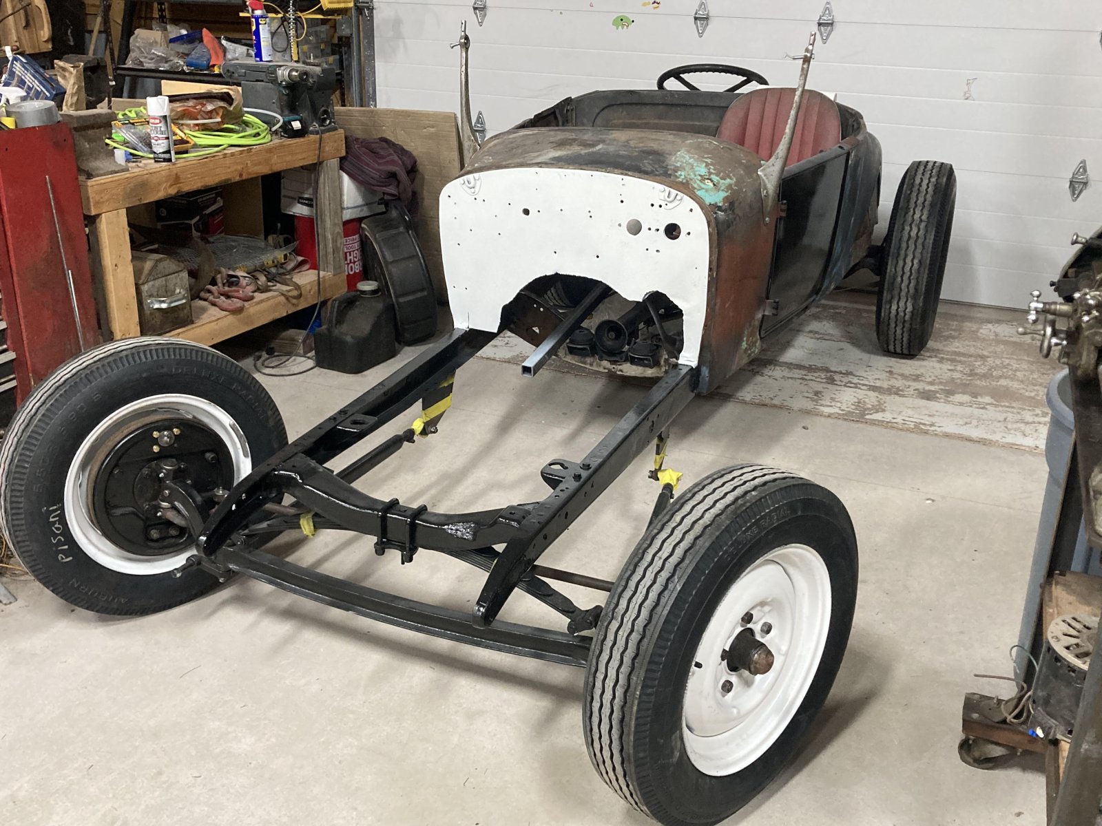

    Been waiting for this thread to come back to life haha. Here’s some pics of my T. Progress has been really slow because of work but about ready to weld in the rear crossmember. Don’t have an exact measurement of how much I shortened the frame. I left it slightly longer than stock T wheelbase to get the front wheels nice and tucked into the front fenders since it sits so much lower than stock. Also, everything I’ve read said T frames are 100” but I kept getting 99” on my original frame.
