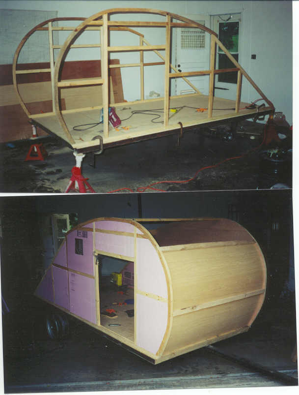

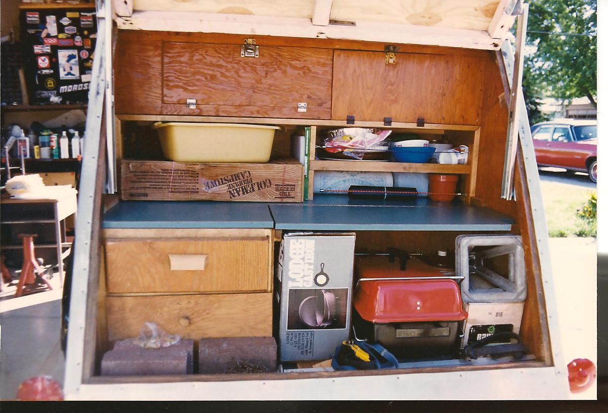

    Kustom,
    I built one some time ago. Didn't use any plans. I had a trailer bed hangin around so I got some large cardboard and started laying out the profile I wanted. The only requirement I had was that the kitchen rolled to the back of the trailer to keep from leaning way in to cook, etc. I did the framework first out of some old fir I had laying around. 1 1/2" sq. I think. Then paneled the inside first, layed in foam insulation and glued to the paneling and framing, then glued on the exterior after wiring. To finish it off, I put strips on to give it the "woodie" look. Cant find any pics off the finished product but i will keep looking.
    Google teardrops. There are a million images out there you can pick ideas from.

    NICE,,,how did you bend that wood,,,steam?

    I dig that moving kitchen idea....should make it easy on the back!

    The wood wasn't bent. It was cut from 12" pieces on the curve and glued to the next piece. I used the full size pattern to do the layout of the curves.
    The kitchen was held in place by bearclaw latches.

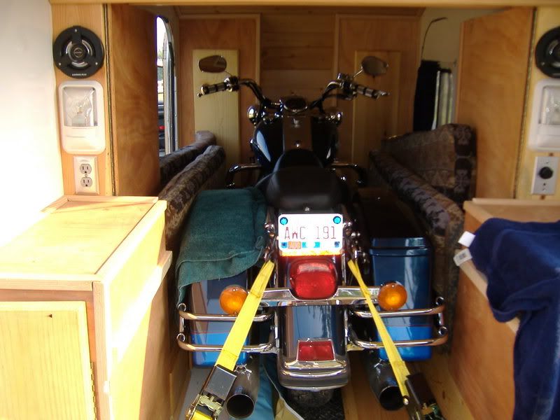

    Here's one that I built 2 years ago. I wanted one I could haul my bike in and then setup to camp in. I didn't have any plans but went on the internet and looked around. Got different ideals and then built to suit what I needed. Materials cost around $4,000 to build including a 5'X10" trailor. You can build for less as I over built mine. I use it often and have a lot of fun with it. But be prepared, people will ask about it more often than my hot rod.

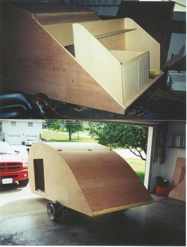

    Here is a picture of mine (in progress).

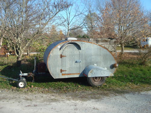

    Here is mine. It was a homemade from mid 30's. It even had a wood frame and the tong was also wood and a true 4"x4". All that changed with a new frame built to fit the body. The sleeping area is 6'2" long.
