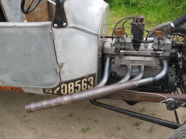

    Model B: Counterbalanced crank, lightened flywheel, V8 pressure plate, (crank full balanced with pressure plate), dual carb intake (too much carb really), "high compression" head, Headers (stock cam but she still goes)
    Only thing I have left is to upgrade the rest of the drivetrain to be able to get it above Model A speeds.
    It's peppy, a lot more than the stock A (engine) I have.

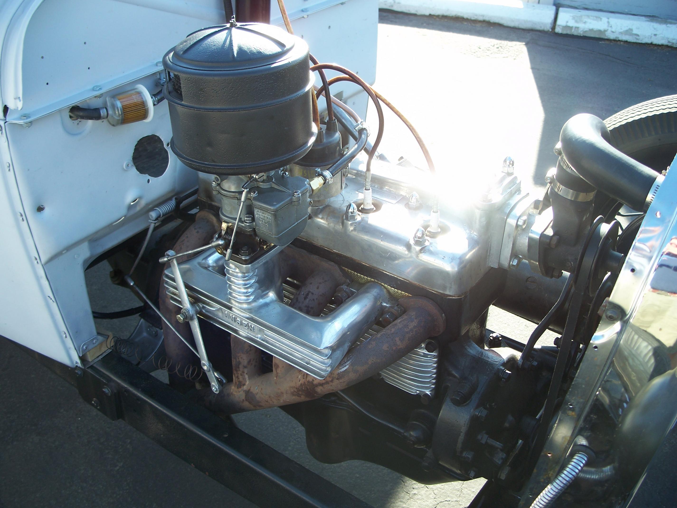

    .060 over, with touring cam, 7.5:1 Lion Speed Head, Reds Header and Weber 2 stage. I'm saving now for a Riley duel carb set up! She does real well!!
    [​IMG][​IMG]
  16. Cornboy.... Were you at Grants Pass last weekend? Good event!
    Piewagn.... Nicely done!

    Banger Matt, that thing looks at home in the dirt! I love it!!!
  20. BangerMatt
    Joined: Mar 3, 2008
    Posts: 465
    BangerMatt
    That thing STILL has mud on it, and I went at it with the power washer. PA clay is tough stuff.
    btw, ID the passenger!
