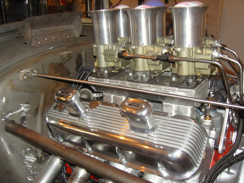

    Here's mine kind of a short tunnel ram. I did exactly what some of the other guys suggested and used a single plane intake and milled the plenum and runners off. I didn't want to mess with locating the distributor. I built everything else above that.
    I'm know I could make more power with a single Dominator but that would be boring. :) Lets face it if we worried about getting every last bit of power out of our cars, we wouldn't even be on this website. Also for me I wanted to challenge my own personal fabricating and tuning skills. If I just bolted on a carb and intake I wouldn't of really learned anything. I'm not busting on anybody else that's just me.
    It took a lot of tuning but I'm really satisfied on how it performs, idling, cruising, and WOT. :)
    The next step, when funds allow is adding a centrifugal or 2 and blowing throw the carbs.

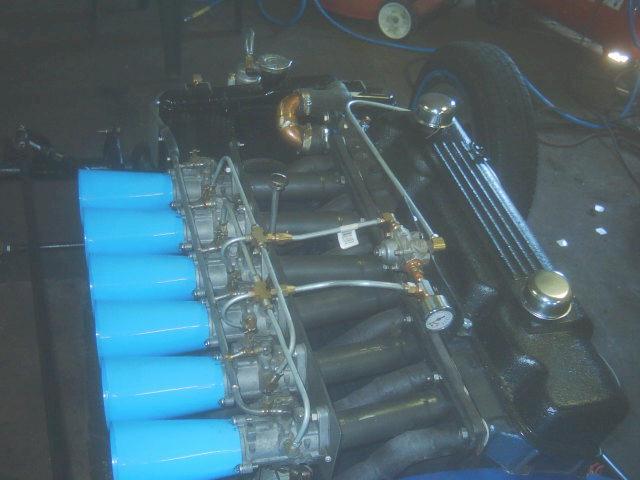

    from Tustin, CA
    Does this count? Slant six TR made from 1.75 EMT and a cast valve cover! EFI of course and the injectors are going into the HEAD, epoxied right through the water jackets and into the roofs of the intake runners. Will it work? Ill find out soon...:eek:

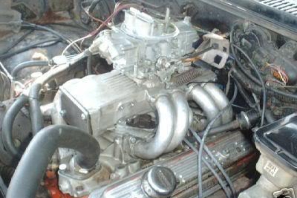

    Here is one.
    Random pic that I acquired somewhere.

    just remember, fuel in air doesn't like to turn sharp corners as the heavier fuel likes to keep going in its original direction while the less massive air can make the turn, making some "middle" cylinders run lean. Dry intakes can be almost any shape as long as the injector is close to the valve.

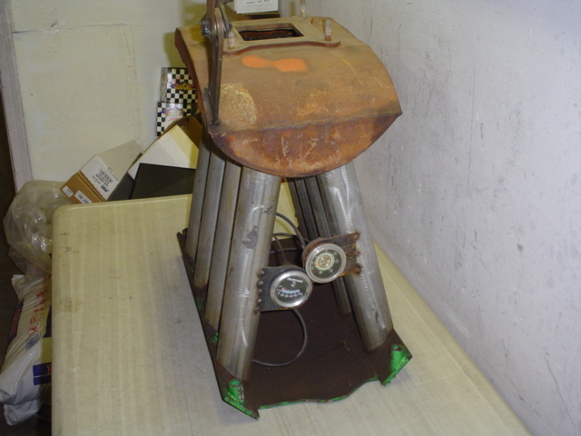

  19. I made one for a slant six and pics are just below this this morning. I also did a partial build for a 440 making a 2 x4 lid for a Wiend STR superstock sixpack manifold which is a tunnel ram in the full sense of the word. If I was doing an early hemi etc I would do a U-fab with extended runners. Formula for runner length is not hard.
    AND I would never not try something because it seemed hard. Here building trumps buying everytime.

  25. Looks great except there is no taper in the runners, so there will be a lazy moving air column. Still a great first effort.
    Tom
