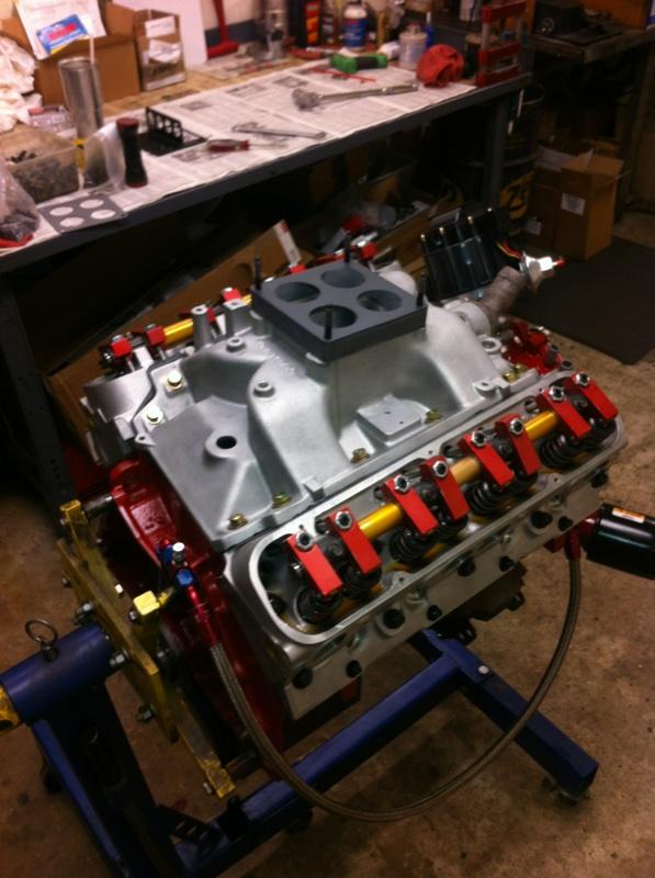

    Had a 430 Buick in my 55' stude. 7.40's in the eighth, 11.70's in the quarter. Swapping in a 703 hp 455 right now, drivability is probably gonna suffer. 10090.jpeg
