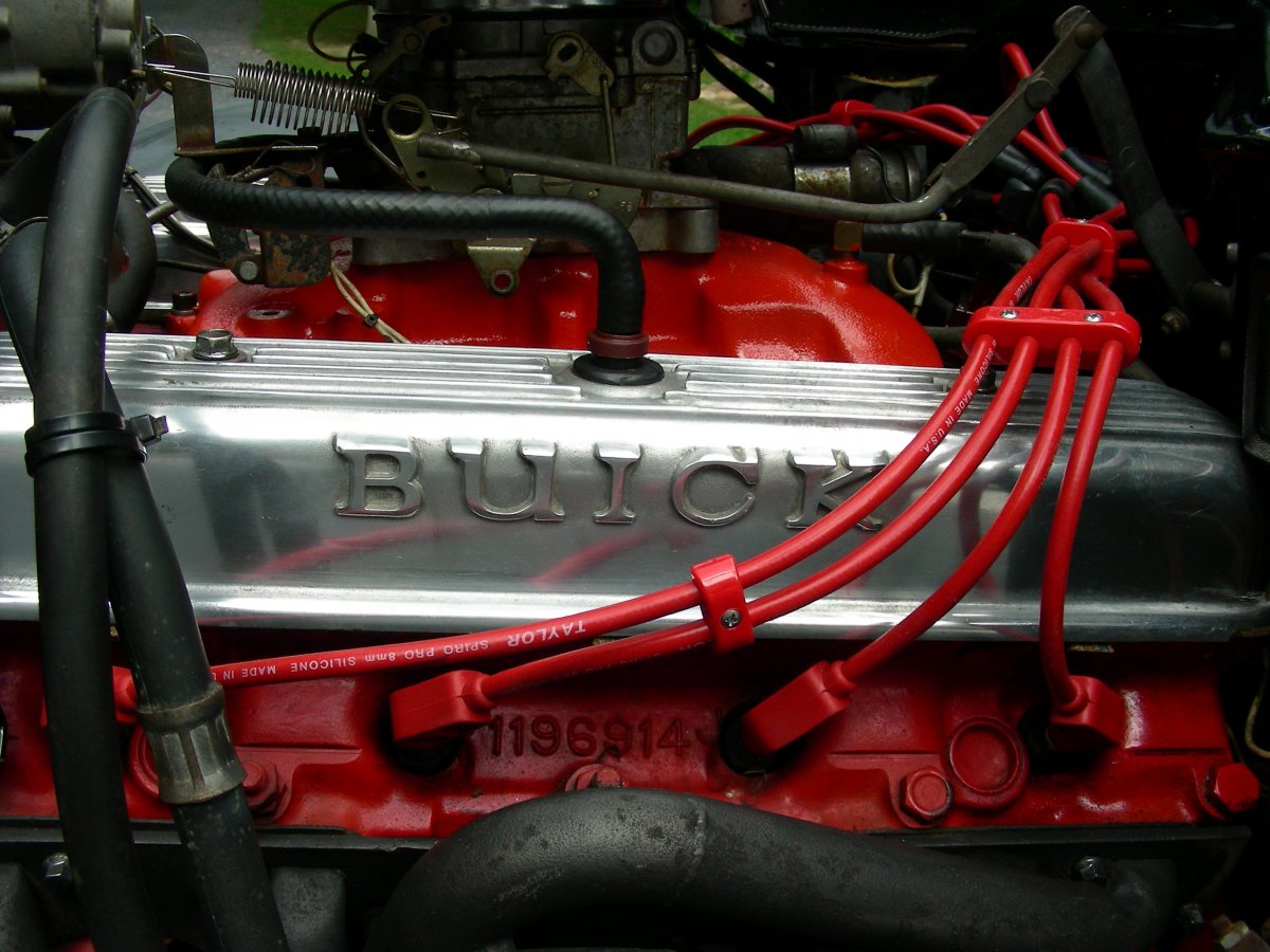

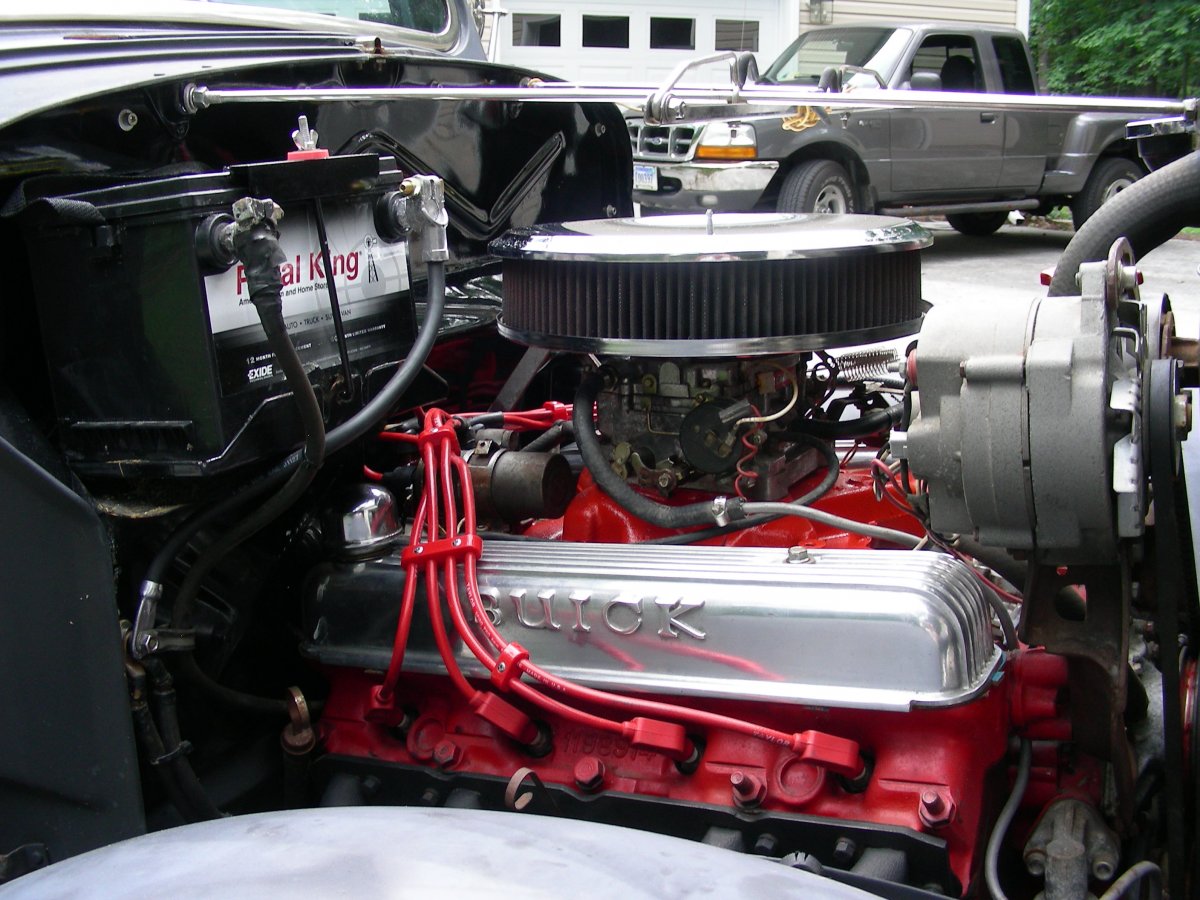

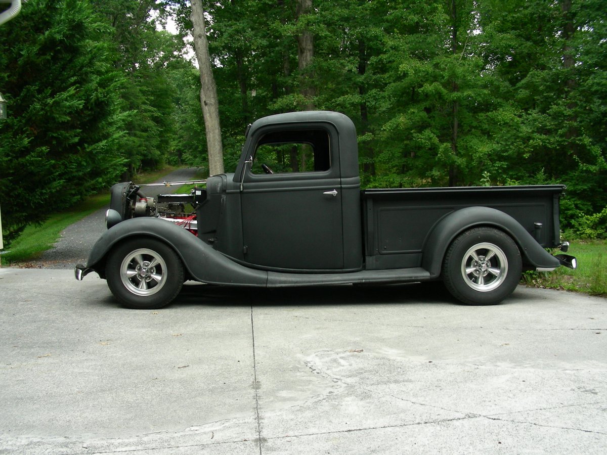

  11. Firewall is all stock, not cut except for the battery box now located on the passenger side. DSCN0592.JPG

    Really? I'll be danged. I thought for sure that you would have to whack it up.

  14. Roothawg
    Joined: Mar 14, 2001
    Posts: 25,906
    Roothawg
    How does the starter clear?
  15. Starter is on the driver side.....clears easily below the steering column......engine mounts were made to sit the engine low.
