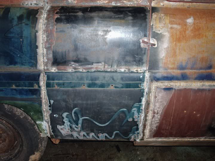

    Time to get to the inner rockers! This thing had more outer rockers per side than the car had doors total! And that's a lot of doors!
    Carefully cutting it down after some bracing...
    He then bent up some (what we call) floor caps (the 90 degree bends) and inner rockers. Popped the doors off and had at it!

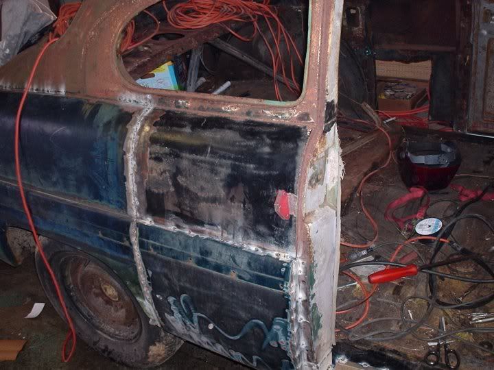

    One side completely done with new lower A pillar (these always rot out)
    And the other side!

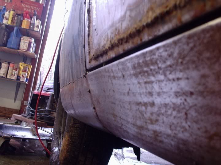

    Next my favorite part, installing Green Mountain rocker panels. If you have never put them on a car, best way I can describe it is like it's installing sex. It really is.
    At this point we are into Monday morning, his girlfriend saved the day by bringing the rockers down for us, she works in the next town over so we just ran down to pick them up. Monday sucked. My garage flooded, we kept the wires, welders and tools elevated, wore some rainboots and kept it moving, had to get it done by Monday evening. It was also the day of tedious little patches and this and that.

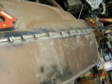

    Next up is the chop, since this pic everything has been finish welded, just gotta order a rear window gasket so we can install the window before chopping it. Its the only way to really get a good idea how the roofline looks is to have the window installed while chopping it.
