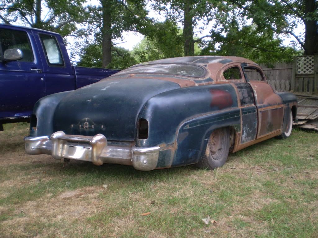

    looks awsome roof line looks spot on, love the rear window placement, and how it flows into that roof line...do you guys get your rust repair merit badges after this??? chris the rear 1/4 window radius looks a bit large at the back with the chop, TOO ME... hows doo yous guys' feeel about it?? that was my jersey accent:D

    Lol Matt, you talkin' ta me? Haha, excellent accent! I remember when we were chattin on the phone you were surprised at my lack of accent, get a few beers in me and it comes out with a vengence! Unlike talking to Glassguy, whose wicked fakkin Bastan accent has no on or off switch. ;) I do like the bigger side of the rear radiuses though, I think with slanted pillars you can squeak out some extra length in the quarter windows because you have some real acute angles going on at the top roof side, and it matches, but with a nice long quarter to begin with, and some wide curves going on already, I like mirroring it a little back there.

    Back to the Merc, after we do our GTL, hes knocked out about all the welding, almost time to grind, strip and slather on some liquid body panel! It really looks cool looking at it in the yard, so I figured Id snap a few pics and pose a question with them.
    Today we tried drilling, splitting and heating some 54 Merc lenses ala Ether. Didnt go so hot, (no pun) so we are looking for some tail light ideas. I mentioned maybe some low frenched vertical 51 Ford lee lenses, what do you guys think?
    Here the ol battle ax is in its current state though.
