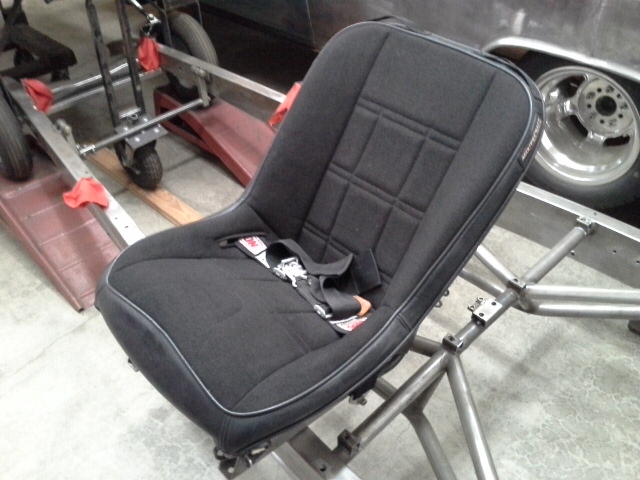

  6. DDDenny
    Posts: 23,422
    Simpson in both my roadster and my Nova.

  8. squirrel
    Joined: Sep 23, 2004
    Posts: 60,981
    squirrel
    this picture reminds me that racing seat belts are the very last part you should buy...they go stale so fast!
  9. RmK57
    Joined: Dec 31, 2008
    Posts: 3,289
    RmK57
    That roll bar going to p*** tech? The crossbar is supposed to be level or not more than 4" below your shoulders. The door bars are supposed to p*** midway between your shoulder and elbow.
    seb fontana likes this.
  10. DDDenny
    Posts: 23,422
    Dated belts and roll bar will p*** tech anywhere the groceries are procured.
    Oh yeh, tire dates have never been a concern of mine either!

    Joined: Sep 28, 2010
    Posts: 3,325
    Mike VV
    from SoCal
    Yeah, not so much !
    The first thing most tech guys do is look at the belt date.
    Tracks "sometimes"...let you run THAT day, but you won't get to run next weekend without new belts at most tracks.
    Street driving...that's on you.
    Dale Earnhardt remembered.

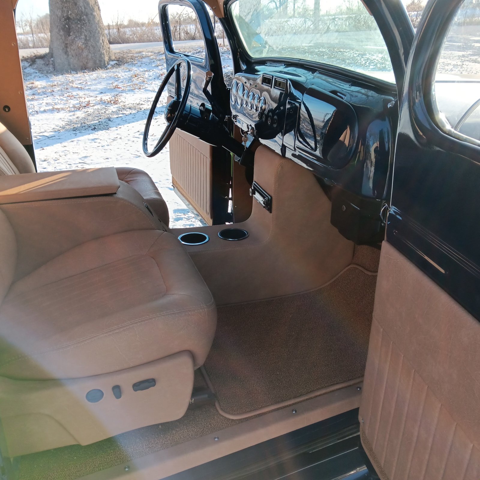

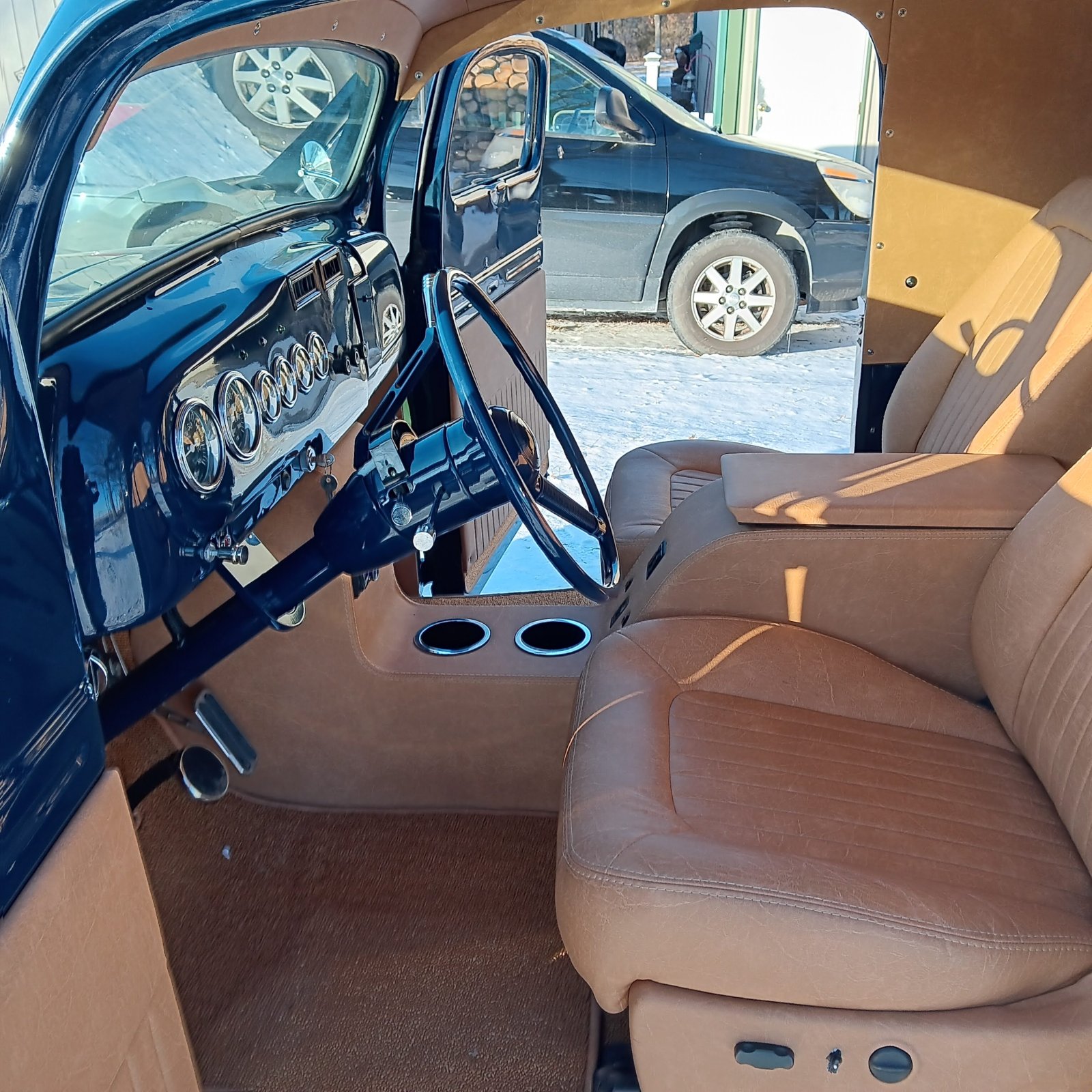

  16. atch
    Joined: Sep 3, 2002
    Posts: 6,765
    atch
    Thanx. I had never heard of Crow so I Googled them. Most of their stuff is compe***ion but they do have some street type belts.
    b-t-w; I looked at Summit and Jegs. Theirs are almost all compe***ion style and black.
    b-t-w (again): here's where they are going:

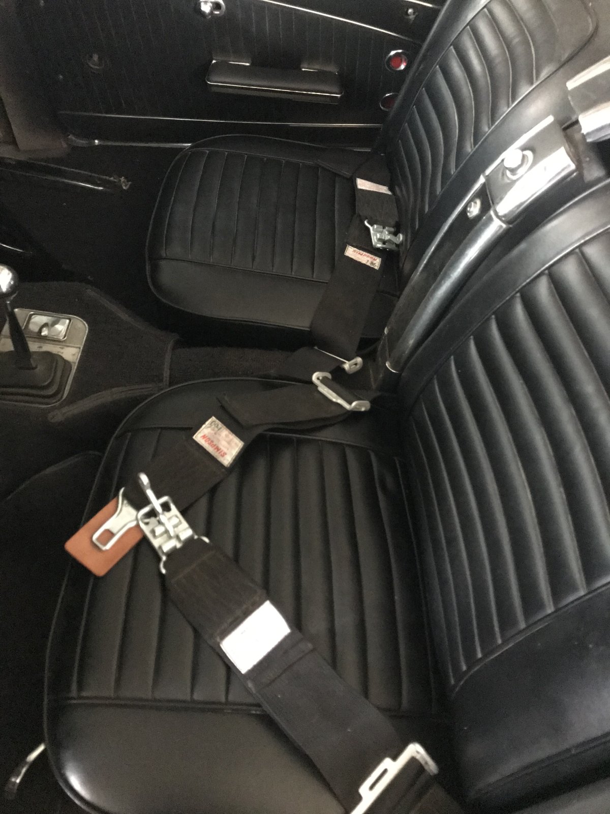

  18. MCjim
    Joined: Jun 4, 2006
    Posts: 1,420
    MCjim
    from soCal
    C1 Corvettes came from the factory with provisions for belts, and were installed by the dealer...beats getting impaled by that non-collapsing, rigid steering column.
    Out dated, but NOS race belts are just fine for my heap:
  19. Moriarity
    Joined: Apr 11, 2001
    Posts: 41,117
    Moriarity
    SUPER MODERATOR
    I saw those brackets in my car, I guess they were std equipment starting in 59. Lucky for me the law here states that vehicles newer than 64 need em. I am not putting belts in my car....

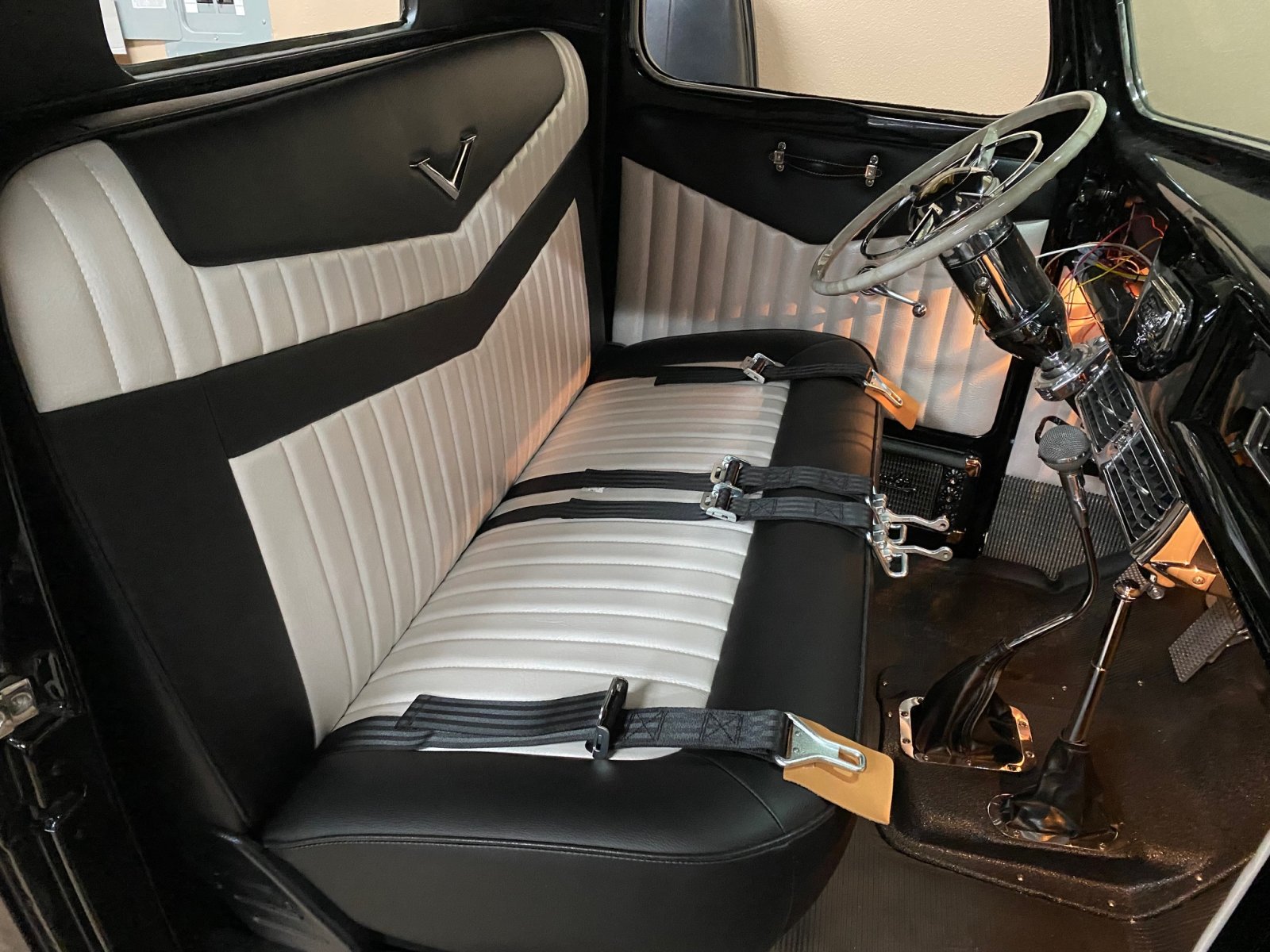

  22. -Brent-
    Joined: Nov 20, 2006
    Posts: 7,921
    -Brent-
    After a pretty long search and missing out on a few different sets of belts, I found a neat set of NOS 1960s lap belts (still in their packages) that were for upgrading vehicles without belts.
    Tow Truck Tom and mad mikey like this.
  23. 05snopro440
    Joined: Mar 15, 2011
    Posts: 3,495
    05snopro440
    I have always liked that latch-link style buckle, but they don't meet vehicle safety standards. Interesting that they're okay for drag racing but not highway use. I use the lift-latch ones. They work well for me.
