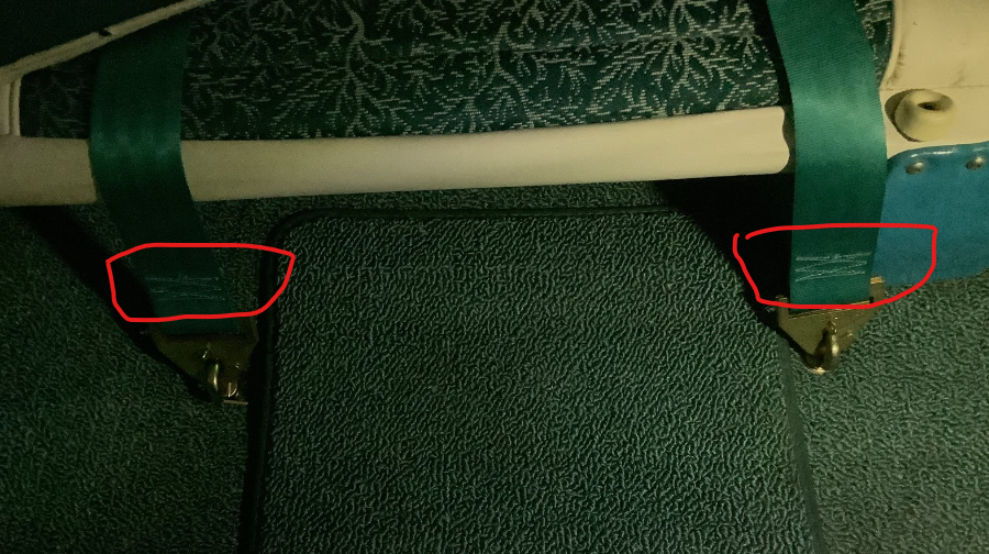

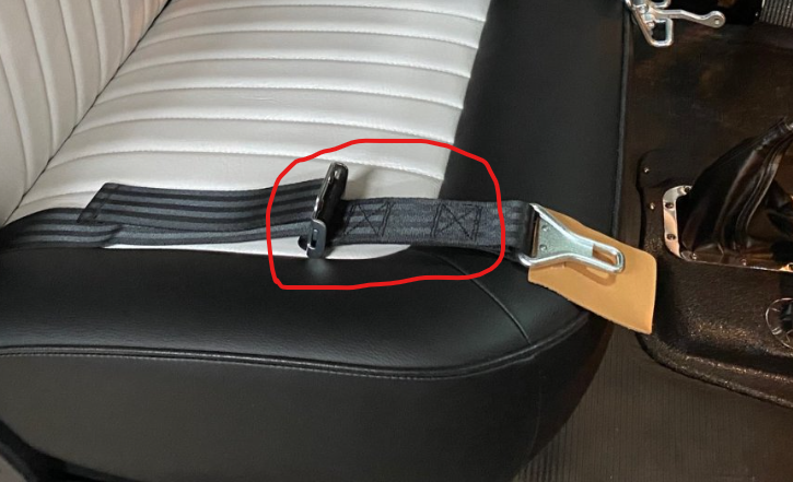

    If anybody is considering sewing tie-downs / seat belts / or load bearing straps ! There is a bit of a science to it ! I was OSH registered to sew these in NZ back in the late 70's
    Over the years I have re-webbed seat belt
    [Now a redundant skill due to programmable "Bar Tack Sewing Machines"]
    Here is some basic rules from the playbook. [showing relative tension strength of s***ching]
    @Bandit Billy and @jimmy six ! When I see s***ching like your 2 examples below on a tie-down or seat belt, I know damn well the manufacturer has merely plagiarized someone else's mistake.
    This is the industry standard of "Monkey see....Monkey do" because of deregulation. [or that looks strong enough]
    "then they baffle you with ********"

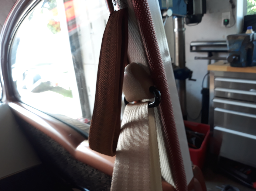

    The retro colour matched seatbelts in my 57 Chevy had one of the straps sewn on upside-down. [normally I would flip it around in the inertia reel but the safety label would still be on the wrong side]
    These were expensive and USA made.[from a reputable vendor]
    So I simply unpicked them an re-s***ched them, so you couldn't tell it was done.
    What annoyed me was I had to replicate their original poor/dangerous methods.
    They were sewn east/west and only had a 2" seam overlap.
    If I corrected this , I would have to argue with our "Road Compliance Know-alls"
