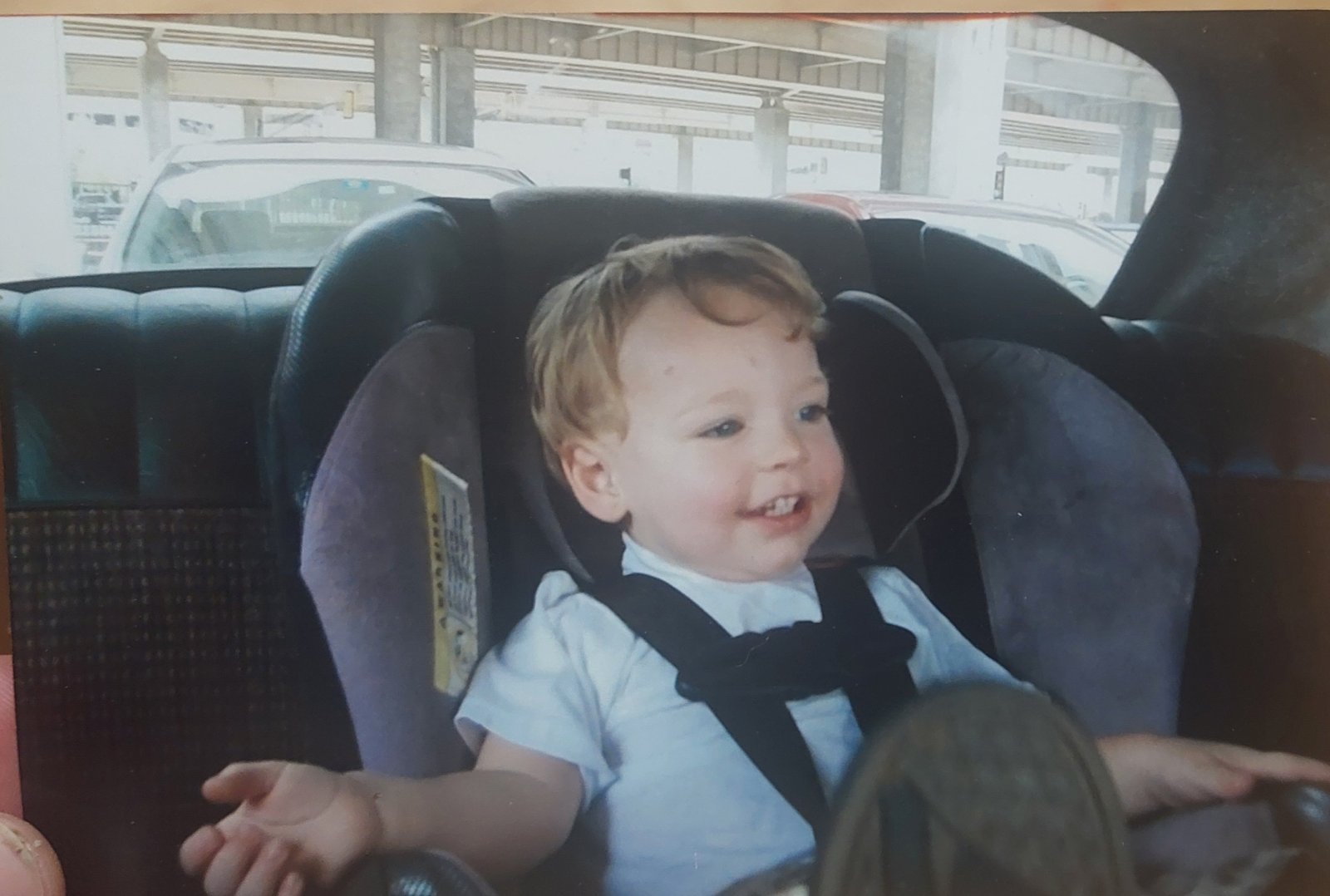

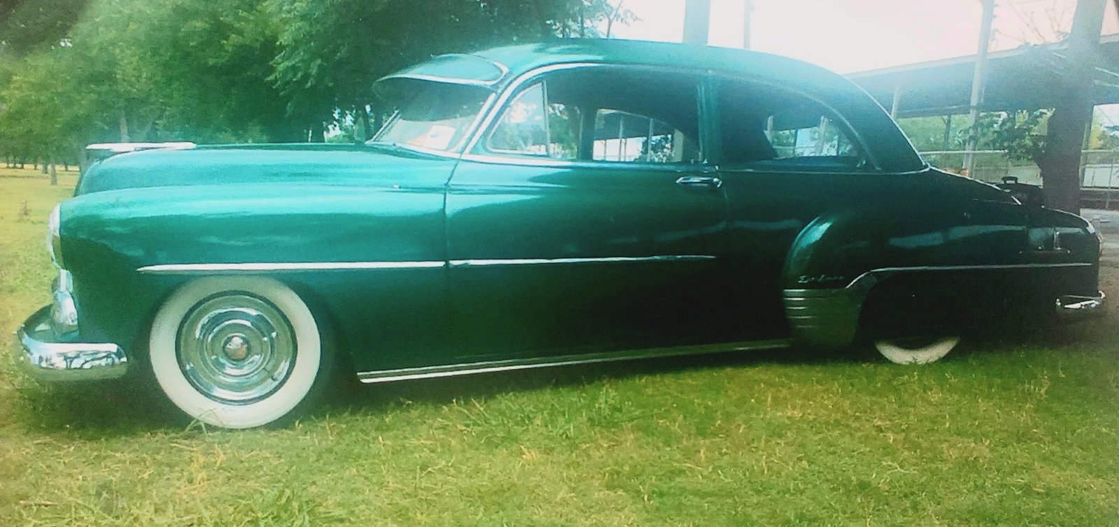

    Ive only ever had belts in the back seats of my old cars for the kids. We were road tripping the stock 216 in our 52 from Dallas to Kansas in August when he was still in diapers. Drum brakes, single pot master, AM radio, hand signals, only a rearview mirror & vent windows for "AC."

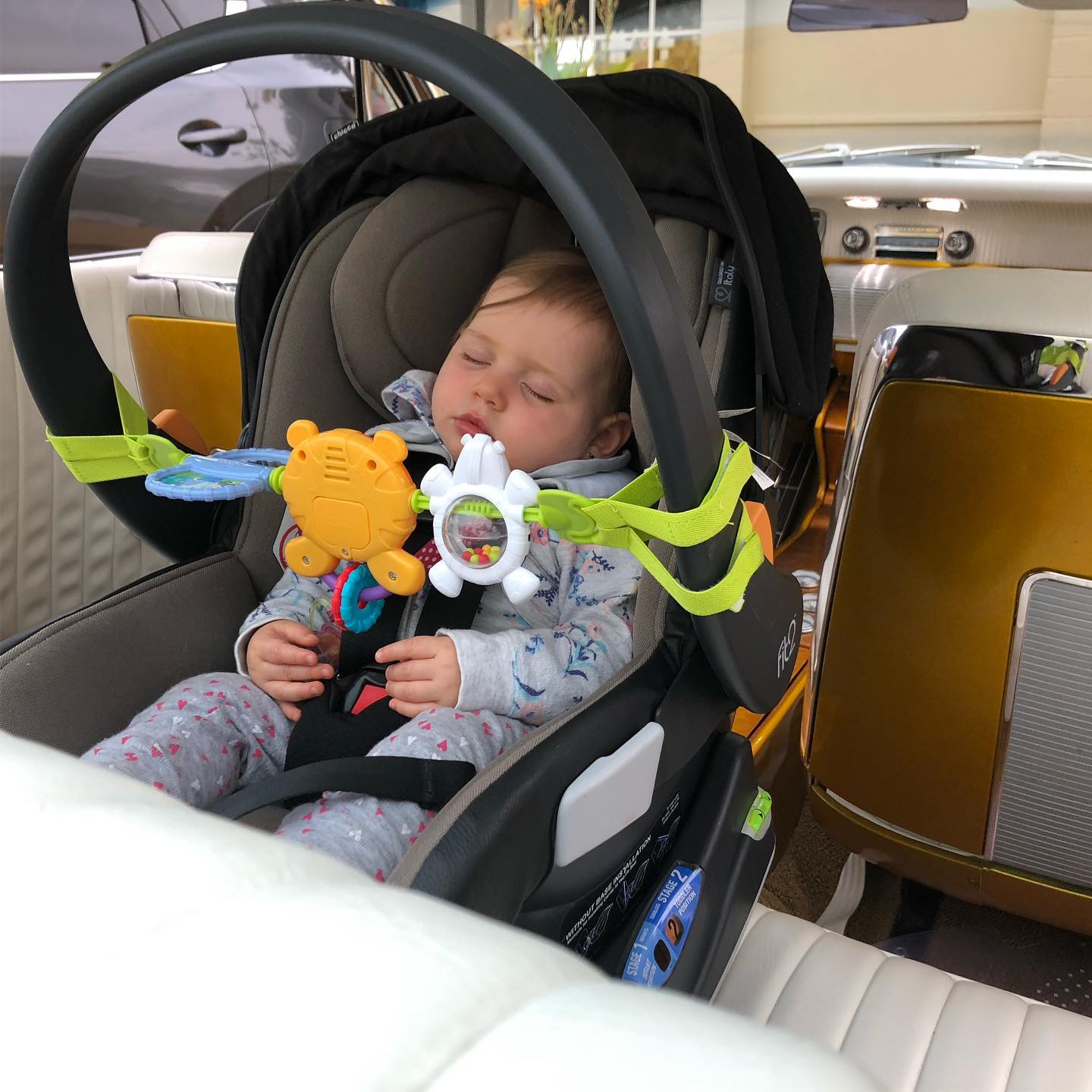

    This was back when she was still rear-facing. She's 5, going on 15, now. But she loves to ride in the old cars and always asks if we can take them out. As long as I can keep her safe, it's fun for everyone to get the old cars out and enjoy the ride.
