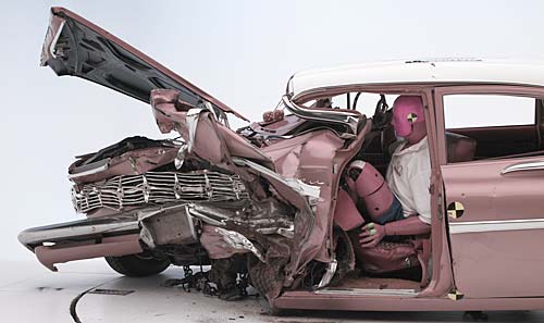

  29. You know that photo/video (here is the link if anyone hasn't seen it ) was sort of BS and was misleading at best but honestly to me it seems down right dishonest as it has some flaws or questionable things that statistically don't tent to happen real often.
    First they used a GM X frame GM vehicle then they deliberately hit it in its weakest area in an off center edge hit to miss the front bumper structure that would have transformed the crash energy to the frame. The NHTSA deliberately grazed the corner sheet metal where there was no structure to show how good the 2009 Impala way compared to a 1959. By that same rationale the NHTSA used they could have been physics in action lesson just buy taking the 1959 GM car and running it squarely into the back of the 2009 Impala at 60ish MPH and it would have killed anyone that was in the back seat (a much more likely scenario since rearend accidents are the most common collision especially at speed).
    I ask why did they use a 1959 car that had an inherent weakness and not use a vehicle with a perimeter frame or a 1959 Rambler to show the accident you know that had seat belts and a car body that was designed to crush a bit for safety? Why did they clip just the corner and not do a full on head on collision? As I said it was misleading at best.
    Now that being said nee cars are definitely safer generally speaking but seat belts have time and time again in all eras and vehicles have been proven to save lives. It's Einstein physics in action. By being properly belted into the car the energy is transferred into the car through the belt mounting points. Now you hav eto have properly mounted belts but when they are you won't keep moving forward when the car comes to an unexpected sudden stop.
