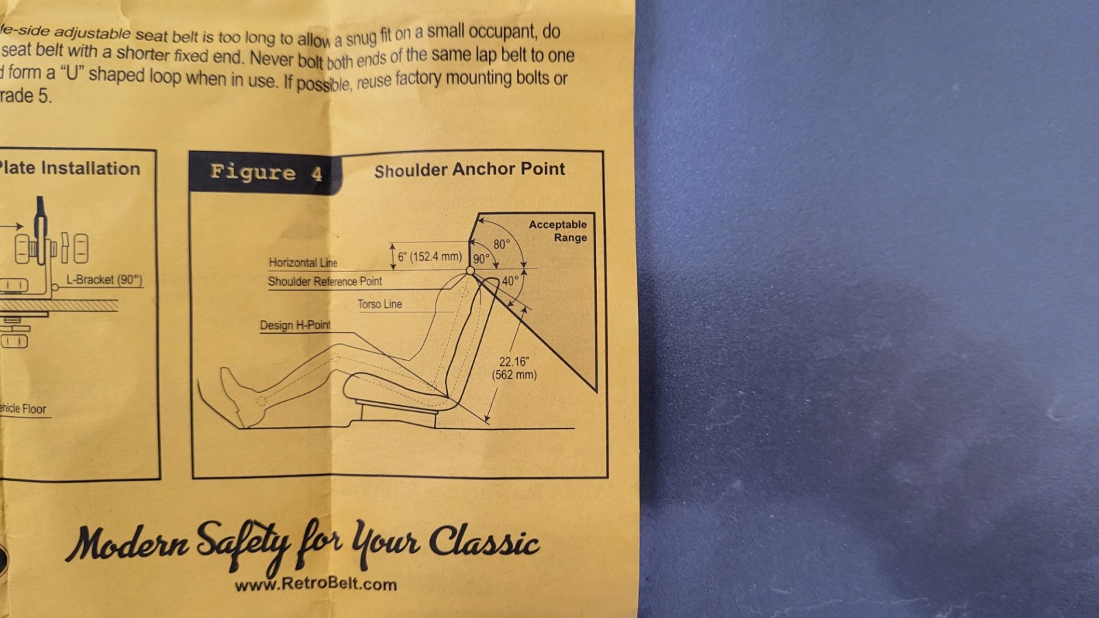

    I'm mounting shoulder belts in the resurrection of the B/G Austin;).
    The instructions with the belts provided this diagram of the mounting points. My seat back position was too far back to use the B post so I mounted the guide below the rear window ledge on some added bracing that was within that acceptable range. In some other literature one of the requirements is that the belt from the inertial reel must be 90* to the floor.

    Interesting, I would love someone with real engineering prowess to explain what the above diagram is trying to explain.

    The main thing I took from the diagram was that the high point of the shoulder belt could be below shoulder level as long as it was above that 40* line.

    Acceptable shoulder pivot mounting point: The degrees are determined from a line that is level with the ground, that runs directly on top of the shoulder of the person sitting in the seat.
    The farthest forward and above the person's shoulder is: 6" directly (90 degrees to the ground) above the person's shoulder.
    Past that 6", the pivot point needs to be set back at least 10 more degrees (80 degrees to the ground starting at the 6" point, leaning towards the rear), up to the height of the roof.
    (Note here, most early shoulder harness cars had the shoulder belts mounted in the horizontal roof support above the rear quarter windows, even if they had a "B" pillar. If your ride has a roof, usually the area above the quarter windows is reinforced, with a little extra enforcing a shoulder belt pivot point can be added there.)
    The lowest the shoulder pivot point is: At an angle of 40 degrees (to the ground) below (back and down) from the persons shoulder (roughly 22" above a line through the persons hip joint through the intersection of the seat back and the **** seat).
    Any area between those high points and the low points is acceptable.

    Answered above. Simply put, there are acceptable limits to the height of the shoulder anchor.

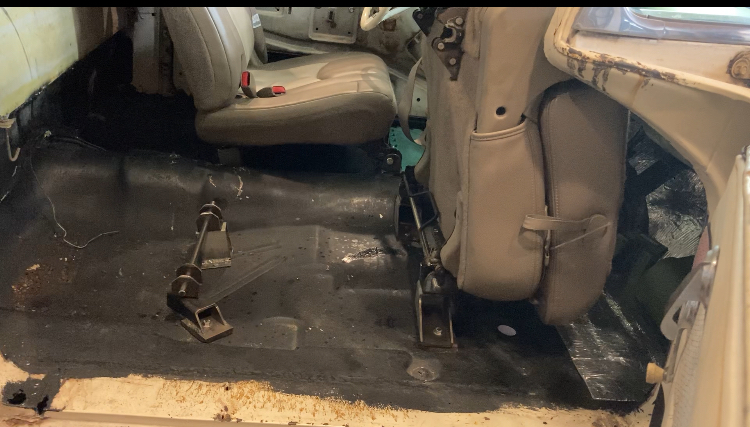

    IMG_1032.jpeg IMG_1031.jpeg I wanted a legit shoulder harness without having to beef up the B pillar. I installed a set of 3rd row bucket seats from a Caddy and I really like the way it turned out. Don’t mind the ugly upholstery lol
