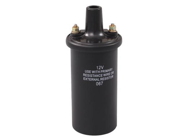

    Almost every 12 volt coil has to have a resistor to survive. GM used resistor wire, Mopar used a ballast.
    You didn't mention what engine/dist.
    Here's more talk.
    https://www.jalopyjournal.com/forum/threads/ballast-resistor-or-not.398528/
    I would suggest wiring in a ballast to the feed side of the coil and trying it. Bring a thick jumper to byp*** it if you want to be safe.

    Just a case of try it (resistor).
    If it doesn't need it, weak spark (no damage, real obvious).
    If it does need it, good spark without burning up another.
    I don't know flathead stuff like others here. I'd look at the points carefully, and the condenser also probably wasn't happy with a long on, not running abuse.

    I definitely need a ballast resistor. Maybe that was my bad in wiring the car, I couldn't identify one, and because I am dumb I thought an internal resistor on the coil (when I replaced it, like I said, car ran fine for a while, it didn't kill that coil till I left ignition on).
    The coil on it now is an edelbrock PN22746, it says. .7ohms internal resistance. do I need one with no internal resistance if I run a 3ohm external? I ran into a buddy at the car show Saturday who said if I run an external I need a coil with no internal.
    We have a complete distributor rebuild kit from shoebox central that has the condensor, I am going to try to do all of this on Saturday (if I get the external resistor in time, and different coil if needed).
    Thanks Winduptoy about the information on gapping the points, I um, honestly don't remember if I did it the first time, and I definitely did not include anything about it being on the lobe. Sorry guys, you are dealing with someone who despite not being past 50, has memory issues.
    when I rewired the car I put voltage reducers on all the gauges. I managed to get the cluster wired up beautifully just like the pics on shoebox central's website. HOWEVER, the car came to us converted to 12 volts, and the wiring was a rats next, nothing was ever pulled out, it was all just added to over the intervening years and was an absolute hell hole. It is possible the guy had wired it up to the gauges, possibly he fried them.
    I am trying to p**** through everyones responses, I appreciate it very very much. If I don't reply to each one I apologize, I'm trying to go item by item. For the starting, I did leave that same as original, key for ignition is on, starter ****on to start it. We didn't do that because we knew it mattered for function, we did it because overall we want to keep the function and look as original as possible, while making it better driving (i.e. we upgraded the front end suspension parts and added front disc brakes).
    Right now the plan of attack is
    -add the voltage resistor,
    -replace the coil if I need one with no internal resistance (by the way, I thought I felt a little oil around the top of the coil, my brother said it had just gotten hot. I have not talked to him in person in a couple weeks, I am not sure I relayed the series of events correctly on coil vs points damage each time, between each incident though the car ran. He had problems with the points each time. I don't know if that would end up causing problems with the coil though.)
    -rebuild the distributor

    you want a 1.5 ohm coil and a 1.5 ohm ballast resistor on a car with ignition points....

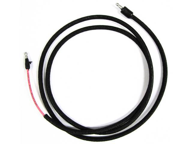

    https://www.npdlink.com/product/resistor-wire-ignition-coil/101401
    https://www.npdlink.com/product/ign...products?search_terms=Coil&top_parent=0&year=
    I much prefer the resistor wire.
    Those porcelain blocks...... Ehhhhh.
    I had trouble out of them. They get hot, they don’t like wet and in my experience they may need to be changed out regularly.
    You’ll have figure out how to install the wire if you go that route, splice or use the factory style bullet connections.
    Just don’t cut it in the middle thick part.
