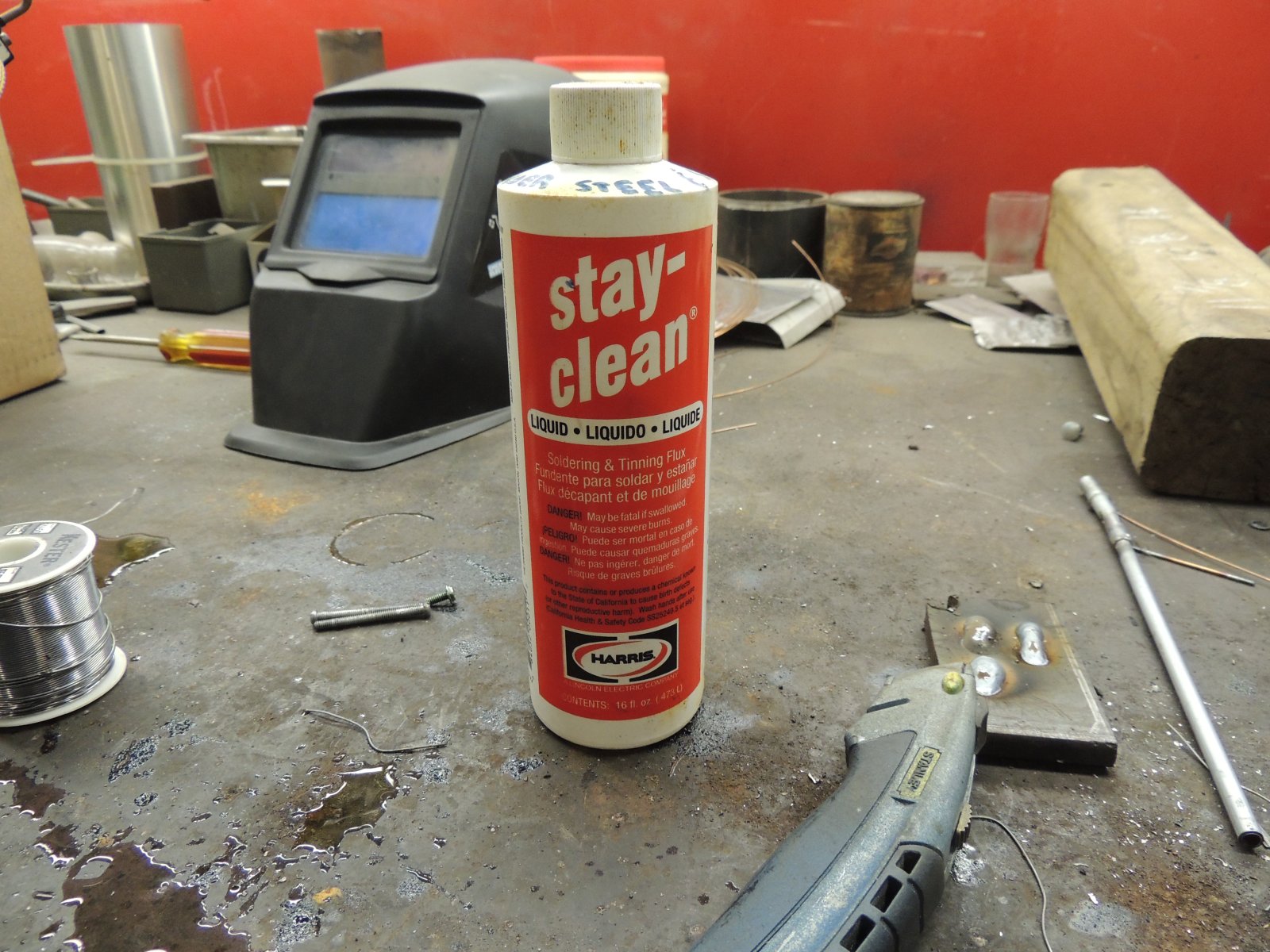

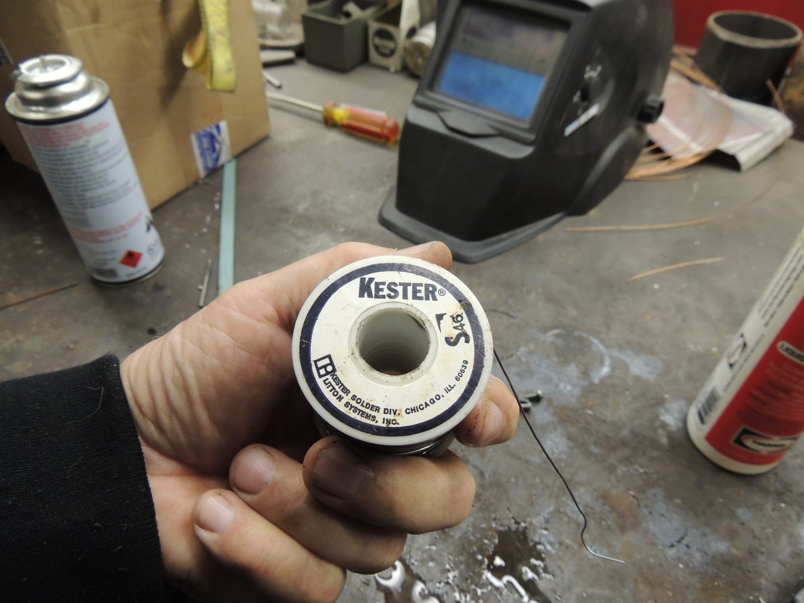

    I use silver solder and this flux when I want to solder steel together. I use the non-silver solder when doing copper. If you can find any on facebook that someone is selling, probably good to buy it and put it on the shelf before the "Save the World" fanatics find a way to outlaw it. What I've found is that you don't want to apply too much heat too quickly or it will turn black looking. Het slowly with a propane torch till the solder melts with no heat applied, then dance the flame over it as you add some more. Also, I made a "test" joint with a 5/16 to 3/8 tube and put a gage on it. 100 lbs held for more than a year and only lost about 5 lbs. Its still back in the shop somewhere. DSCN1616.JPG

    I used a similar flux/acid when silver soldering.
    Clean things shiny, wipe some in and as you said “heat slow and uniformly” just keep it hot enough to take the SS into the joint.
    It is kinda fun, and amazing on how well it bonds the two together.
