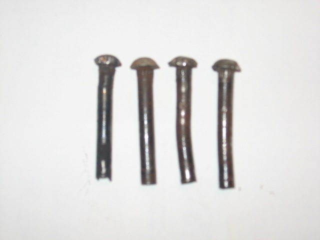

    Here's what my '31 coupe hinge pins looked like after we go them out. The top two, I'd already drilled out with a 12" long 1/4" bit for hing pin mirrors. Note that Model A original hinge pins are NOT 1/4" OD

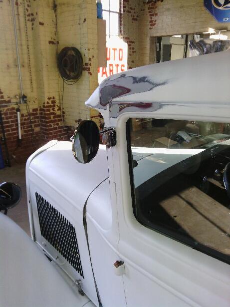

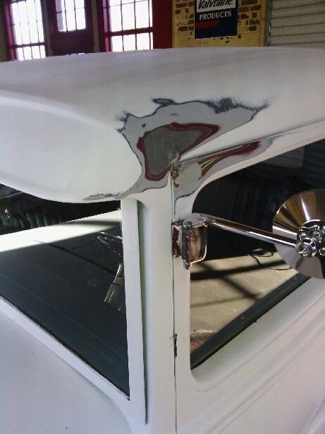

    Well...after many hours of drilling and using the tips I got here, I now have a mirror!!...yay!!!....never had so much trouble adding a mirror!!...first I tried a '"peep" mirror..but they wont work on these early fords...just no room in the jamb to accept the bracket...anyway..thanks to everybody here for the help and support!!...cant wait to remove them all to paint the coupe...yuck..:)''''enjoy the process...right?.thats why we do this....I think

    one more pic
