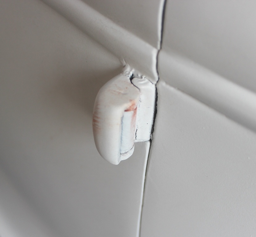

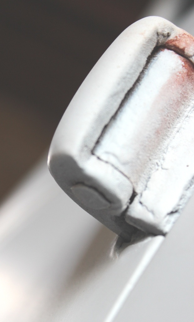

    ok..31Vicky has been asking about this door hinge pin I had to get out..I'm posting a pic of the other door hinge that has the same pin configuration...then I'm posting a pic of the other type of hinge pin which is the norm....each door had one of these headless pins with the bottom flange [which could be mushrooming from a hammer]...but the normal pins dont hang past the bottom of the hinge..so not sure how a person could mushroom the pin on the bottom??
  17. That almost looks like it was welded?
    That looks like a 40 penny nail
    Lots can happen in 80 some years.

    I agree something doesn't look right here. That doesn't look like the way it came off of Henry's line. You need to keep digging away at it.

    looks like the center of the pin might have a notch worn in it from use as the rust dust is a sign of wear . see if the door wiggles up and down if it does thats going to be part of the removal problem as your going to have to have someone move it up and down and in and out , while you try to find the sweet spot so the pin will walk out of the notch besides the knurl . and the one does look like its welded on top .
