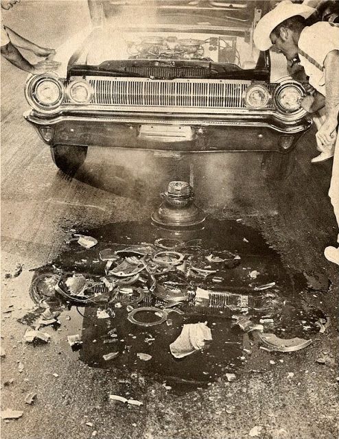

    I'll bet that was one heck of a explosion! HRP

    Bandit Billy
    Looks like that torque flight took flight.

  7. It isn't just automatics, I saw a Mustang with a small block, explode about 25 ft from the starting line after beating all comers all afternoon. I was grateful that he had a scattershield or he would have been severely injured. There was shrapnel everywhere. I am guessing that he got things too hot after multiple runs without a lot of cool down time.
    A friend of mine owned a transmission shop, and one occasion, a guy got a 727 so hot that it blew up just like the picture above. The converter had to be separated from the flex plate by cutting it apart.
    Seeing just one explosion makes one want to take better care of the equipment.

    Joined: Feb 28, 2008
    Posts: 2,098
    greybeard360
    On a TF they will do that if you do a burnout in low gear and let the tires hook up. If the rear end let's go while you are in low.... Same results.
    Sent from my Moto G Play using The H.A.M.B. mobile app
  20. squirrel
    Joined: Sep 23, 2004
    Posts: 59,655
    squirrel
    finally, someone who knows how Torqueflites work! :)
    A neutral drop can rip the back of the case out, or at least damage the roller clutch. But it won't make the drum explode immediately...to do that requires you to rev the engine over 5000 rpm with a non functioning roller clutch.

    Most times you see a 727 explode like the pix show it's because the rear end broke. With the reverse valve body all the pressure on first gear would unseat the spag and push it into the high RPM planetary. Instant hand grenade. At least that's what Chrysler engineers said when it happen to us. Len Silvers was one of the first to find out at National Trails Raceway in 1965. Everyone thought it a fluke, then more guys saw it happen that year. Ray Daily broke one at Mt. Vernon in 1970 so bad the convertor sawed it's way across the brake pedal into the kick panel and was found on top the valve cover. Big fire. Guys on the starting line got Ray out and saved the car. Not a pretty site when it happens.
