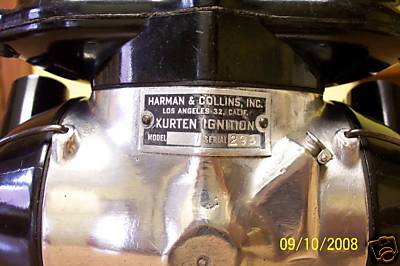

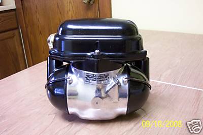

    HHmmm I was looking at getting a HC dual coil from a friend as well. Why are they paperweights....just because of modern stuff?
  17. Bruce Lancaster
    Joined: Oct 9, 2001
    Posts: 21,681
    Bruce Lancaster
    The '49-53 distributor UNDER the H&C dual coil remains a piece of junk with worthless advance...so the conversion using that is of little use for performance. The early Ford and Lincoln distributors provioded a good basis for modification with an excellent advance mechanism....

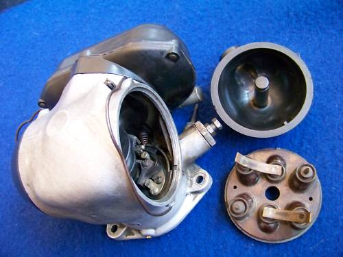

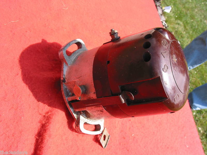

    I added a few pics so we all know what were talking about here. Pictured are the two most common methods of converting the V12 for V8 use.
    My opinion is: if your building or restoring period correct pre-war hot rod with a Ford V8 then your choices are limited to the Zephyr V12 conversion distributor and there was only the Spalding Bros. before the war, the Meyer Manual advance system, the Lucas available on English Fords, the Robert Bosch magneto, very pricey at the time and usually found of race engines like the Millers, Railtons etc. and lastly some exotic conversion for dual plugs like a Nash Twin 8 conversion as available from R&R Manufacturing.
    Mags were pretty rare and I haven't seen much mention of a V8 in any of the early SCTA or Throttle publication before the war. I have heard Scintilla made an angle drive for their mag before the war but I have yet to actually see the print ad for it or mention of a racer running it in print. I also haven't seen a pre-war Scintilla V8 mag, yet.
    I also included pics of some other early pre-war set-ups.
    The Ronco is the earliest V8 Ford mag I have seen, it is not pre-war. The Nash Twin Eight angle drive may not be pre-war either although the person I got it from swears up and down it is but I have my doubts.
    All that being said, the stock Ford V8 distributor even in its later crab cap design, with the divorced coil, just wouldn't provide enough spark as tuners began running the V8 above 4500 rpm.
    I have read about guys going to dual batteries to up the voltage to 12 volts but then the point bounce becoming an issue. That is why the better V12 conversion use the Bendix points or the Delco high speed points that were available before the war.
    FYI the Spalding's were gauranteed to 8000 rpm even in the pre-war ads.
    Let's face it most guys don't turn the wick up on their flatheads anyway so if your just driving your flathead around and you don't turn it beyond 4000 rpm you can get away with a '42 and later crab cap style dist. or of course any of the aftermarket stuff.
    If you are one of those who winds the hell out of your flattie I'm preaching to the choir, then your building a flathead that just happens to be a race motor and that means accurate timing or BANG! I fought a Zephyr dist and many of the other conversion before tearing the Zephyr apart. My first upgrade was to convert the breakers back to the double adjustable design of the V12 and to gut the coil. I then used the breakers to trigger a digital, programmable MSD pro box and two blaster coils mounted remotely. Which I then upgraded to dual coil packs that gave me more adjustability and I was able to 86 the Zephyr rotor; but it is a pain to hide the packs out of sight. That system worked great and it had multi step retard, rev and launch controls as well as other features I didn't use.
    All that is in a packing box now, as I finally switch over to a pre-war dual plug set-up.

    I believe tha vertex style mag was available in the early 1930's...I have a brochure somewhere advertising one angle (straight up) for 1932 and a slanted one for 1933-5 even including a new contact plate for original ignition switch. The 1935 cutoff date would mean it was published in '35, since that would also fit later ones.
    I have a dual coil (not twin plug) conversion somewhere that is a Nash-like conventional distrib mounted straight out of an early V8 base, I haven't seen the thing in years, but it's somewhere in the heap o' junk.
