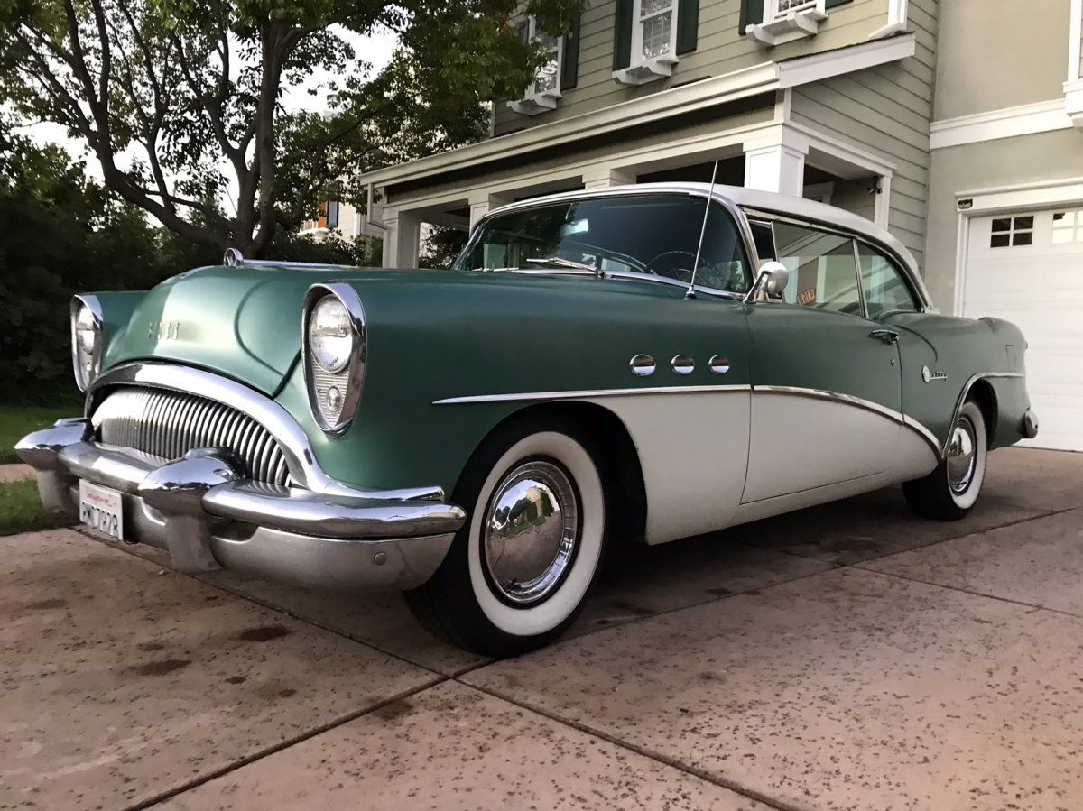

    I had the same problem on my '55 Buick with OE Chevy wheels and '55 Olds hubcaps. When I installed radial tires (BFG T/A wide whites) you could hear the hubcaps moving around as the wheels flexed in slow corners. I spent some time carefully spreading the hubcap tangs so that the hubcaps fit TIGHT. That stopped the noise and the loss of the hubcaps.

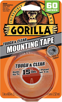

    upload_2020-11-2_9-11-6.png new stuff to help with an old problem...
    Hello,
    Back in the old days, there were wire lug nut devices to keep the hubcaps from flying off. That was great, but the hubcap stayed going around with the wheel and banged the **** out of the cap surface. So, those wires did not last long. Then we jammed cardboard between the metal tabs and the steel wheel. Great fit, they were snug and stayed on long enough for the next car wash or puddle. Finally, it was little tabs of waterproof glue in a pattern all around those metal tabs.
    But, if the hubcap was going to be changed for another set of spinners or designs, then the glue had to be broken to get the hubcap off. Hopefully, you won't have a flat tire, either. That became a h***le. My brother solved that problem with a set of screw in Moon Discs that made any car look fast.
    A new solution to this or any displaced item is solved by quality double sided tape.
    I had a long edging I needed to reattach to an upside down surface. The ½ round molding had worn out the skimpy tape from the factory. I used this tough and clear mounting tape from the Gorilla Products line. It is a little thicker, but ever so sticky. The upside down edging stayed in place in heat and moisture. This stuff is very strong as is most Gorilla Products. So, minimal little tabs around the whole circular hubcap will keep it in place. It is removable, if needed. No need for screws, tapping or altering the hubcap for any wheel surfaces.
    Jnaki
    If the little tabs are placed in various areas of the hubcap tabs, it will hold well and shouldn’t come off, even with moisture or bumps. Instead of long strips, a pattern of little tabs would probably work better, distributing the attachment points, all around. YRMV
