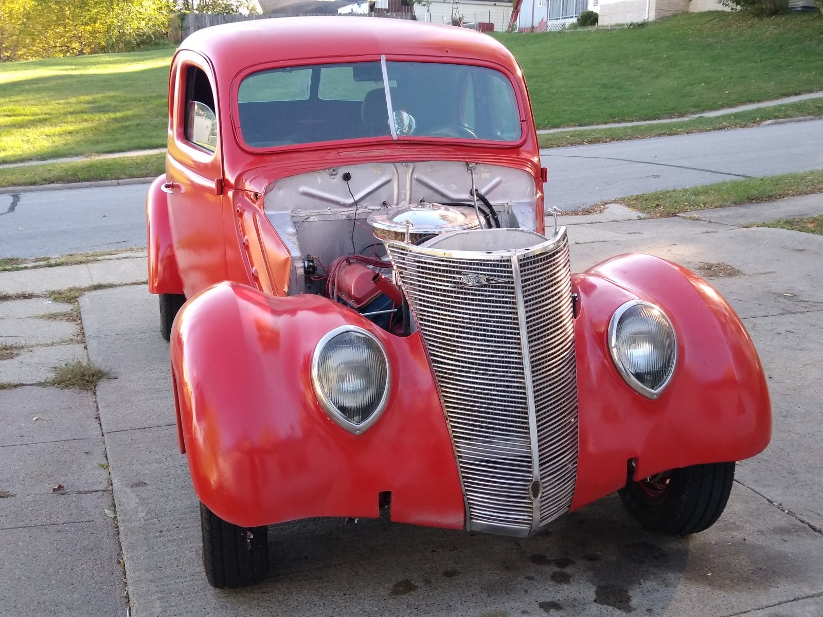

    Took my 1937 Ford coupe out for a test drive today. The front wheels shimmy so bad that I had to keep it below 30 mph! Then the 430 Lincoln motor runs horrible unless I floor it. Gonna leave it be for a few days, try to get some ambition to see what's going on. And I thought it was nearing completion. IMG_20211013_163735625.jpg

    Hard to tell from the pic, but it looks like too much toe out on the front tires.
    And those tail lights? Not feeling any love for them is all I’ll say....

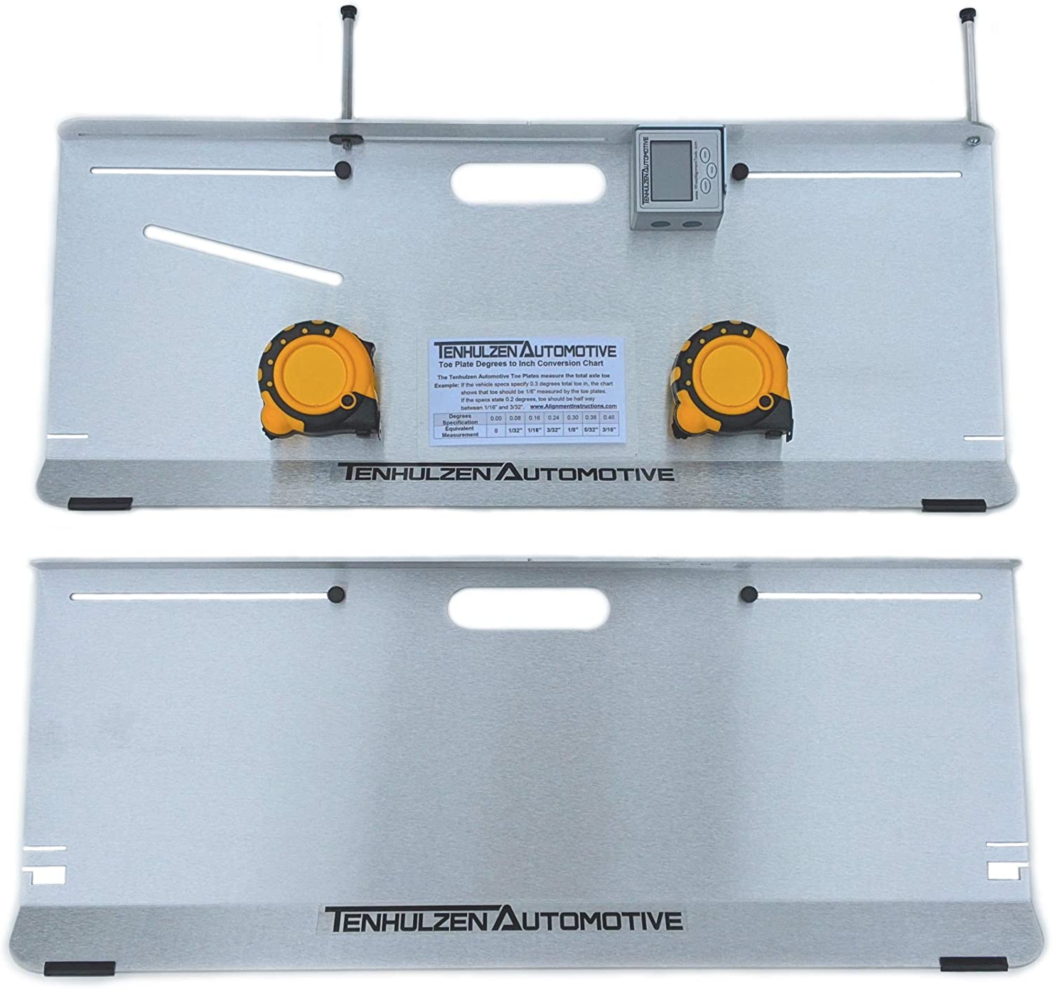

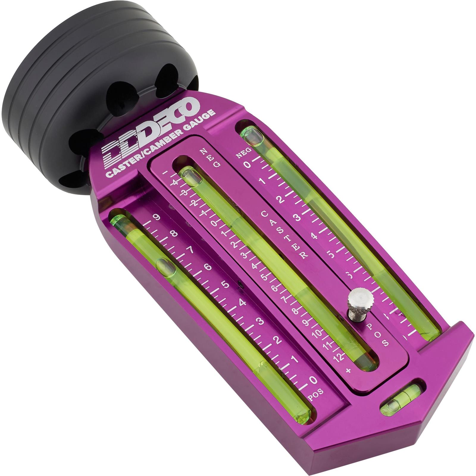

    I used to set toe in/out by eye just to get my car on the road. Some people use the old string method
    which works if you have two people. I ended up seeing this from another Hamb member and purchased
    one. It truly is a one man operation, very easy to use. (It does run around $200, but I have used it so
    many times, I have gotten my money out of it, plus loaned it out many times. It will do caster and camber
    as well. Another great tool is pictured just for caster and camber. Purchased it from Speedway and it has

    I did look at the coupe today. As for the engine running like sh t, I checked the gap and found it had worn the rubbing block and the contact surface was pitted. So I cleaned the points up with some fine Emory cloth, set them at .016". Now it runs really good and sounds like a 430 with the 428cj grind should. The severe shimmy was a little harder to find. I set up 4 stands and strings to measure the toe. It has 3/4" toe in! So I will reset it tomorrow. I then jacked up the front axle and adjusted the brakes. They were too tight. Then I put a stand close to the side of the tires. I found the right front wheel is over 1/4" horizontal runout. I do have a new wheel to mount the tire on, but I will probably just switch it with the rear wheel to see if it helps. Thank you for all your help. Wish I could buy you a beer!

    I do have the caster camber gauge. Works great
