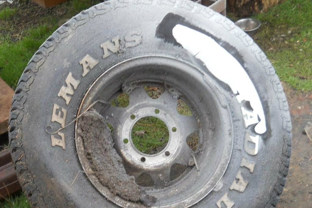

    All you have to do is look at any White letter tire that has scuffed a few curbs Model T1 and it becomes obvious that there is a layer of white under a thin layer of black that they actually buff the black off the tops of the letters on at the factory.
    I went out in my tire pile and dug out a junk white letter tire.
    I took my 7 inch angle grinder to it with a 36 grit disk.
    One thing that you might run into is that on the white letter tires they don't always get the seam on the white all that close when they cover it up with black.
    Now I smell like burnt rubber :D
