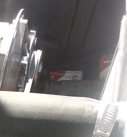

    You’d be even cooler if you’d carry these differently. IMG_2202.jpeg IMG_2203.jpeg

    I was actually zooming in to talk about the curved tips on the fan blades. That makes a big difference in pulling air.

  14. Im being a lil more OCD on the important stuff on this car because it'll be a true daily driver lol
  15. I had far more trouble finding that fan than I should have lol. People I'd message about one wouldn't take me seriously lol. Finally found this one from a guy selling the original engine from his 57 Chevy four door hardtop that he was ls swapping. Turns out he'd already sold the engine and mentioned he only had a few of the engine related parts left. He gave me this fan and a good 57 Chevy generator lol. Long story short it's just a stock 57 Chevy fan
