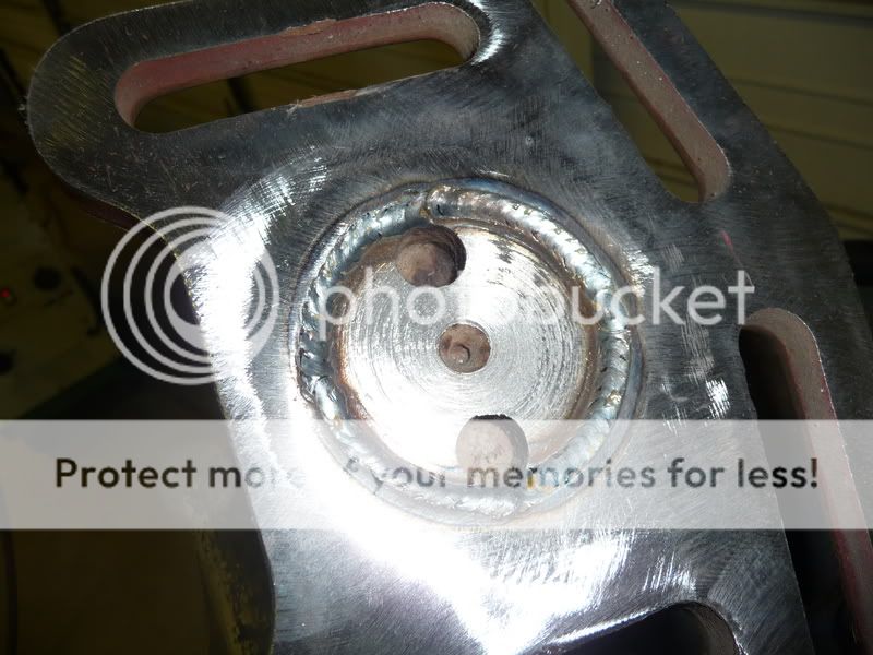

    I did this with no pulse, just good hand eye coordination and 28 years of experience. I try to make every weld I do look like this:

    For all the guys who want to argue that mig welding is just as good or better than TIG welding.......When you can make your mig welds look like this, let us know!...until then, Nuff said!!.....by the way these are not mine they were done by another HAMB member
