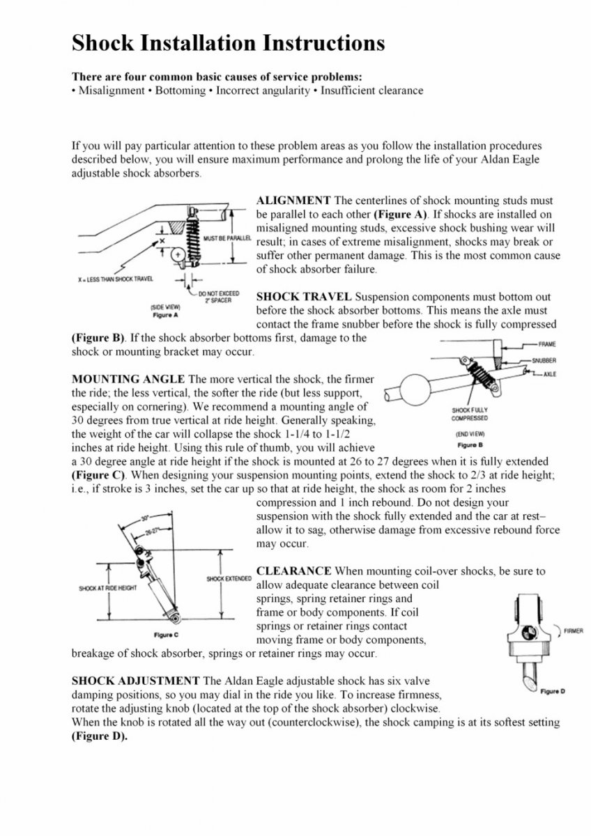

    Shock are most effective as shocks when perpendicular.
    However mounting them further and further away from the wheel lessens there ability to control that wheel. A compromise is to mount as close to wheel as possible and angle them for clearance. The compensation for angle mount is to increase the dampening ratios or spring rate in coil overs. Mounting them at angle also creates diagonal stability and although they are adjustable they still provide because of dampening. Now a shock absorber just became more than it is in vertical.
    If you are a fancy CAD guy -
    Plot the levers and ratios in play on the OP's ride.
    First the wheel to wish bone mount on the long axle.
    The wishbone itself - frame mount to axle.
    And put in the lower shock mount on the bone behind the axle.
    How much does the wheel need move up before the shock compresses 1/8" (enough to take up the internal slop and bushings and compliance in the bone) and actually begin working as a shock Absorber.

    As soon as one wheel rises on a beam axle, a perpendicular shock absorber is now on an obtuse angle, decreasing its effectiveness.
    If you mount them on an acute angle, when one side of the beam rises, the shock moves TOWARD perpendicular, INCREASING its effectiveness.
