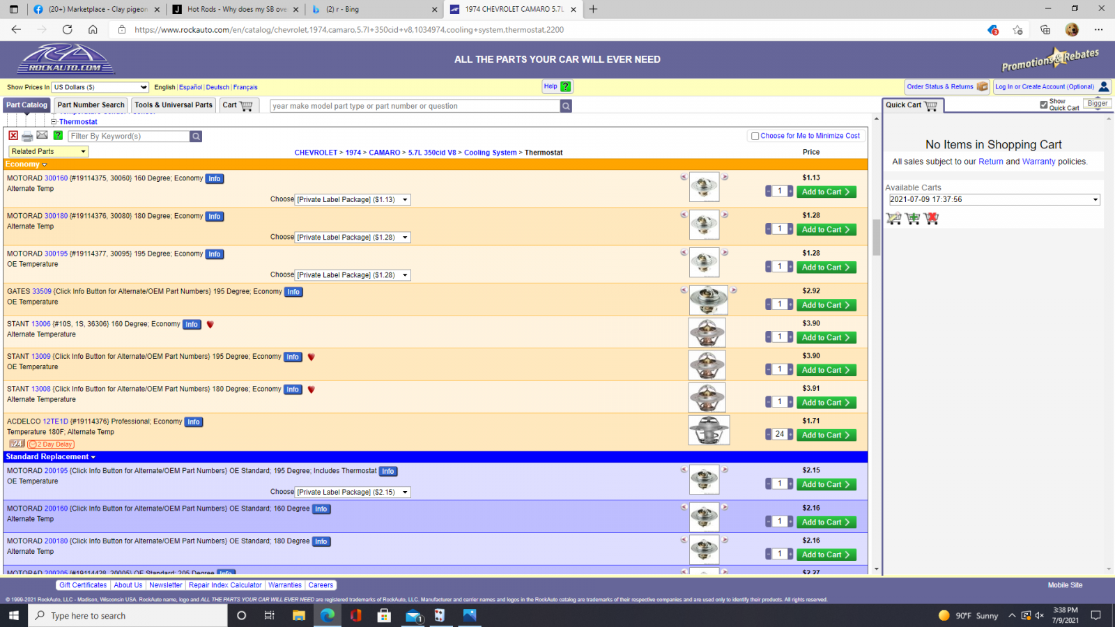

  6. Mr48chev
    Joined: Dec 28, 2007
    Posts: 35,818
    Mr48chev
    74 Camaro thermostat .png I can never figure out why you guys piss all over your shoes over an engine running 200 degrees after you put it in an old vehicle when that same damned engine ran over 200 all the time in the vehicle it came in without and issue. 200 isn't hot for a 350. Puking coolant on the ground in traffic is hot for a 350. You don't have a 216 in it anymore sodon't react like it was a 216.
    From the 74 Camaro 350 thermostat listing on Rock Auto. Standard temp thermostat for a 74 Camaro is 195 and if that engine is running at 195/200 it is running at the normal operating temp for the Camaro it came out of.
    kevinrevin, jaracer, brianf31 and 4 others like this.

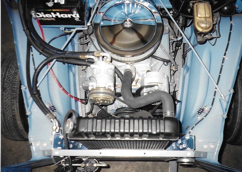

    Your set up is very much like the one I did 30 yrs ago except mine has a brass radiator (a crossflow stood upright) and a mechanical flex fan (probably from a AC equipped AMC car). Mine worked out well and didn't get hot at all idling around GoodGuys-Des Moines in 90+ degree heat.
    Gary
    bchctybob and Elcohaulic like this.

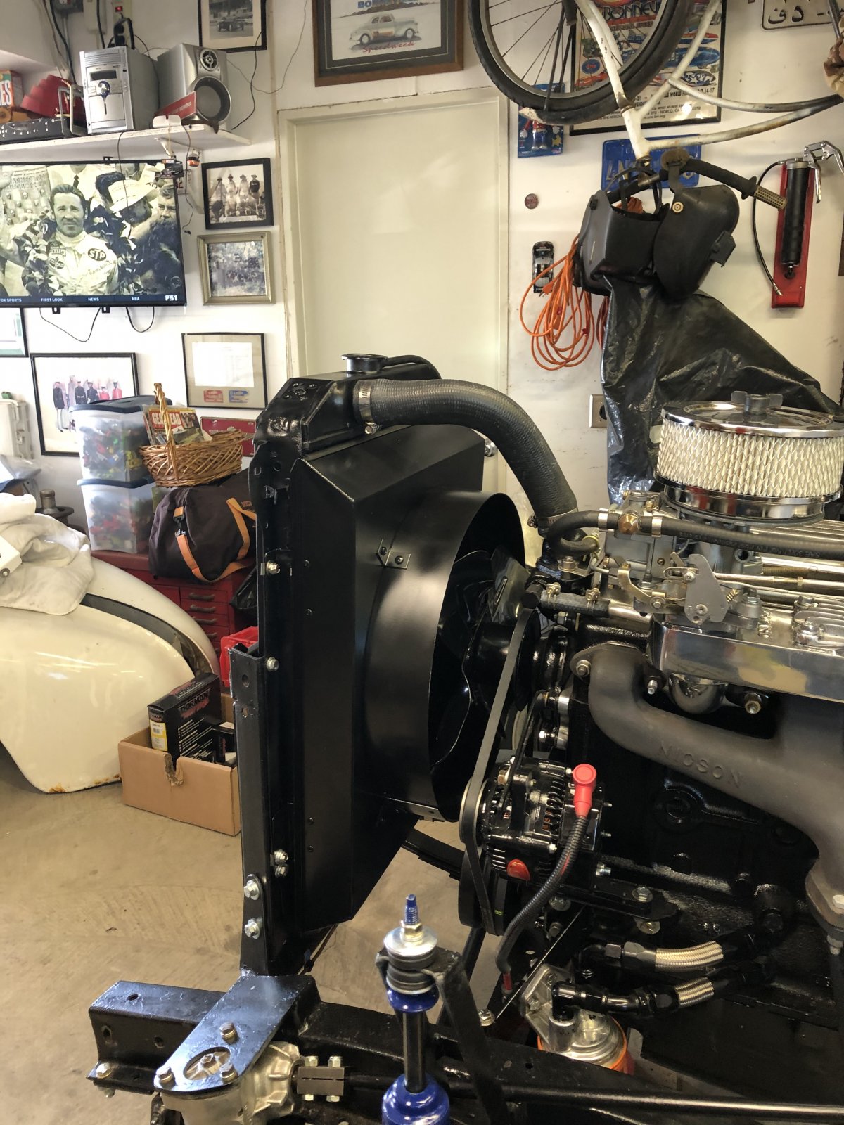

    I'll speak to the 4 row radiator:
    More rows in the same thickness radiator means less cooling and more resistance to airflow. A typical 3" thick aluminum radiator with two 1" rows has more surface area than the same 3" thick rad with four 1/2" rows.
    To the electric fan:
    A shallow fan has to spin very fast to achieve its rated CFM airflow. A fast spinning shallow fan has very little pull through a restrictive 4 row radiator. You need depth to get air velocity.
