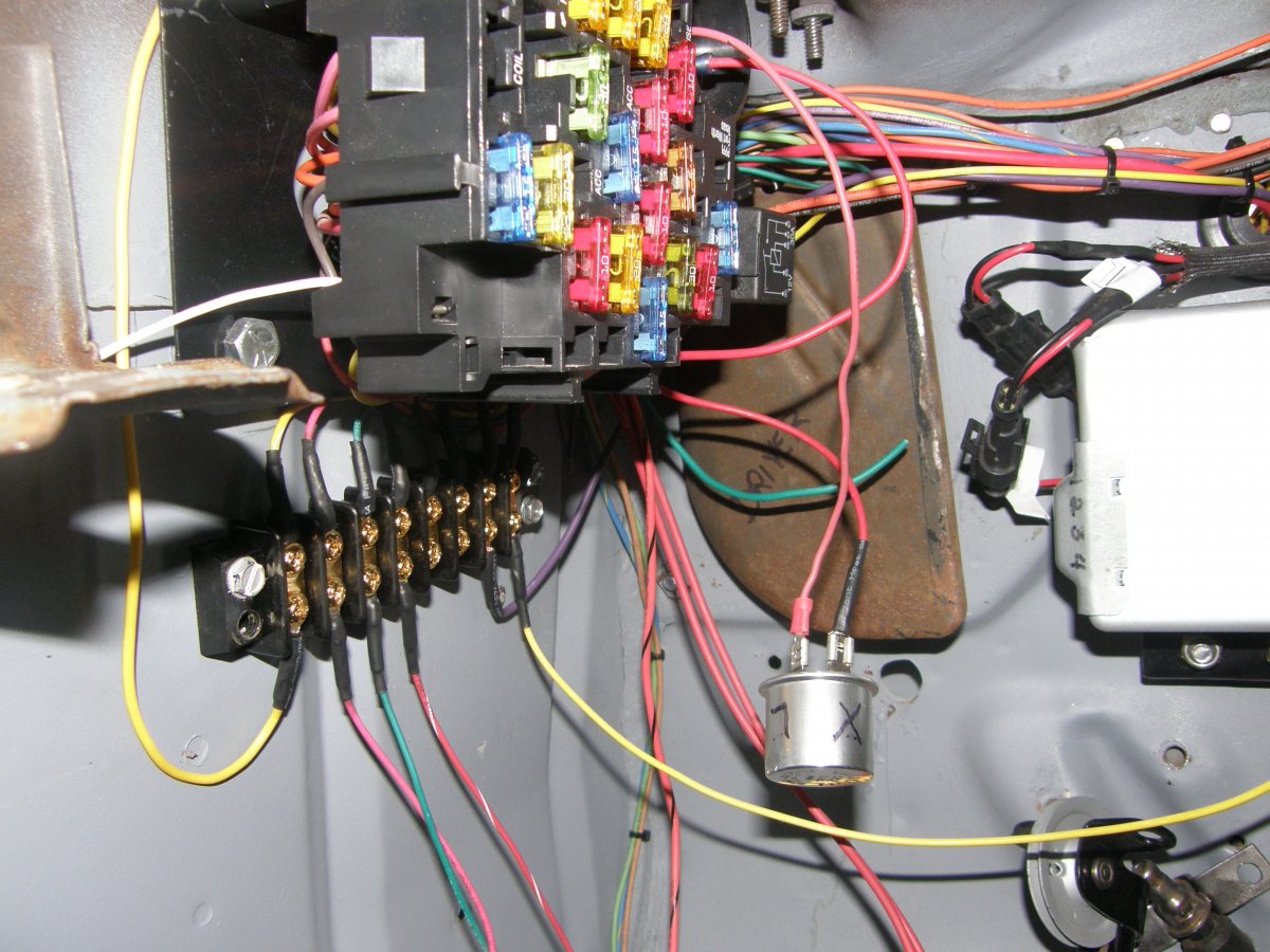

    Pulled the flasher and the lower tang gets 12v. I also installed the second hazard flasher.
    With the flasher installed I'm getting 12v on both sides with the turn signal lever in any of the three positions. That ain't right! The flasher only goes in one way so I pulled the flasher and ran jumper wires so I could switch polarity. Same thing. 12v on both sides. I also replaced the flasher. Same thing.

    No. I wanted to check for power at my fusebox. So with the flasher not installed, I metered the two connectors in the fusebox and got 12v out of the lower connector which, ironically corresponds with the 'L' terminal on the flasher. The other connector I got 0v.
    Next, I ran jumper wires from the two connectors in the box to the two terminals on the flasher, measured at both flasher terminals and that's where I got 12v on both sides.

    My fuse box is wired hot at all times. With the key in the 'off'' position I took a reading from lower socket terminal, with flasher unplugged I get 12v and 0v at the other terminal.
    I rigged jumper wires so I can take a reading from the socket terminals without actually plugging in the flasher into the socket. With the key in the 'on' position, I get 12v from both socket terminals. I swap the 'X' and 'L' wires at the flasher and get 12v from both socket terminals.
