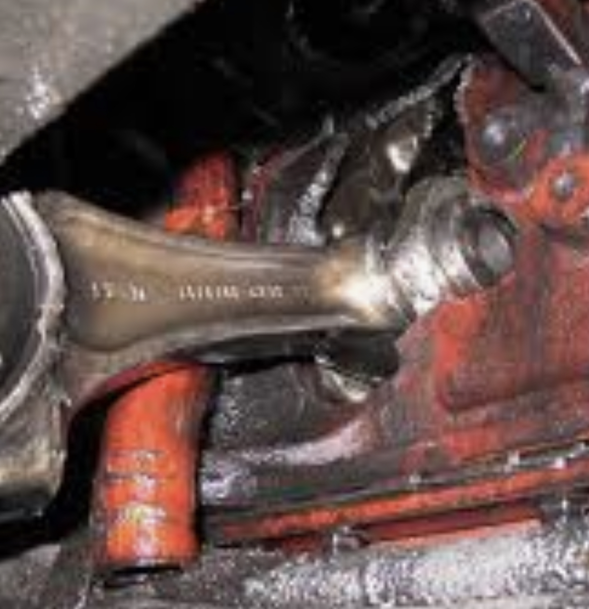

  25. What my engine would look like after testing that theory
