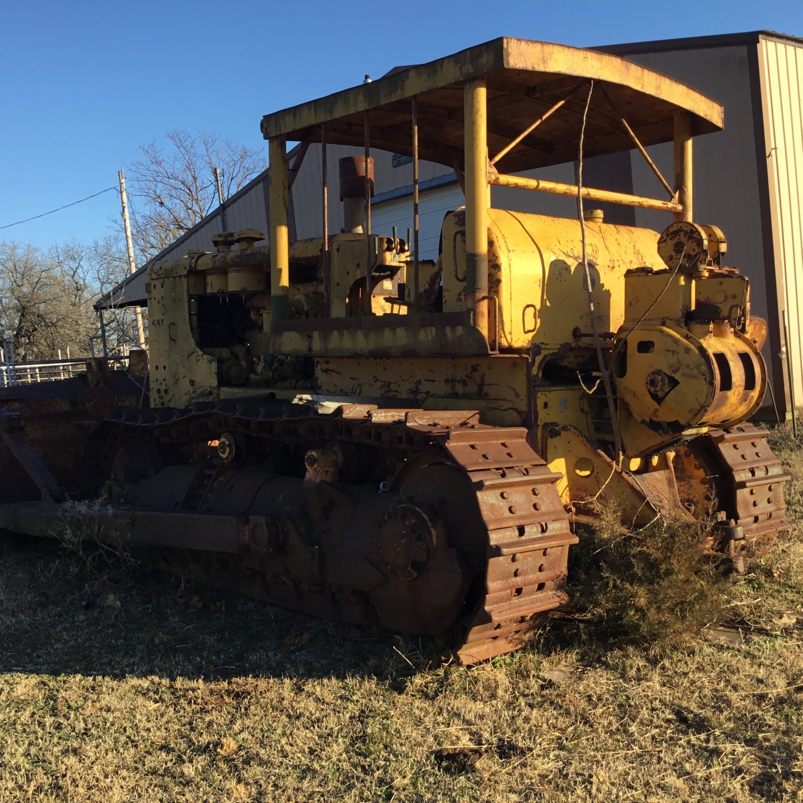

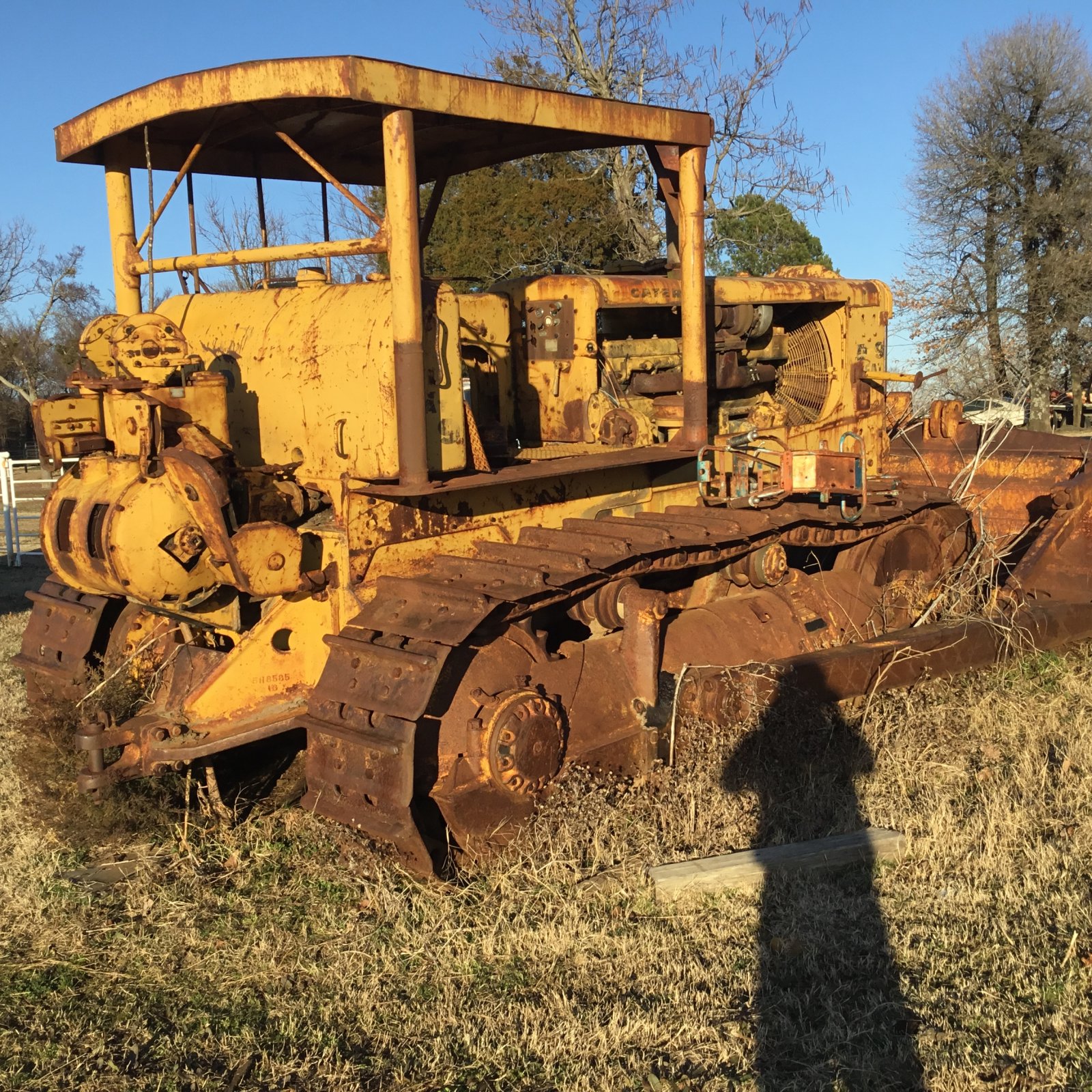

    Look just like our old D-9 Dozer!
    Bones CE7E4010-990A-43DF-A857-C75BD4FB52E8.jpeg C90283FD-5816-48EC-BE28-ED90CB9FC1D4.jpeg
  11. MeanGene427

  12. Boneyard51
    Joined: Dec 10, 2017
    Posts: 6,756
    Boneyard51
    60B4CA65-5B3F-4E00-ABDC-88D40137407B.jpeg 694223A8-47D6-4B07-AAF4-4FAD27124EA0.jpeg
    Thanks, she was a workhorse on the ranch!
