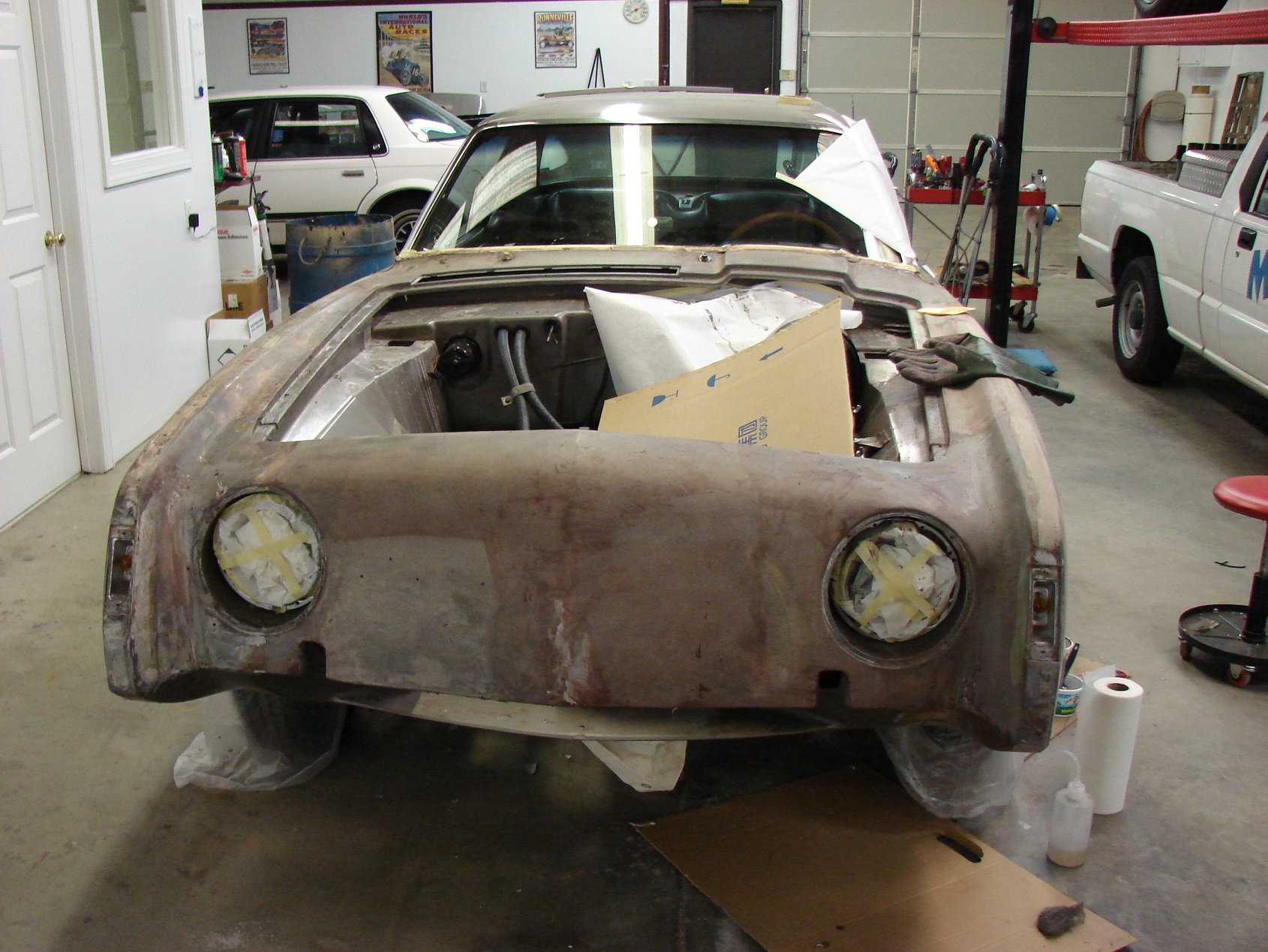

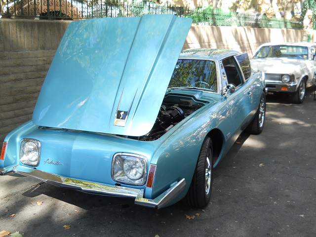

    When I bought a low mileage,(42,000) Studebaker Avanti a couple of years ago, I knew it had a few flaws and would need some work but it was a 4 speed supercharged car so I thought it would be worth it. It had an oil leak and low oil pressure.
    One day,soon after I bought it, I drove it into my shop and put it on the lift. I was only going to replace the pan gasket and check the bearings to see if there was any damage because of the low oil pressure.
    Here`s what I found.
    Well, nothing to do but pull the motor and find out what is causing the low oil pressure.
    The Studebaker V-8 engines have a few quirks that other engines don`t have. One is an external oil pressure relief valve located on the right side of the engine. I first pulled it out to see if that was the problem. Not only was the valve that is made with a spring and piston stuck, but somebody had managed to put TWO pistons and TWO springs in the hole.
    According to the records I got with the car, it had only been driven about 300 miles since the motor was re-built in 1983. I guess the previous owners were afraid to drive the car because of the oil pressure problem.
    After doing some research,I found the problem. There are two oil passages that run from the front to the rear of the block. They have a 3/8" pipe plug on each end, or should have. Whoever built the engine the last time forgot to replace the one in the back of the block behind the distributor. It`s located behind a freeze plug and if you don`t put it in the oil just runs back into the oil pan.
    Nothing to do but completely rebuild it.

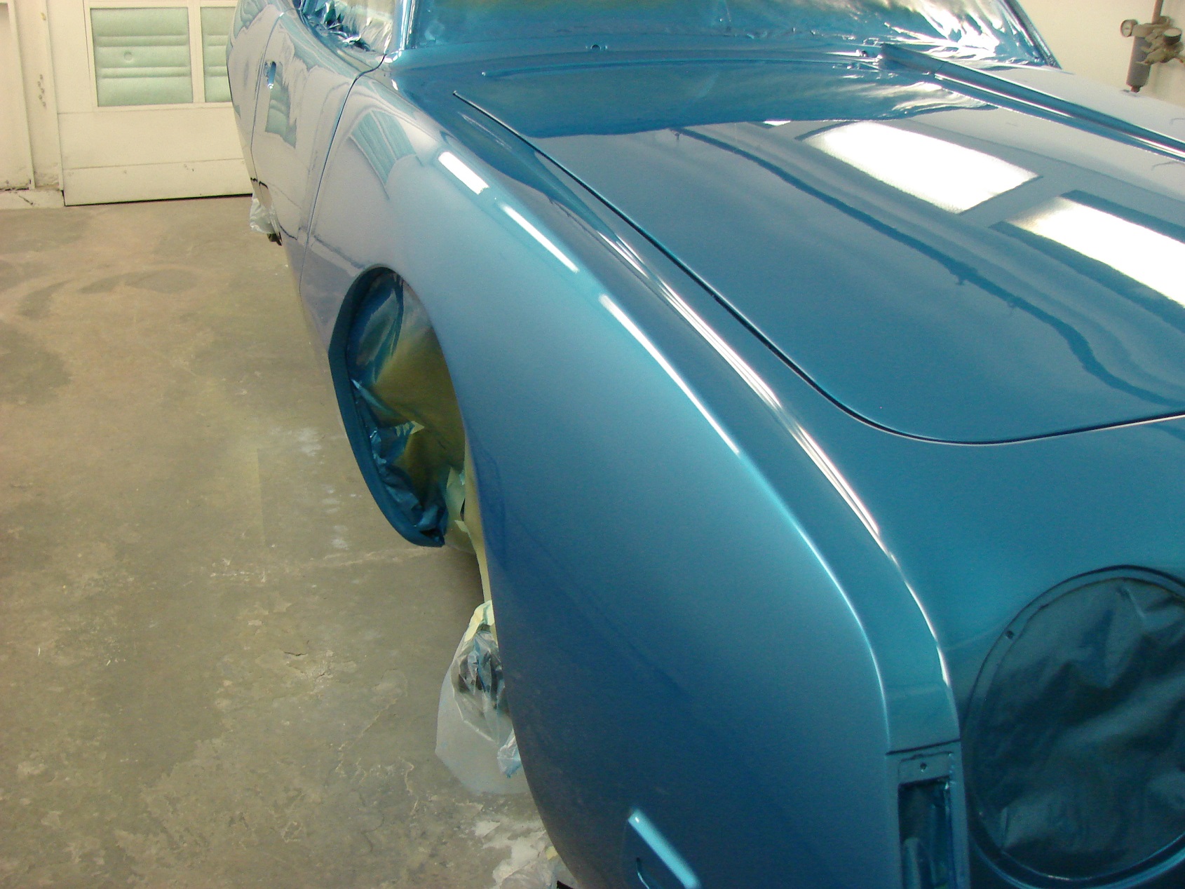

    Now I wanted to clean up the engine compartment and paint it. Many cars have a black engine compartment, but the Avanti`s is painted body color.
    Now I didn`t really like the color on the car when I bought it, but now I have to decide whether to just re install the engine or paint the car. Remember the spittoon?
    Here we go.

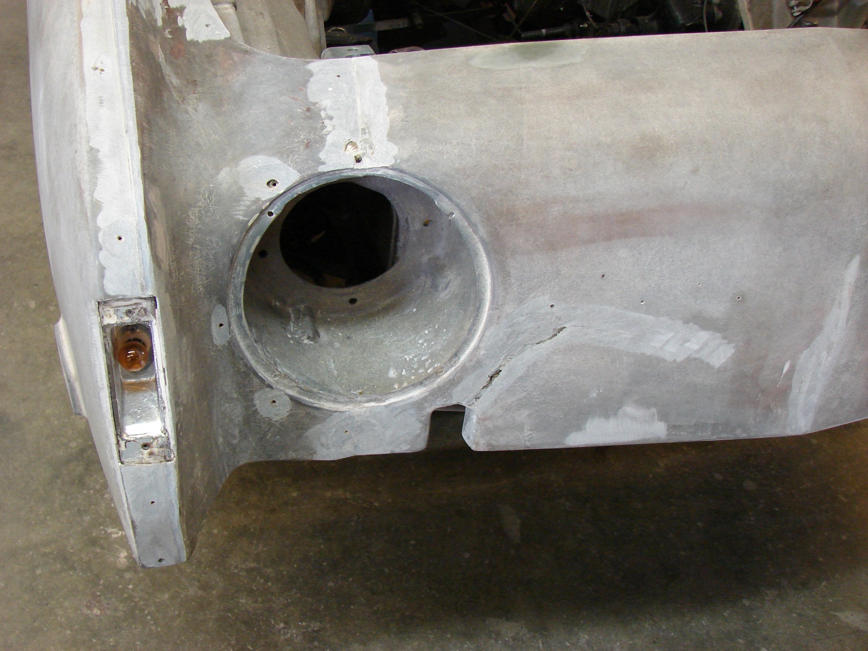

    Once I started to strip the car I found previous body damage. This is not unusual for a high performance `60 car. I`ve restored quite a few Corvettes and almost every one had some front end damage.
    After removing several dozen sheet metal screws that the last "body man" shouldn`t have left in, I began the repair.
    I only used fiberglass for the repair so it wouldn`t show up after it was finished.

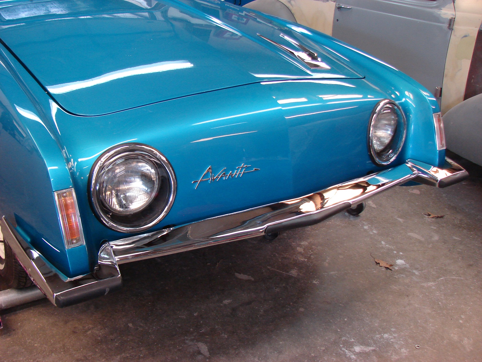

    Now the body looks great, but the bumpers need to be re chromed. And what about the stainless trim, it needs to be polished and new emblems? There`s nowhere to stop now.
    And while I`m at it all of the weather strip is 50 years old and needs to be replaced.And what about the interior, it`s got to come out.

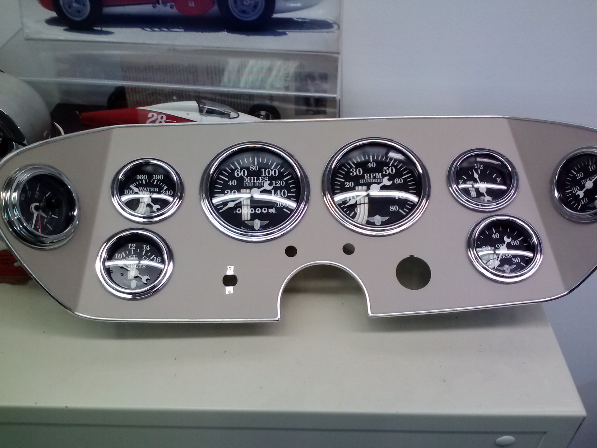

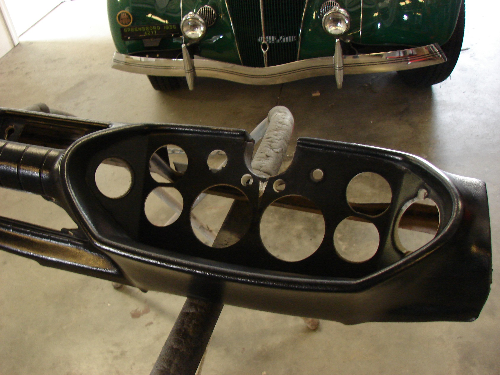

    It needed some sound deadening and insulation since I have the interior out anyway. Why not pull the dash out and dye it. And I might as well replace the instruments with new ones. And why not replace the cheap vinyl on the instrument panel with real wood veneer?
    Now is a good time to replace the wiring harness since I had to pull it out anyway.
    I might as well add A/C while I`m at it.
    Now that I`ve pulled all of the upholstery out , it will need to be replaced.
    And that`s why a Studebaker Avanti is like a spittoon :)
