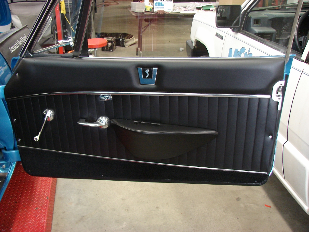

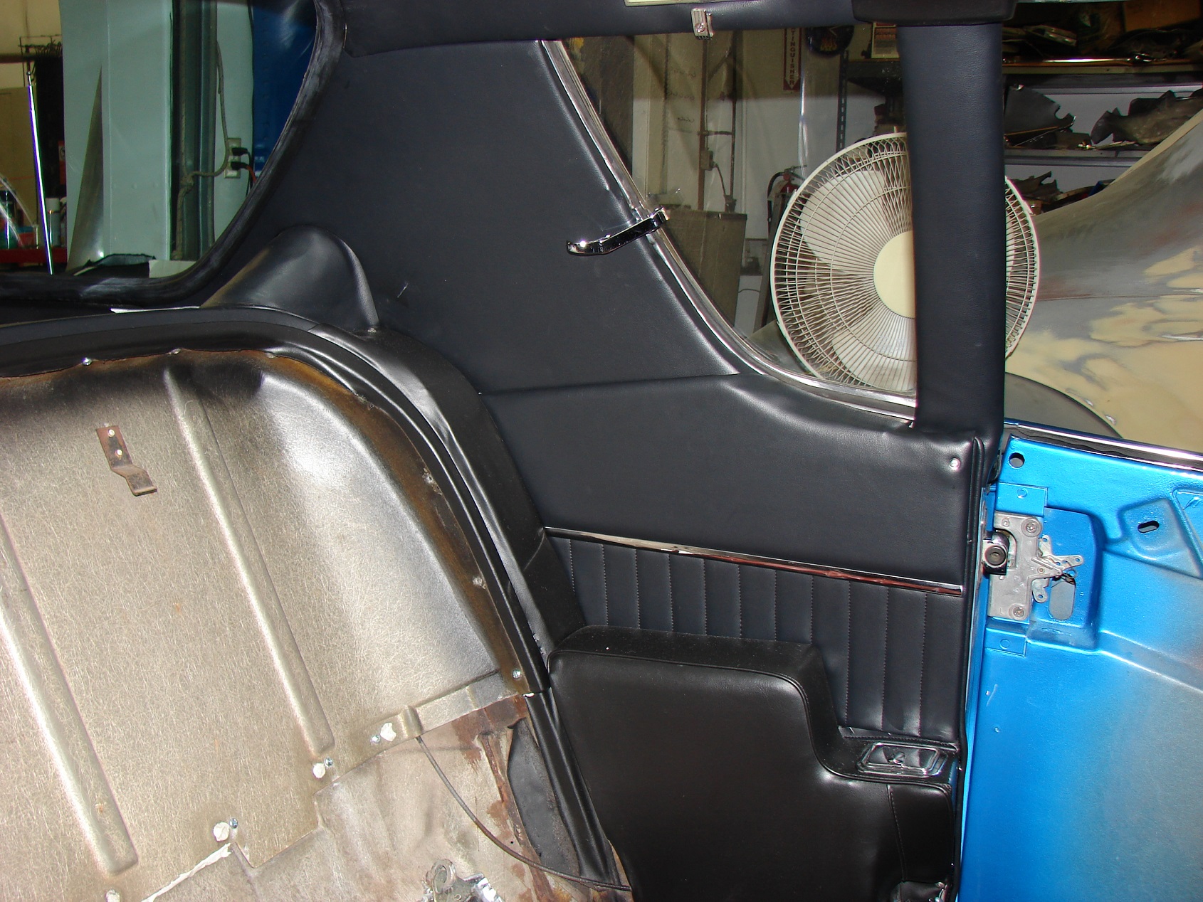

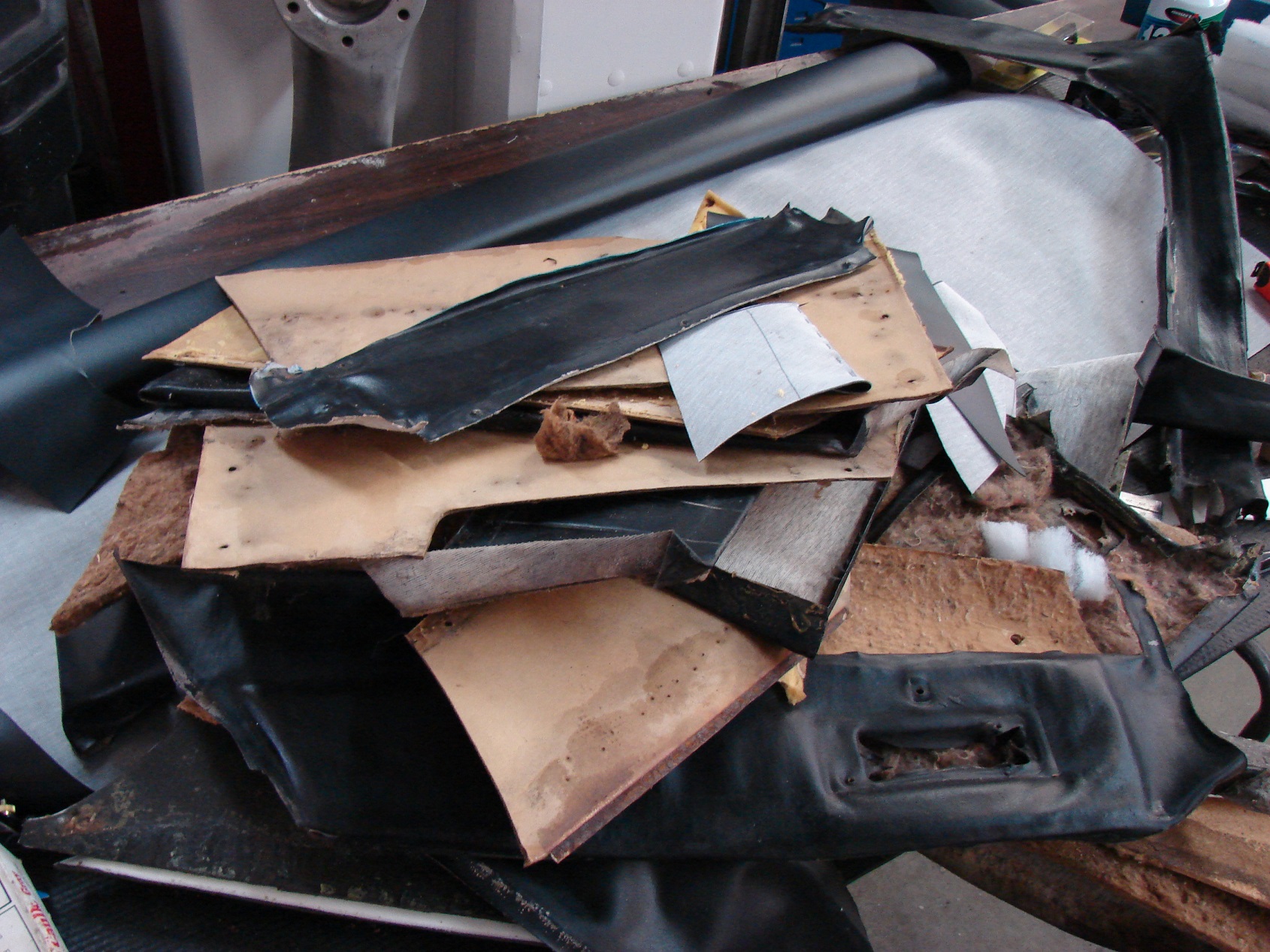

    Well, I pulled all of the upholstery out and started to make new panels. I`ve never done this before but we just bought a new industrial sewing machine and I`m not going to learn how to do this unless I try.
    I bought some vinyl material and some board and using the old pieces for patterns, I cut out the new pieces with a utility knife and our metal shear.
    Covering them wasn`t too hard, I first glued 1/8" foam to the board and stretched the vinyl over the edges and stapled it using 1/4" staples.
    Here`s a picture of the other side.
    The bottom part of the panel originally had pleats. When I first made the panel I thought I would just leave the bottom plain but after seeing how it would look next to the door panel, I decided to add the pleats. I removed the chrome strips and Steve sewed through the fabric and the board. That`s one strong sewing machine.
    And here`s what it looks like in the car.
    I made the other panels the same way, but they were easier because except for the door panels, they were all flat.
    I bought a new set of carpets because they about as cheap already made as the carpet was by the yard.
    Now I know that I don`t have the skills yet to make the seat covers so I ordered a new set . I haven`t started on the door panels yet, but maybe I`ll have time next week.

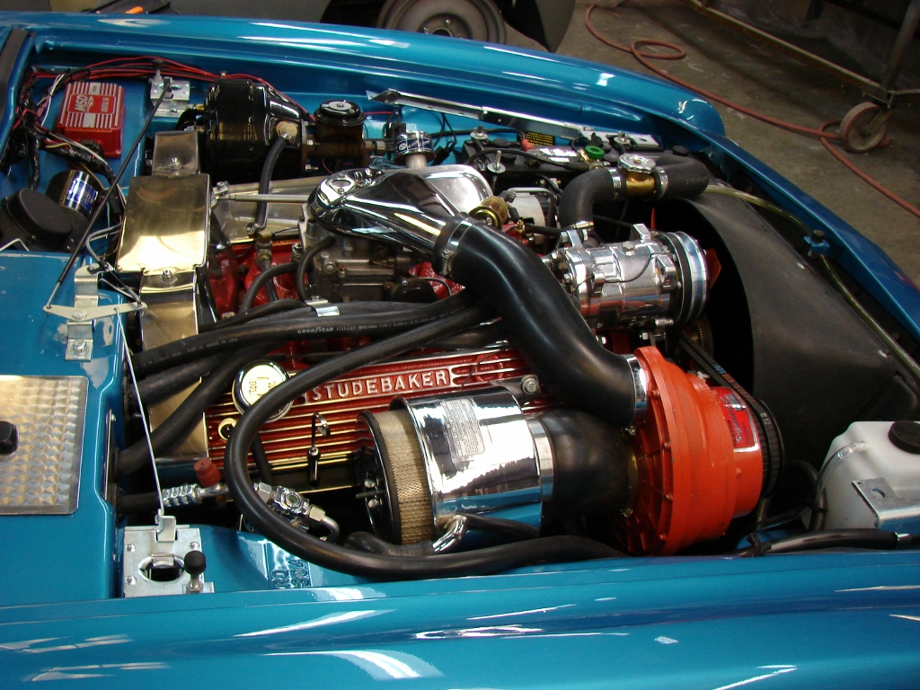

    Here are some recent pictures. After two years and more money than I want my wife to know about, I`m almost finished with this car. I`ve added A/C which was a pain in the ass, but well worth the trouble. Everything is new or rebuilt now so it`s time to drive and enjoy it. View attachment 2773907 003 (1024x768).jpg 006 (1024x768).jpg 008 (1024x768).jpg 004 (1024x768).jpg 005 (1024x768).jpg

    Beautiful car. I'm no avanti fan or expert, is that a blower?
    Avanti means forward, in the sence of going or get up and go?

    Yes, it has a supercharger,it came like that from the factory. Supercharges were installed on some Studebakers starting in 1957 and up until they went out of business.

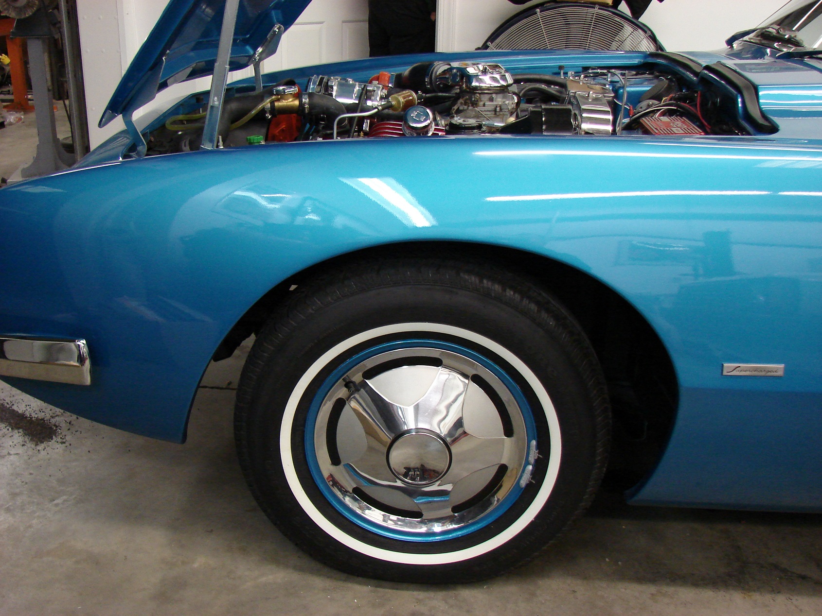

    I just couldn`t live with those wheel covers, so I had to change to these wheels. Real knock offs . DSC04135.JPG DSC04045.JPG

    Super-nice job! The knock-offs look fantastic. Didn't the factory offer them, or are these re-pops / modern versions? Gary

    The dealers offered something similar, but I bought these from Vintage Wheels in San Diego.
