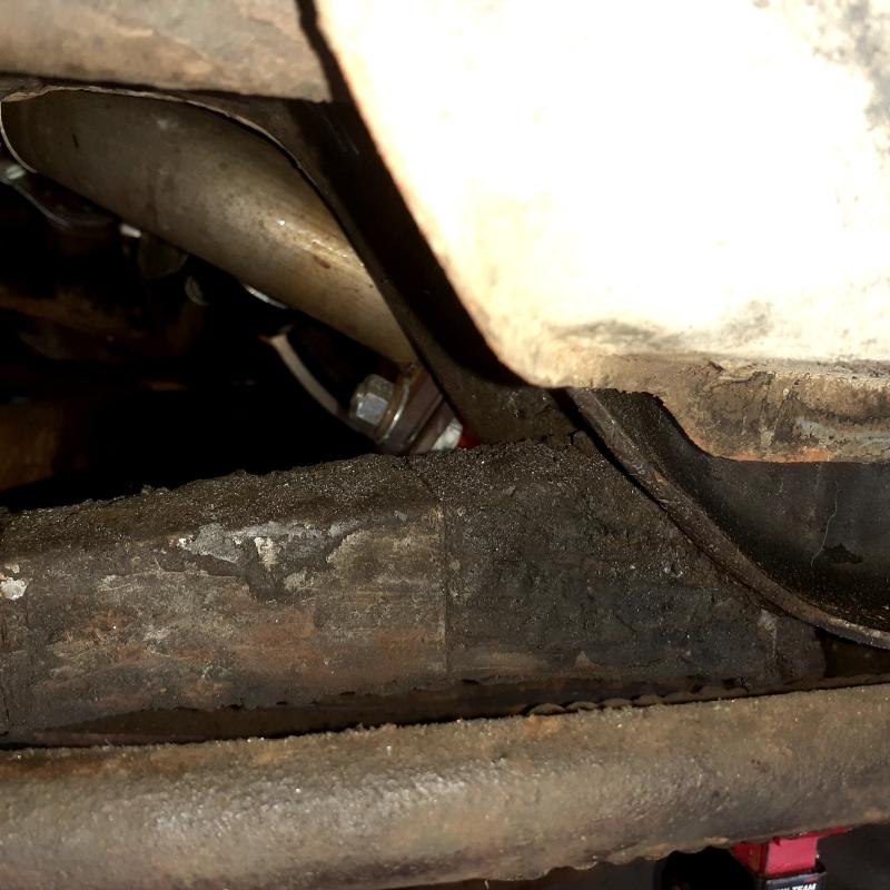

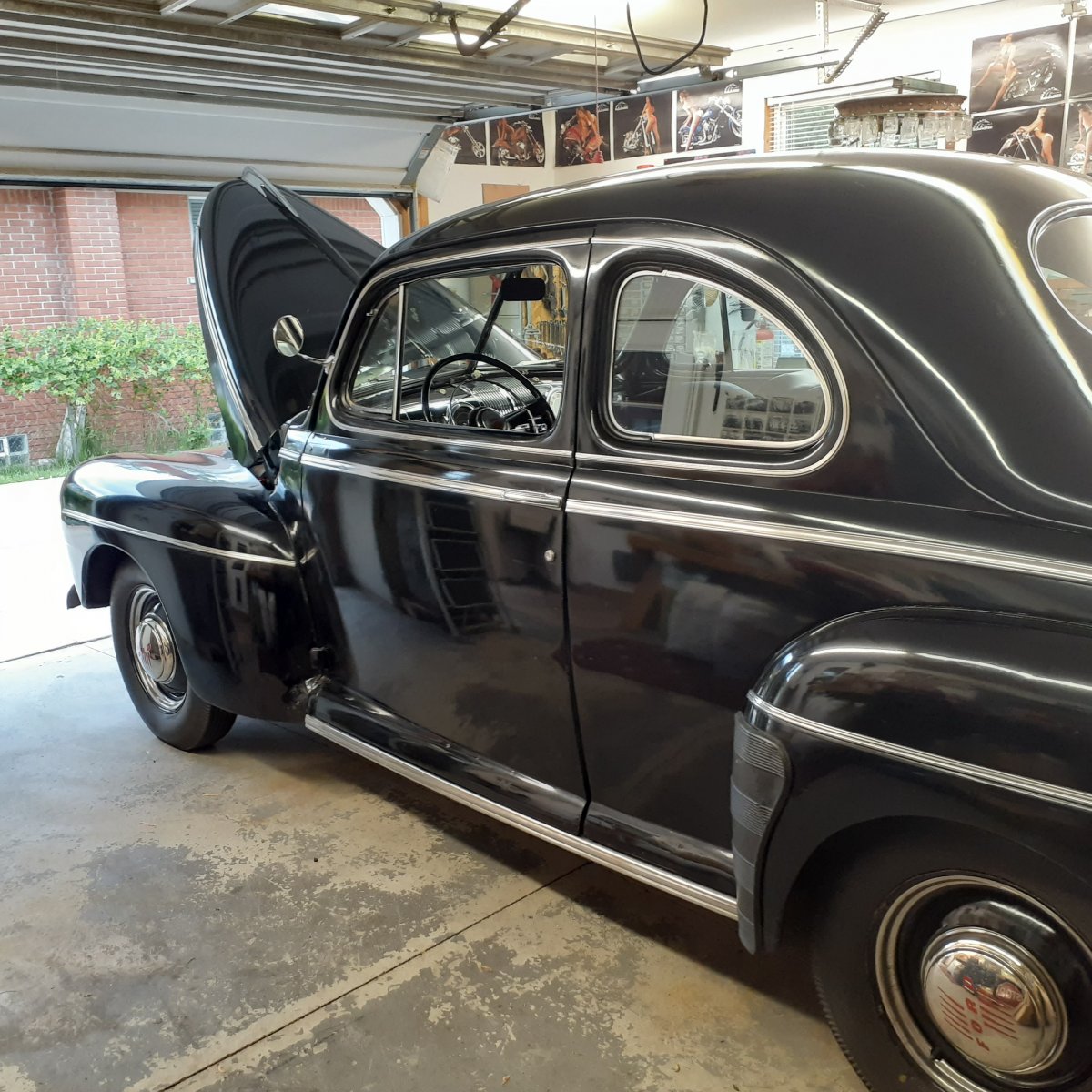

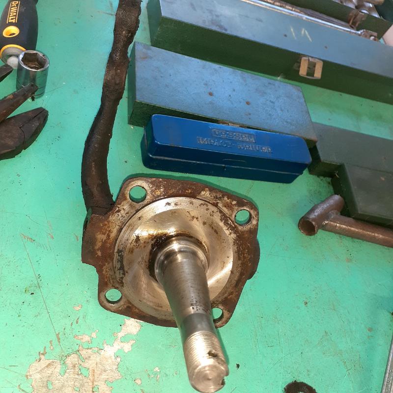

    20200601_182149(1)(1) (1).jpeg Resized_20200817_165327.jpeg Resized_20200817_165423.jpeg Resized_20200817_165446.jpeg Dropped spindles ? 6.00/16 shoes front and back. I doubt the springs were altered as they are still factory wrapped.

    nother shot

    no such thing as dropped sprindles for those, dropped axles yes, show us a pic of the ends of the axle.
    actually looks pretty normal to me and springs do sag with time and use....

  7. flatford39
    Joined: Dec 3, 2006
    Posts: 2,799
    flatford39
    My guess is the front spring is sagging. No biggy you can get them re-arched by a spring shot but actually it looks OK like that. What's it like to drive???

  8. blowby
    Joined: Dec 27, 2012
    Posts: 8,663
    blowby
    from Nicasio Ca
    That spring on the hook is stock?
  9. sawbuck
    Joined: Oct 14, 2006
    Posts: 1,912
    sawbuck
    from 06492 ct
    this
  10. Mmm, looks like some kind of aftermarket overload/helper spring. Why?
    Moriarity and Hnstray like this.

  12. seb fontana
    Joined: Sep 1, 2005
    Posts: 9,111
    seb fontana
    from ct
    Yes overload helper springs, one on each side. I thought the Moonshiners used them on the rear but I see made for the front too. I suppose you could try cranking the nuts on the helper springs eye bolt.
    Moriarity likes this.
  13. That would be a free experiment.

  14. Hnstray
    Joined: Aug 23, 2009
    Posts: 12,355
    Hnstray
    from Quincy, IL
    @khead47 .....uhmmm.....I fail to see the problem. Looks GREAT to my eyes!
    Many decades ago, I had a ‘46 sedan that, shortly after I bought it (1960) it unceremoniously broke a significant leaf in the front spring. Instant California Rake! Did I complain? Did I lament my bad fortune? NO! it had a panhard bar, though I did not know the name of it at the time, and I understood my good fortune. Being a broke teenager, I was thankful!
    You have been Blessed, not cursed! :D
    Ray

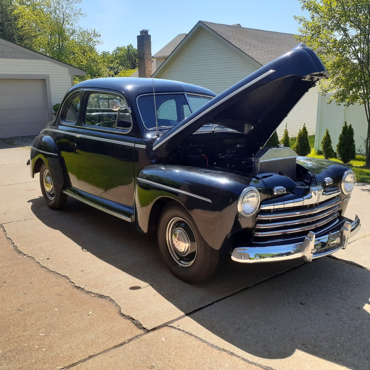

    @khead47 .....by the way....is it your Title that says your Ford is a ‘47? ‘cause everything I can see about your car’s trim and details suggests it is a 1946 model. It was common at one time to Title a car as the year in which it was sold, not the model year of it’s production. No biggie, it’s a very nice looking car no matter the the year model it is represented to be.
    Ray

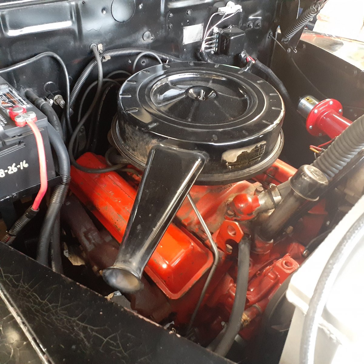

  16. Thor1
    Joined: Jun 6, 2005
    Posts: 1,683
    Thor1
    Yeah, like Ray, I don't see the problem either...your car looks like it is going downhill because it's a hot rod. Hot rods are supposed to have some rake. Ask me how I know.:cool: 20171112_135405.jpg It has a small block Chevy in it, doesn't it?

  20. Stan Back
    Joined: Mar 9, 2007
    Posts: 2,639
    Stan Back
    Look under the hood – there could be a 392" Chrysler in there.
  21. khead47
    Joined: Mar 29, 2010
    Posts: 1,789
    khead47
