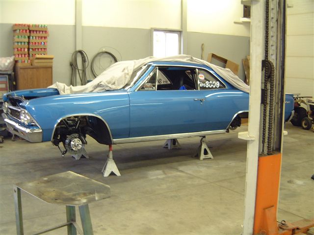

    my cousins car is a little better though,. He has a street driven 66 chevelle he built all himself that runs 7s in the 1/4 mile. he has a 622 in it. He got it when he was like 13 and has been improving it for about 15 years
  11. SAVAGE
    Joined: May 13, 2002
    Posts: 930
    SAVAGE
    Alliance Vendor
    here is another shot of it. He isn't satisfied yet he took a year off and plans to do another engine that makes about 200 more horsepower
