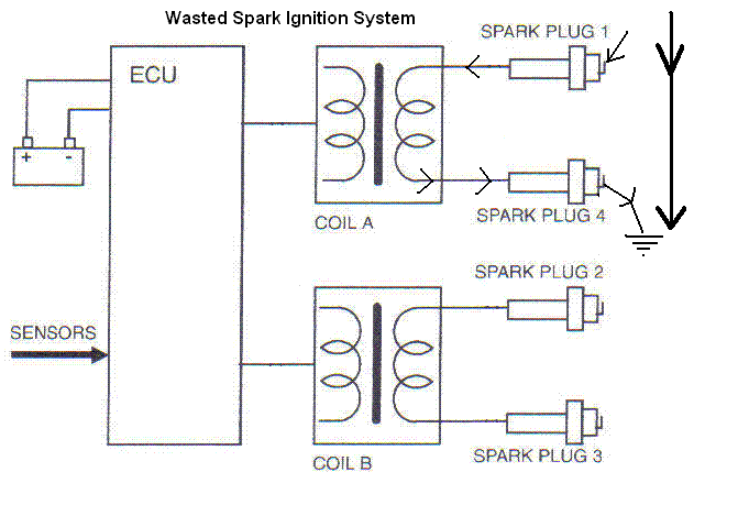

  14. Your source is correct.
    In the past, the secondary winding in the coil was grounded at one end then hooked to a spark plug at the other end. Today's wasted spark systems are basically that secondary winding with the ground wire cut, and another plug inserted in it.
    You now have a spark plug at EACH end of the secondary winding, instead of a ground at one end and a plug at the other.
    In order for the coil output to go anywhere it has to jump TWO spark gaps at the same time.
    In the "wasted spark" discussion, most of what is being said is actually true, but possibly misunderstood.
    Here is an explanation of how it works. Click on the pic to enlarge it, and follow the current path.
    The secondary side of the coil is wired slightly different from the old traditional "single-coil-wire-to-the-cap" that most of us are familiar with.
    Here the plug-coil-plug are wired in series. When the coil fires, both plugs MUST fire at the same time.
    YES, one plug has the opposite current flow from the "other" plug it is paired with.
    Notice the current path, and my crude arrows.
    Follow from the top. The current p***es from the grounded engine block, to spark plug number one ground electrode.
    Jumps across to the center electrode of plug number one. (Direction- ground to electrode)
    It travels through the coil winding, then to the other spark plug.
    At the next plug (cylinder number 4) it jumps FROM center electrode TO the ground electrode (opposite direction of plug #1), then to the engine block to complete the circuit.
    YES, one of these paired-off spark plugs has a "positive" center electrode, and one has a "negative" center electrode if you have to describe it.
    I am not aware of any that reverses polarity during running.
