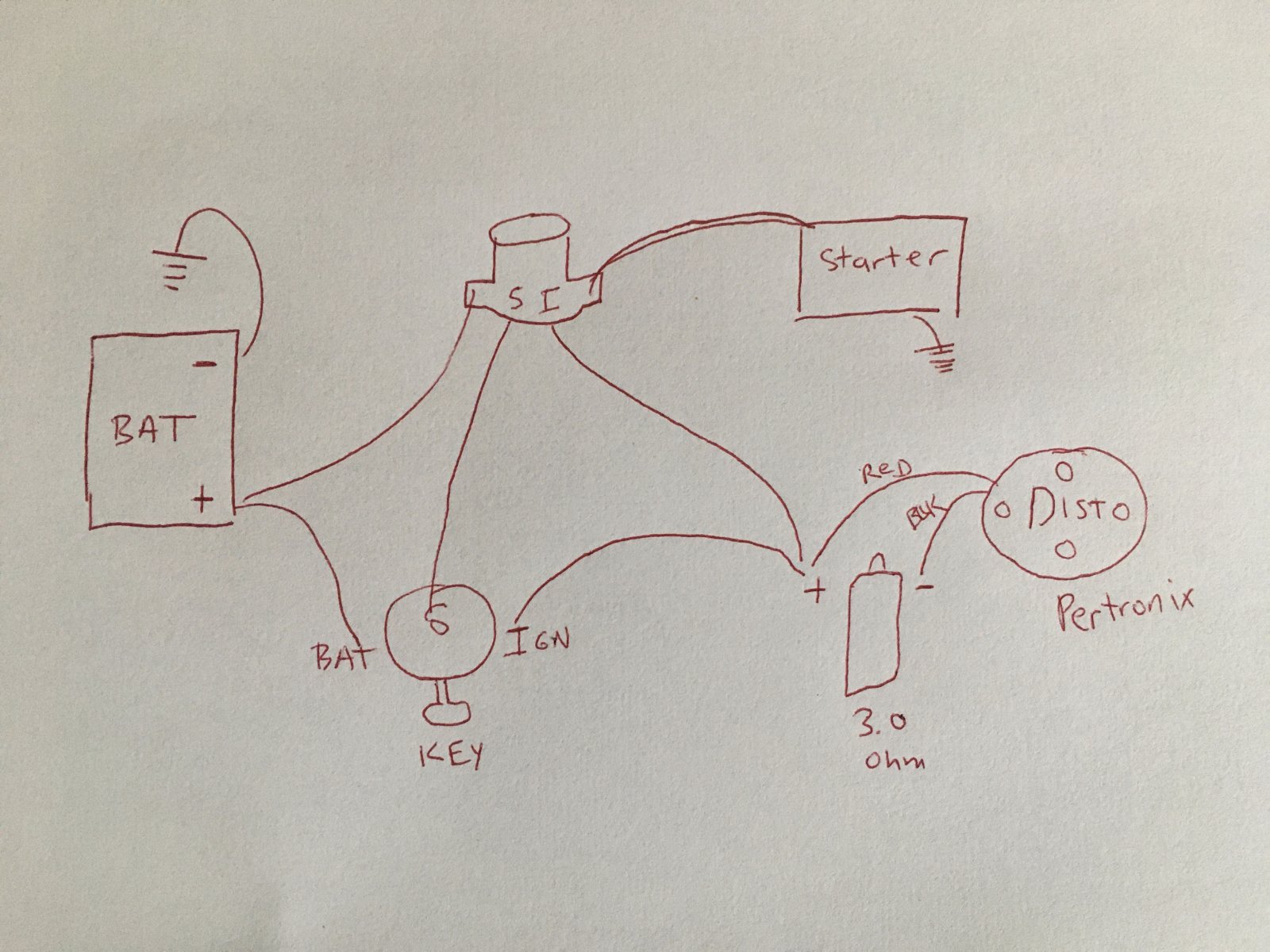

    What am I doing wrong on his old little Willy four banger? This one has me stumped.
    The key is just a new universal switch (tested and good). The distributor has a Pertronix (which is new and tested), the coil is the correct ohm rating for the application (3.0), no ballast needed with coil. I think maybe it is voltage drop at cranking, but not really sure. Battery is fully charged. Wiring is all new. I don't think I really need that jumper from the I on the solenoid, but don't think it is hurting. Help!

    The only reason I brought up by pass is because I'm unsure if OP has his terminals correct. What if he's on ACC (which is not shown) instead? Never seen a universal switch without 4 terminals.

    Thanks guys. Wondering if the problem is in the main battery wires.
    I'll ditch the I term. I didn't think I would be using it.
    Ignition switch does have ACC too. I just forgot to put that in the crude drawing. The Coil + line is coming from the IGN on the ignition switch.

    That sounds correct you have good cranking voltage and a good battery. The fact that you read zero volts on the - terminal means that the coil is being grounded by the pertronix unit.
    The only things causing a weak or no spark would be the coil itself, or a bad pertronix unit. The pertronix unit has to turn the coil primary off to get a spark in the secondary. If it doesn't do that or doesn't do that well you get a weak/no spark.

    Also, if you didn't have a good ground for the pertronix unit, the - post would read a voltage. The zero reading means that your distributor ground is good.
    Truckdoctor Andy and VANDENPLAS like this.
