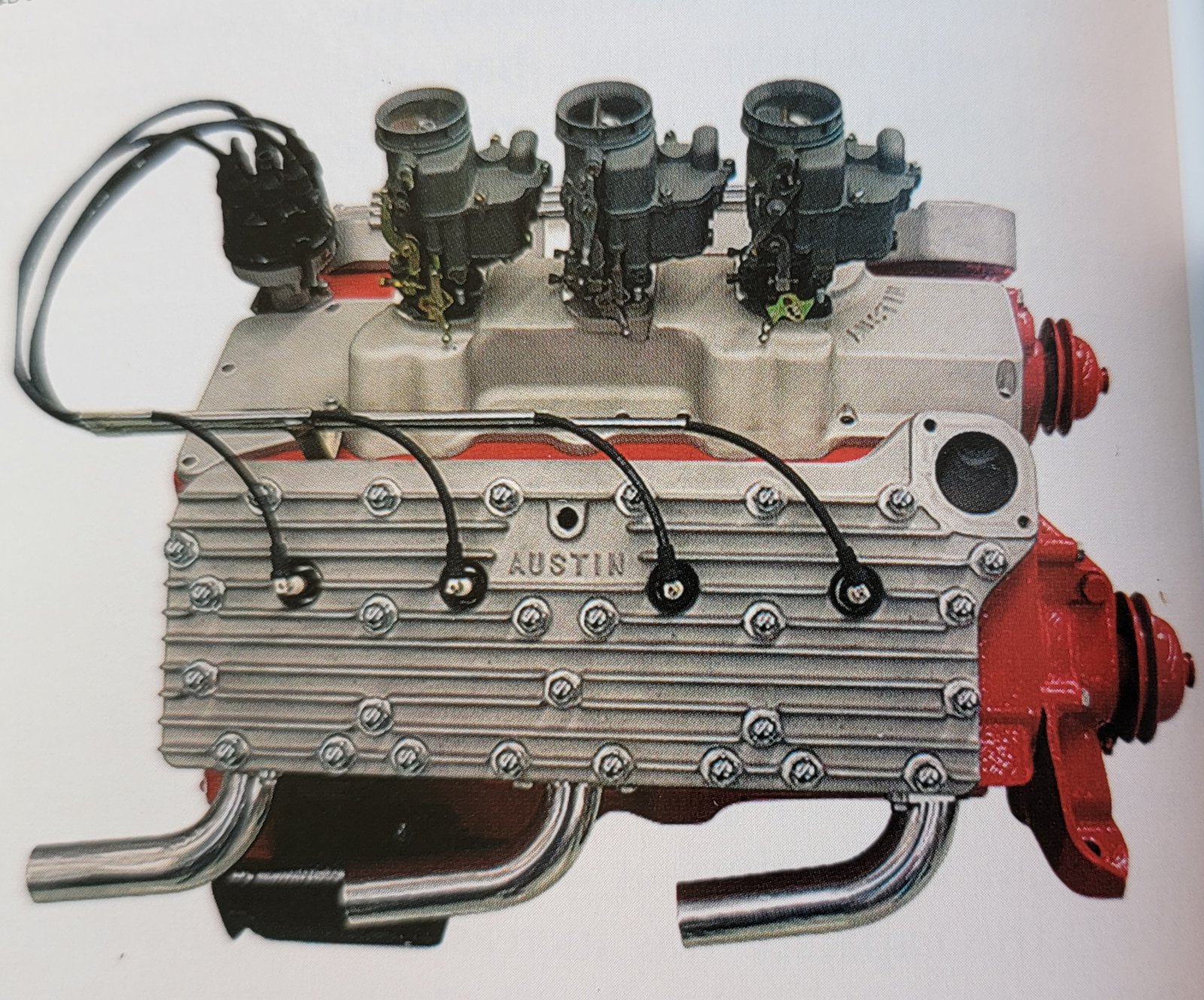

    I'm still trying to wrap my head around why so few use 337 flatheads in hot rods? Theyre torquey at 275 ft lbs. I have heard lots of whining about weight but seriously...850 lbs once you put aluminum heads and intake on isnt 850 lbs anymore. Furthermore, I dont ever hear any complaints about guys running ardun conversions which jack the weight of a flathead north of 800 lbs. Or little hemis north of 700 lbs. The 337 produces about 154 hp from the factory but a multi carb intake racks that number up a bit, a little bore increase can as well and if you run a small supercharger they really come alive. They can be had cheap, theyre cool lookin, sure they came at the end of the flathead era but a 303 rocket in 1949 only made 135 hp. Just my thoughts on it. Im running one in my roadster. I know some will say they arent popular because guys didnt run em but Ive seen pics of em in early fords. Same argument about guys not running spring ahead front axles....Ever since I first heard guys didn't run em I just see more and more old b/w pics of rods with em... 20230210_161646.jpg

    Yeah theres a source for aluminum 2x2, 3x2, 4 barrel and blower intakes as well as heads. Weight of an ardun is also googlable but the heads are similar to hemi heads (120-150 ea) id be willing to bet its south of 800 with a head and intake swap. That coupled with a battery in the rear and I doubt its all that bad, I am running 39 front spring pack on my a frame though so its a beefier pack

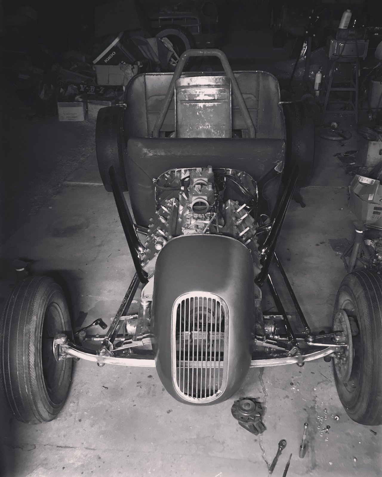

    Thanks! I built it about 20 years ago . It’s now going to be a landspeed car and I will run a 337 in it!

  20. I think that @Austin kays is putting a 337 in his '27 coupe. A fire truck motor that is basically a Lincoln motor (unless I am seriously mistaken). Block relieved from the factory etc. He came up with aluminum heads and a twin carb intake.
    I am not sure that he is ready to announce it yet. But maybe he'll chime in.

    Get good Ross pistons, block off the oil plunger feed circuit, lap the new oil pump gears on a piece of gl*** and make sure they are perfectly flat they pump better. Run a 12 inch press plate/clutch. You will kill a stock clutch if you race it. Keep the iron heads (Winfield taught us that trick) get a Mallory dual point ignition. Big radiator or water tank.
